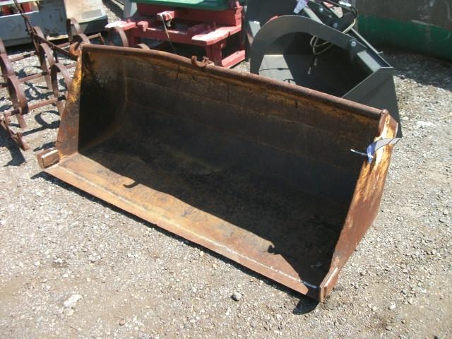

One more question ..... What would be a fair ballpark price for a used bucket?
   / Does anyone use an extra bucket? #14
Check out what a new bucket would be and go down from there. :laughing: Seriously, I just saw a used 66" bucket (not sure what it fit) go for $150 at an online auction (see attached). I spent $100 for a used 12" backhoe bucket for my Ford TLB that would have cost $600 new. A lot will depend on condition and how proud the seller is of it ;) . I've seen prices on used equipment that I just shake my head at.

   / Does anyone use an extra bucket? #15
I've heard of people who drill the holes to hold the tooth bar in place such that they can loosen the bolts, pull the tooth bar forward past the lip and flip it inside the bucket. Way less expensive then a second bucket.
