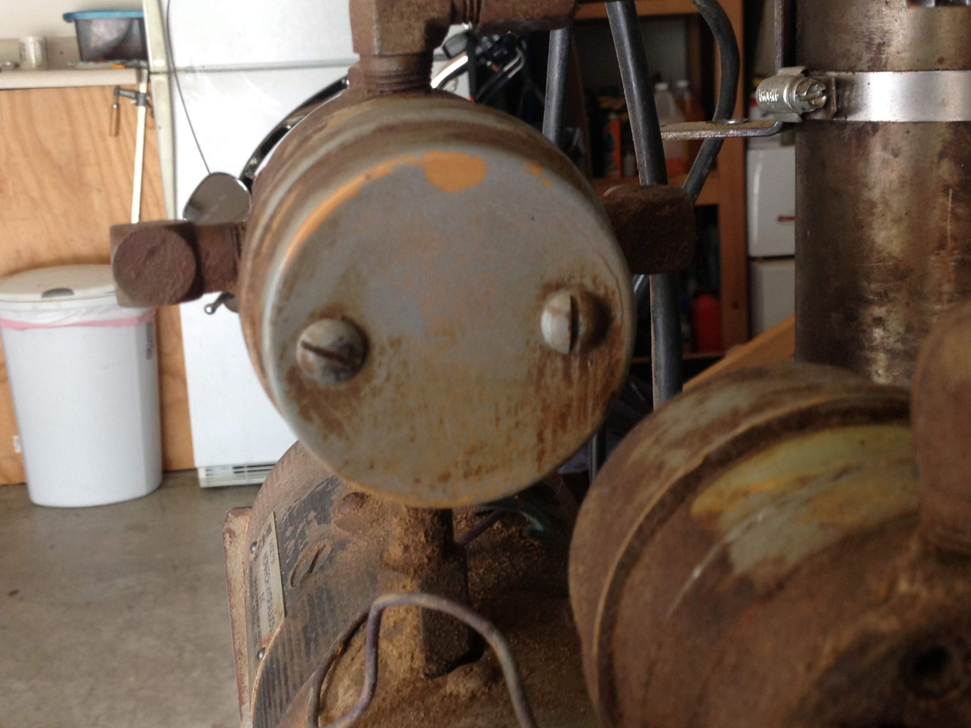

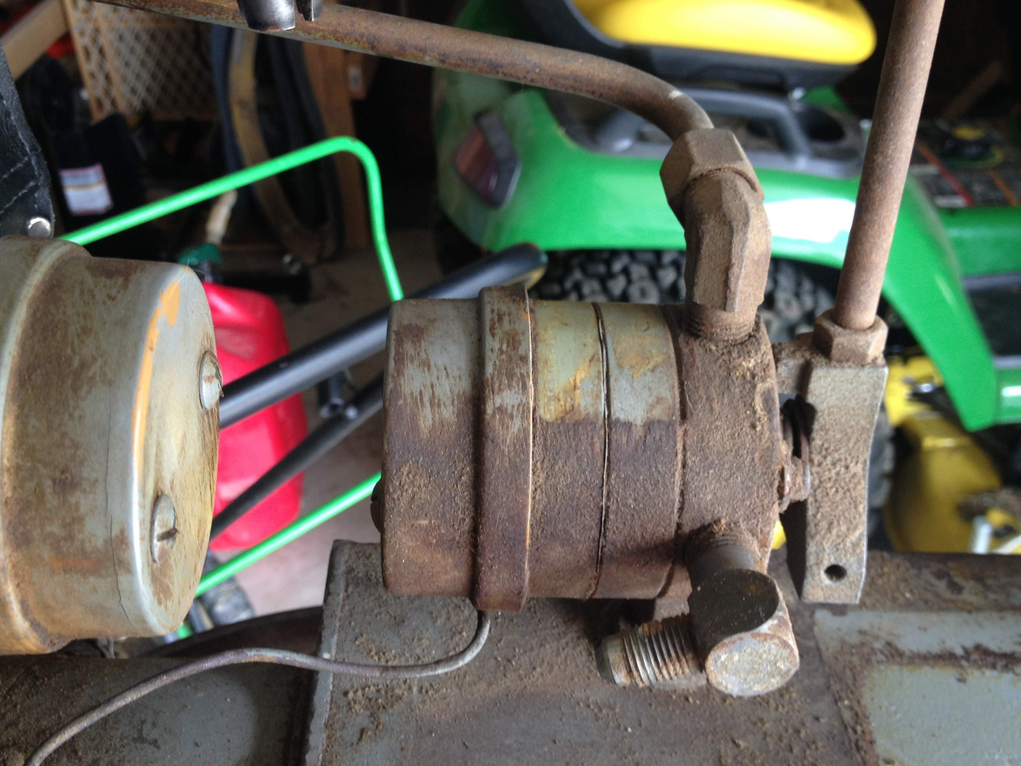

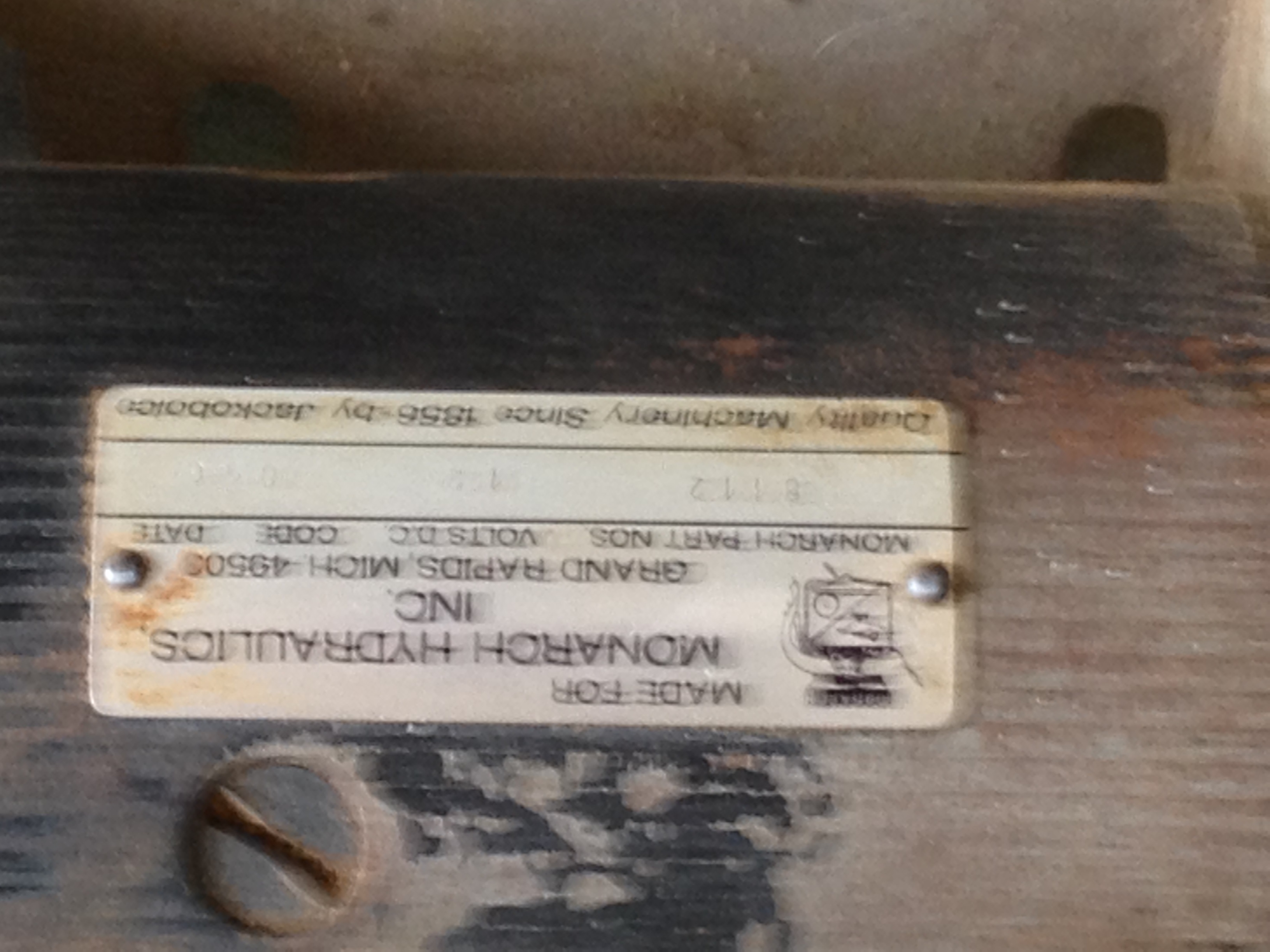

Does anyone know what these valves are?
   / Does anyone know what these valves are? #1
Steve OO
Jul 20, 2013
2
Hillsboro , mo
None
It's Monarch Hydraulics 12volt pump with 2 directional manually operated valves. Thanks for any information Steve
   / Does anyone know what these valves are? #2
Those are old 12vdc pumps made for plow units
The rotary valves have small microswitches under the plastic cover to activate the solenoid to turn the pump motor on mometarily when lever is activated
One valve is 4-way for the power angle cyls .........and the other (with one single port) is 3-way for raising and lowering a single acting lift piston
Thanks I was hoping that is what it was now I can start making a snow plow
   / Does anyone know what these valves are? #4
IIRC the switch on the valve is wired to the solenoid to the ground side......the positive side of the solenoid is hard wired to the battery
then the valve switch just completes the ground to turn on the solenoid
   / Does anyone know what these valves are? #5
Does one valve have one port .....and the other two..??
