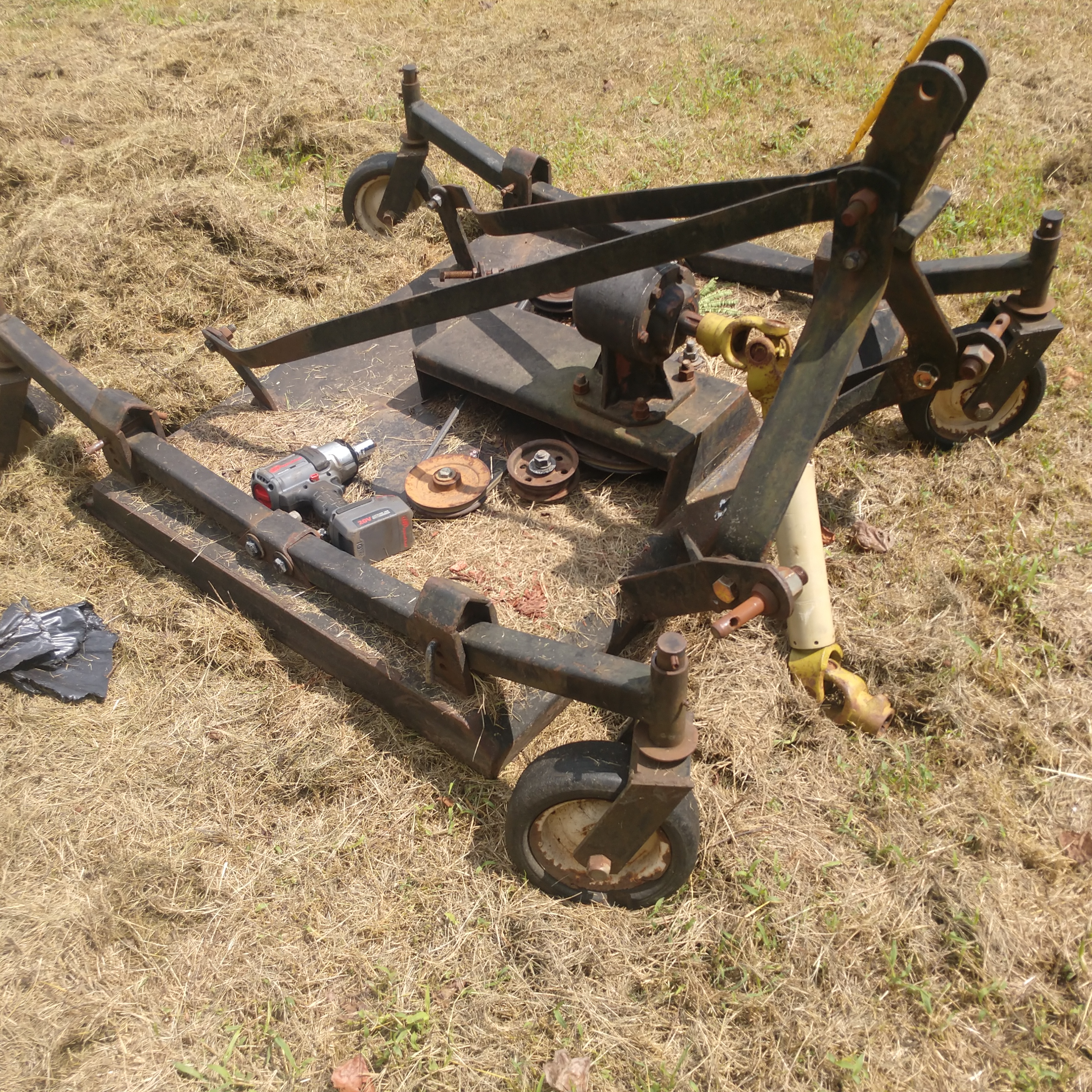

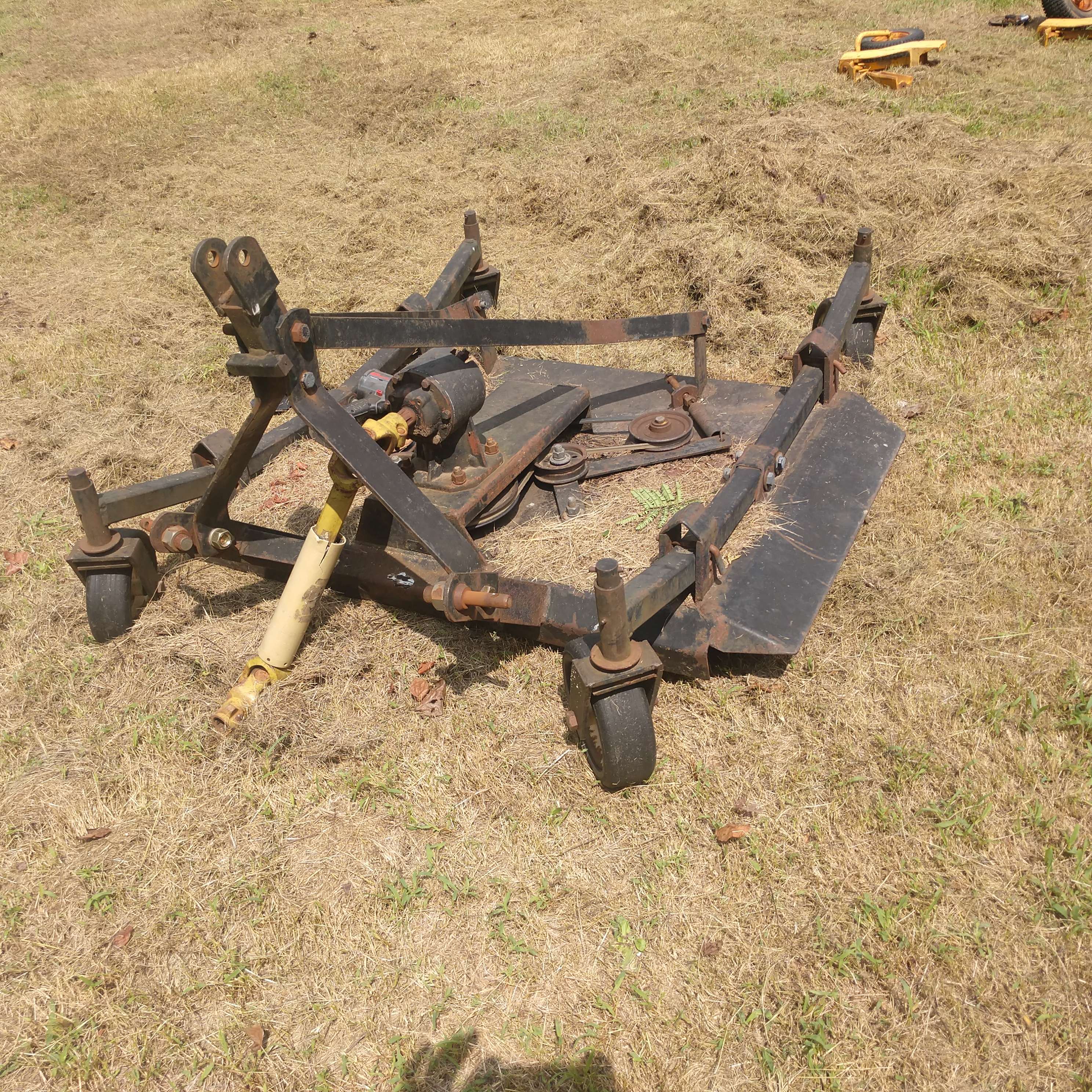

So I tried to take the blades off not knowing they were right hand thread. I broke BOTH can anyone Id this FInish mower? Thissunhere. IMG_20200815_124231581.jpgIMG_20200815_124225698.jpg

Don't know but it your going to match it on computor images don't go by the color black .I have seen Northtrac/Yammar/ Titan/Woods/ finish mowers that came in black . Of course some of them didnt make them but just sold them with there logo .

That helped a lot but still havent found it. I will upload the cover for the shape
   / Does anyone know the brand of this finish mower? #4
Why do you need to know the manufacturer?
The spindles are generic, County Line/King Kutter {TSC junk but serviceable}
Just drill out the broken spindle bolts {Bearings too, if needed} or replace the entire spindle assembly.
If the gear box is grumbling, replace it, as well.

I wish it was as simple as going down to buy a spindle (there are no spindles at my tsc not 1 i can go hold in hand before buying a ton online though) but as you may know there are some 20-50 spindle sizes out there... the shaft on one is sloppy with the pulley fit. on top and its making a ton of heat so i need a shaft.
I want to know the brand so i can buy a spindle that will fit or order a shaft that will fit or fit correct pulley on top. I will take it off today post come more pix perhaps they are simple generic spindles i can easily match.

Also I meant I broke the blade bolt not the mounting bolts . Thanks everyone for your replies so far. I BORROWED THIS FROM NEXT NEXT NEXT DOOR NEIGHBOR is the worst part

You mentioned removing the spindle and taking pictures but I don't see any of those. As already stated, there is zero need to ID the finish mower. Take the spindle off, measure appropriately, and buy a replacement. Not to be rude, but if you had done this a month ago when it was first suggested, this would have been over and done with long ago.
   / Does anyone know the brand of this finish mower? #9
Absolutely! Buy a replacement shoulder bolt from a farm/landscape supplier. Get the numbers off the bearings for replacements and rebuild the entire spindle back BETTER than when you got it.
I’ve rebuild a few of mine, over the years pre-lubed to airline spec grease, and SS covers. They’ll never wear out with homeowner use.
