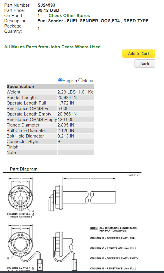

   / Does anyone know how the fuel sending unit works? #19
Shown below are the spec's for the fuel sender that hosspuller listed part #. Spec's shows full & empty ohm's

Folks ... I have miss-lead you. I wrote "reed switch" Deere only says "reed" Could have a very different meaning and operation.
Super55 ... please post what you find of the innards of such a level sensor.
