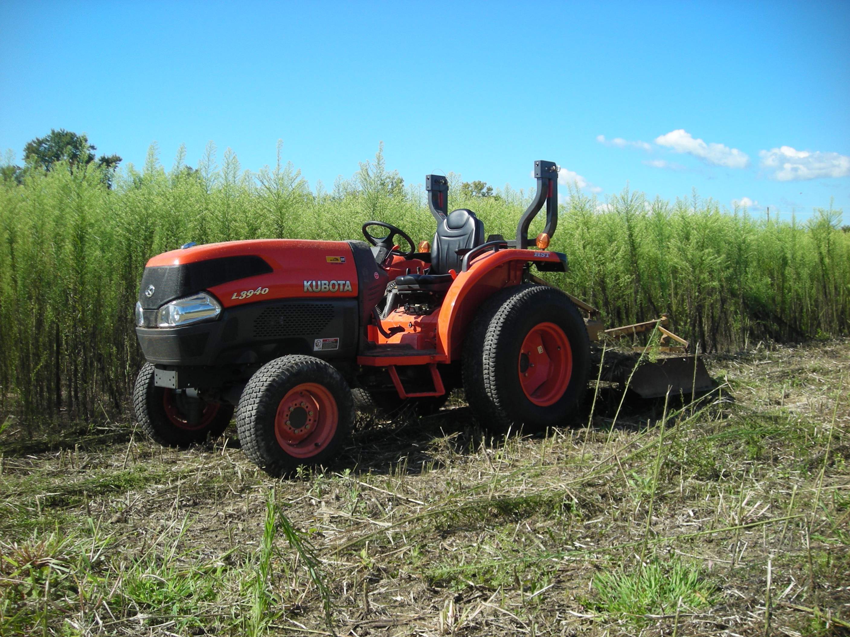

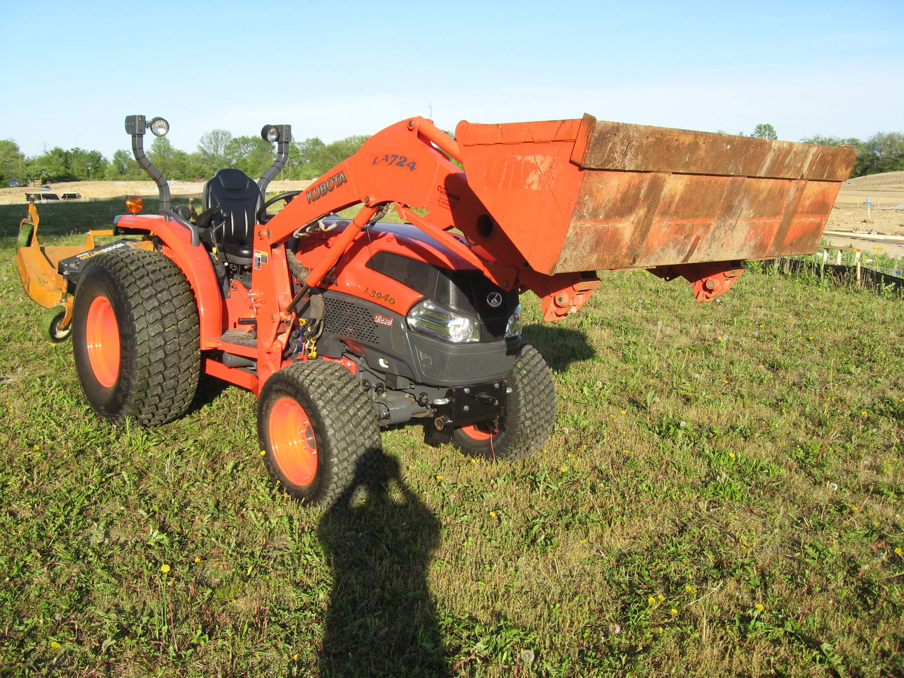

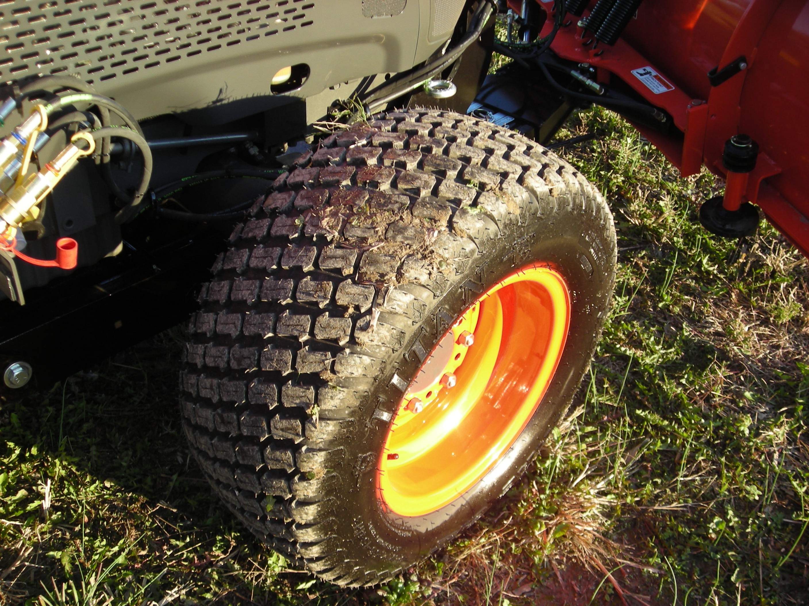

Be careful, there are 3 types of turf tires available. One set is what I have, deep lugs, lots of corners to bite, and plenty of siping. One set is galaxy, the real wide ones used on golf courses for mowing. One set I really don't like, shown in last pic with bush hog, these came on my new tractor as loaners until my turfs came in. The tires that beppinton has shown I have never seen on a US spec Kuboa. Interesting? Philip.

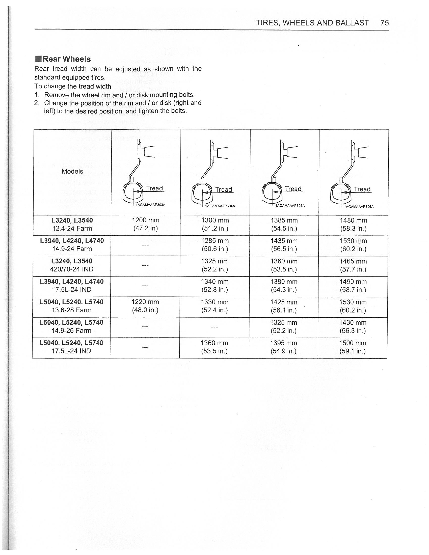

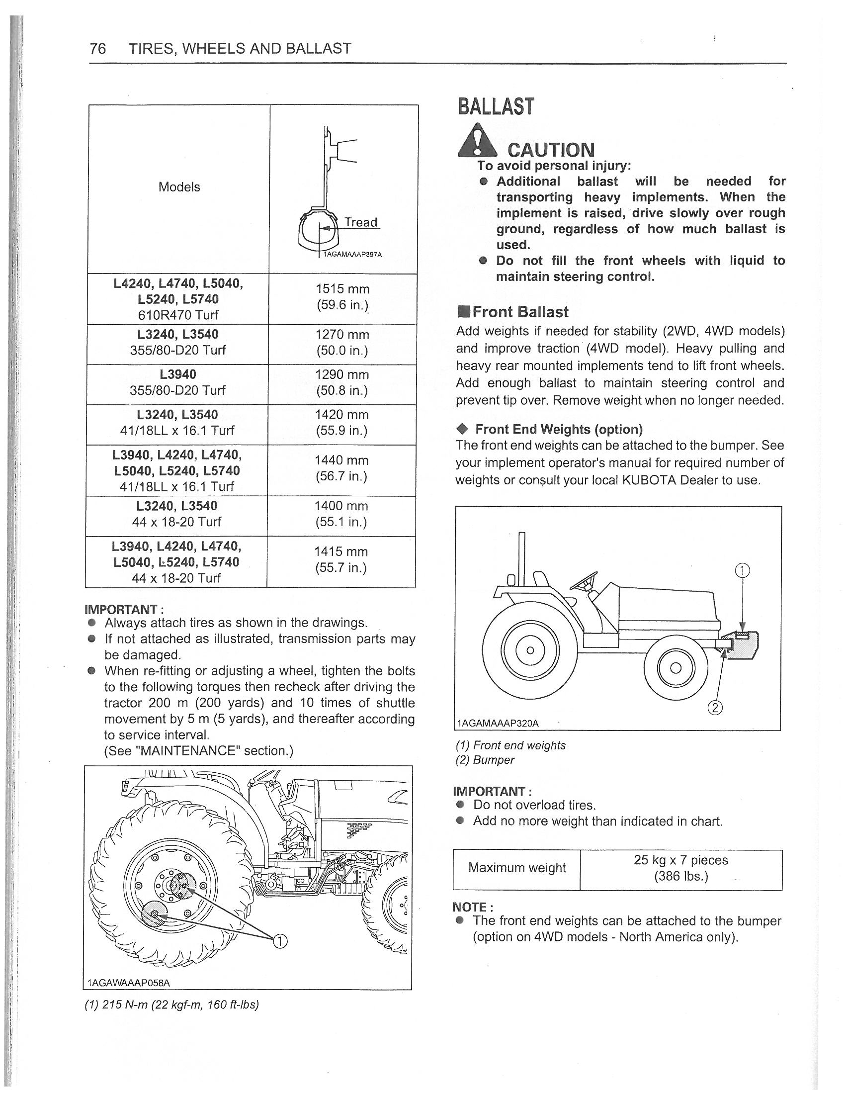

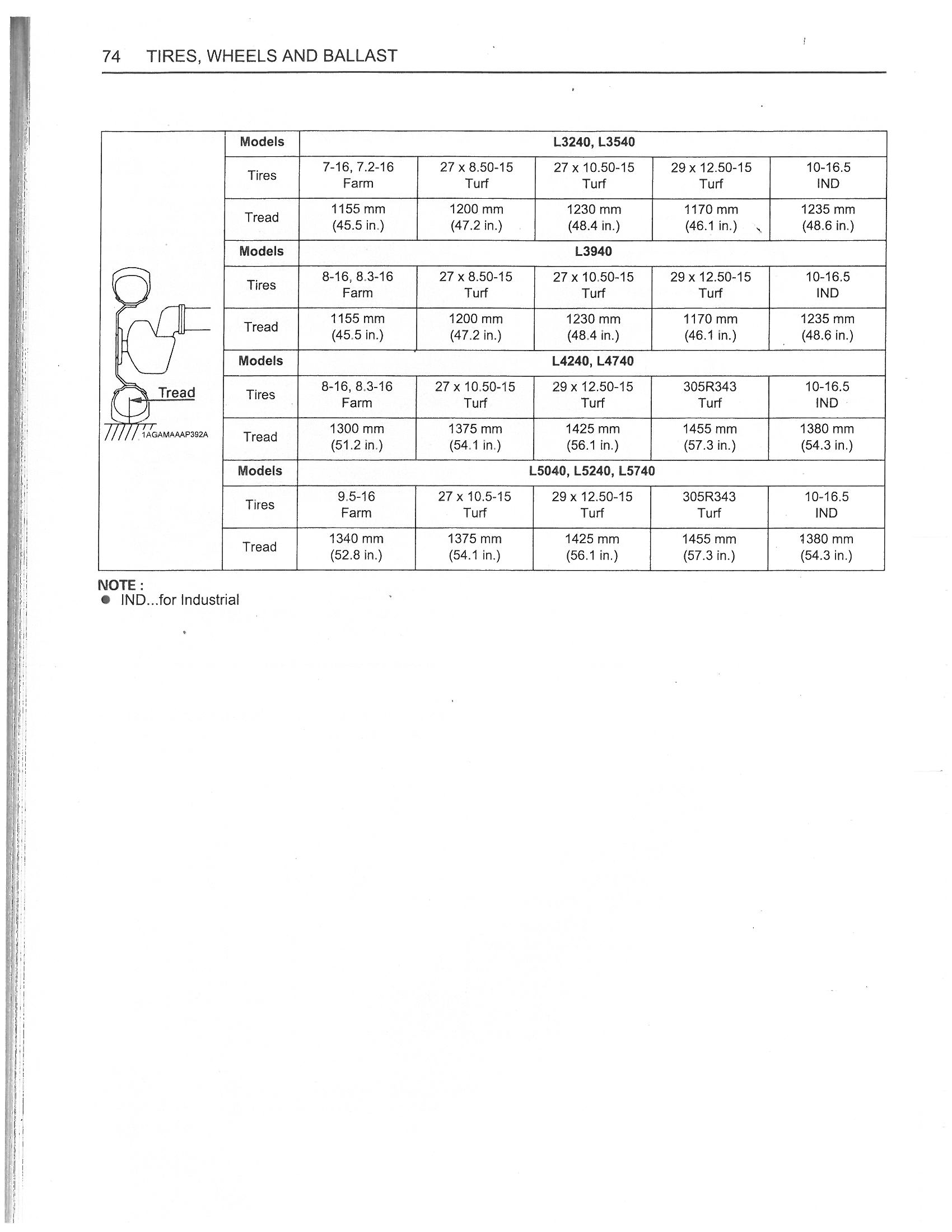

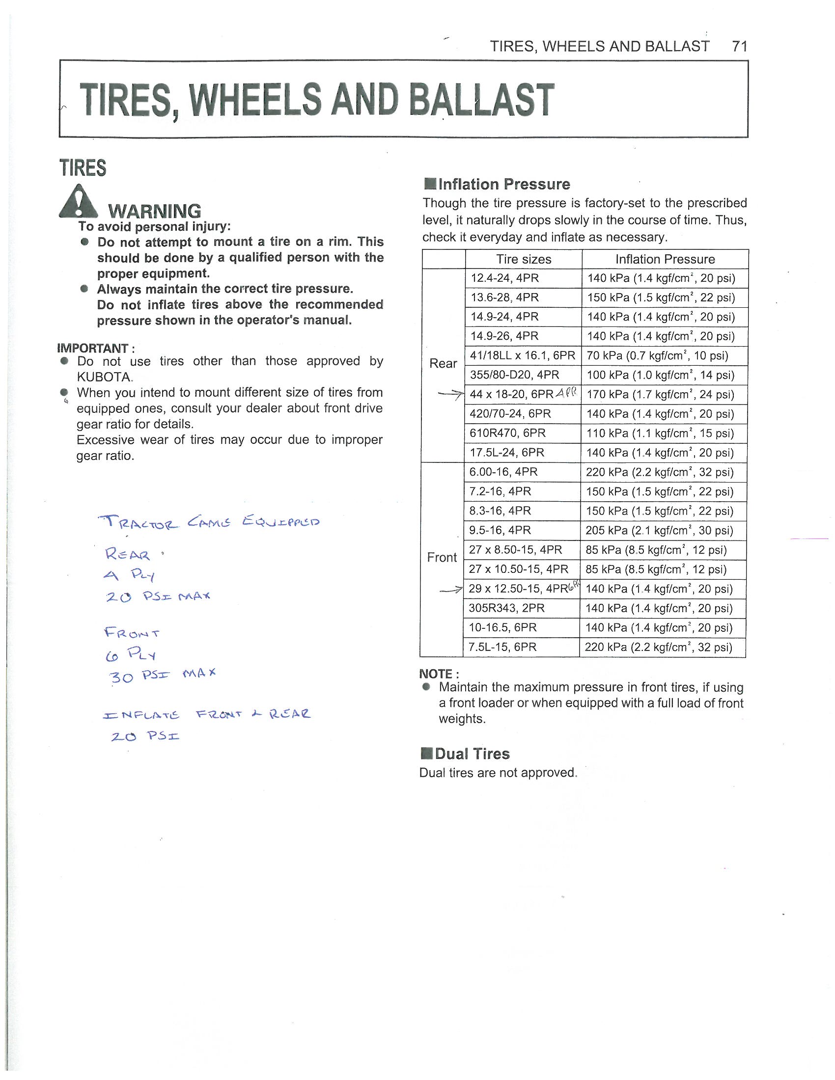

Here are tires specifications out of manual. Shows all 5 types available and size for L5740. Philip.

It seems the titan tire is the same size for all grand l models,(rears at least) they do look pretty large on my 3540... But thats a good thing!
