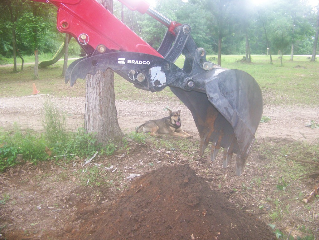

Does a thumb get in the way when digging? :confused: That all depends on what brand backhoe you have. I have a mechanical thumb on my Bradco 511 that is either in the stowed position where it doesn't interfer while digging or in the deployed position for picking objects. The thumbs teeth only mesh with my 24 inch bucket. It will not mesh with the teeth on my 12 inch bucket. It pivots on the same pin as the bucket does. I am in the process of ordering a hyd kit :cool: for it, as it is a major pain to manually position the thumb, especially while playing in the mud. The attached photo shows my thumb in it's stowed position. It is way heavier than it looks. :D
hugs, Brandi
hugs, Brandi

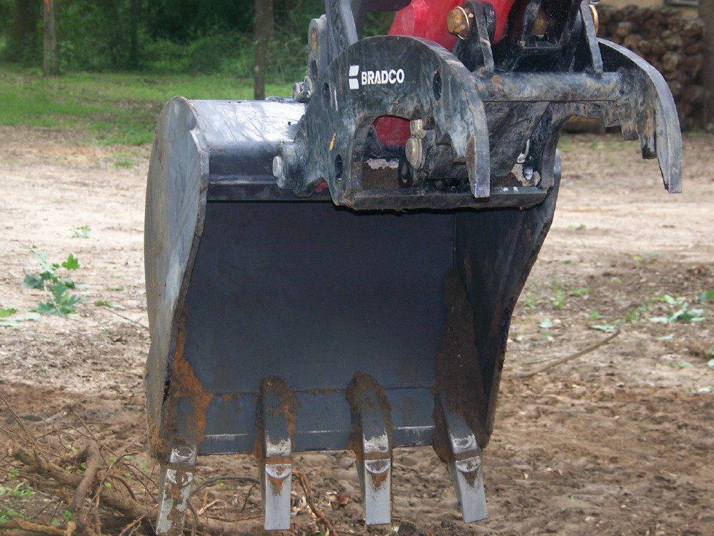

Here is a photo of my Bradco 511 BH with the thumb deployed.
hugs, Brandi
   / Does a thumb get in the way when digging with a BH? #16
Here is a better photo of the thumb stowed.
hugs, Brandi

That is a great looking thumb. With it pivoting where the bucket does, it could easily be modified to become an articulating mechanical thumb....without the need for the hydraulics.

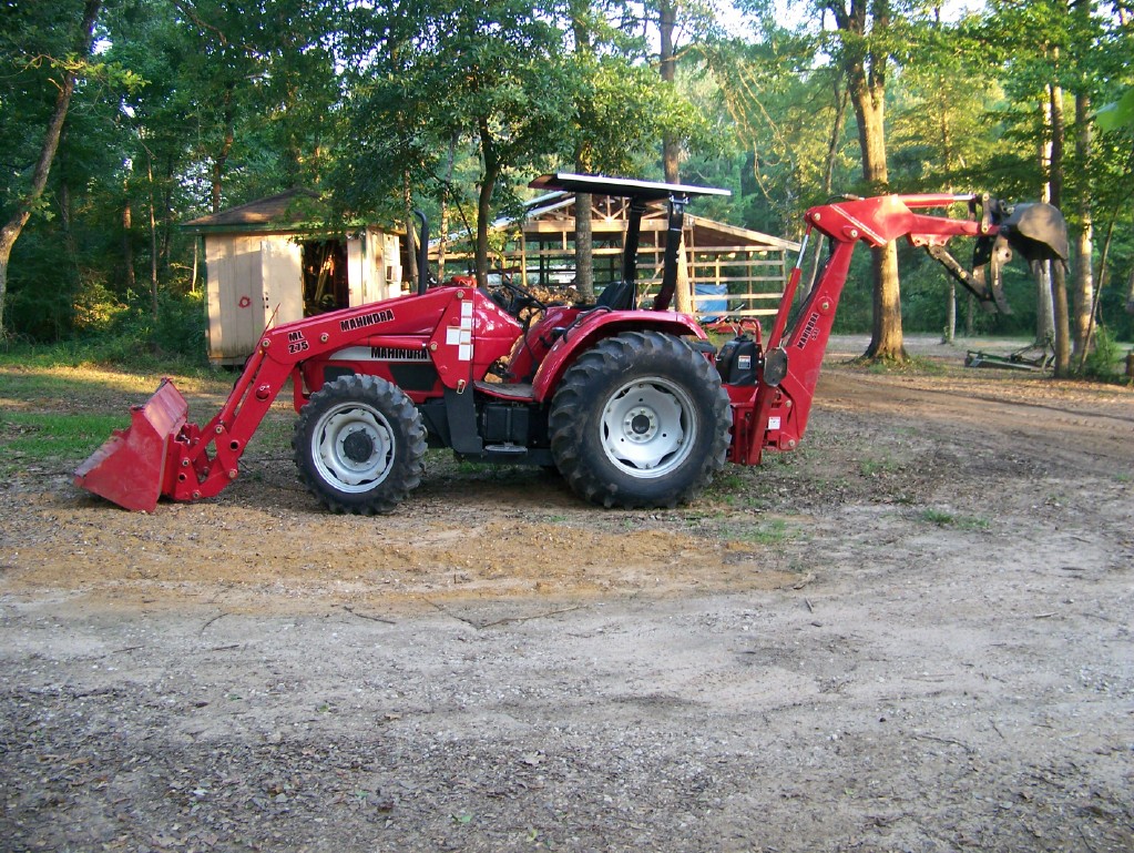

For comparison, a Rankin UAT-50 on my Bradco 3265.
