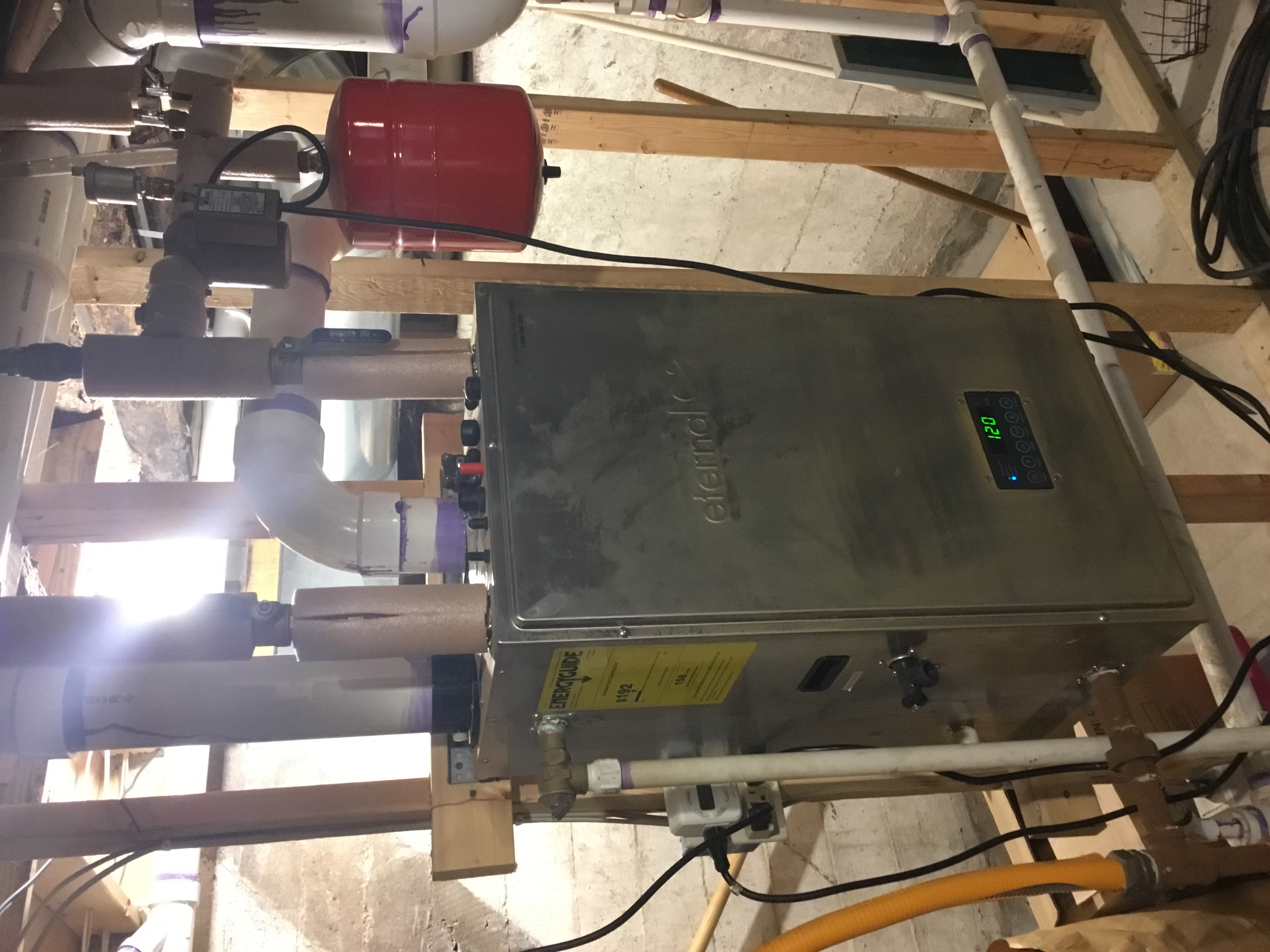

First of all,; my qualifications. I知 on a well and I have a tankless water heater with a circ pump. Mine is a simplex unit. The statement that grind water is colder in winter is untrue. It痴 actually a constant temperature all year. The ground is a large heat sink and seasonal changes don稚 impact the temperature. In Wisconsin we use 55 degrees as a design temperature for ground water. This would be the base point for the temperature rise. Now determine what you want for gpm and you can look at the heater charts to determine if two units are necessary. Personally, I壇 pick a single unit unless you can稚 get the desired temperature rise out of a single unit. My unit is 200k btu input so it痴 a larger one. I believe there are now larger units on the market. I致e never run out of water, but when running hot water through the pressure washer I e noticed it痴 delivering 120 degrees instead of the set 140.
My unit has a small 3 gallon tank inside of it which I highly recommend because it eliminates the cold water sandwich. You are correct in that not all units are rated for a circ pump. The units turn on based on a flow sensor and the pump will fool the unit into continuously running. A circ pump compatible unit will base the need to burn on temperature instead.
Do I like my circ pump? No, I LOVE it! This is the third home I致e had a pump on and it痴 the only way I値l go. You turn the water on and 1 second later it痴 hot. No more waiting 5 minutes and running multiple faucets to purge cold water. Energy efficiency aside, the convience is worth it. To help save some money, I put my pump on a timer. It痴 an electronic 7 day type and I programmed it so the pump does not run when we?*e not home.
If you do choose to go with twin pumps, then make sure they communicate with each other so the units will alternate. This will keep the wear even between them. Also, a water softener is mandatory as hard water will kill these heaters. Other things that your plumber will need to add are some balancing valves if you have multiple loops, some check valves and an expansion tank. You値l want the soft close check valves because I do hear my valve clicking when the washing machine fills. The expansion tank is a hard learned lesson because you will get weeping from the t&p valve if you don稚 allow for 5hermal expansion.
Yes, the loop and return lines must be insulated. There is a section in the IRC that requires it.
Would I do this again? In a heartbeat. One of the best home decisions I致e made.

Thank you for commenting. Much to learn here. Now I need to shop for a water softener as well!! Our water does have some hardness to it.
