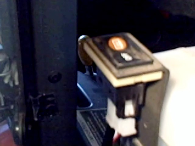

I've got a B3030 with a winter cab that is the Real McCoy. Attached are pics of the rear-window defrost button and pic showing wires in glass. The defrost button is mounted by the window wash fluid reservoir. And yes, it does have a rear wiper. Sounds to me like someone is tryin to do the Okie Dokie on you.

AStanton,
Actually, I believe the salesperson I'm dealing with does not know, himself, that he does NOT have a B3030HSDCC. But as you allude to, one never knows--perhaps he's just putting on a "Columbo Act" and hoping I'll bite--however, the fact that he refused, three times, last week, to take a deposit, saying he'd hold it merely on a "gentleman's agreement, " until I could come see it, seems like he's honest, but just as confused as I was. Either way, I am glad that you guys saved me a 4 hour drive (round trip) for nothing!
Your tractor looks super-clean, btw!

The two real differences that give away whether you are looking at a B3030 HSDCC instead of a B3030 HSDC are the rear window defogger, and the 60 amp alternator instead of the 40. All other options were available on the HSDC.
