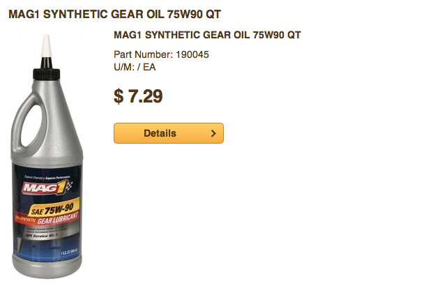

Here's the deal, at least it was for me. At my local WalMart and at my local generic, rural life, farm store, one can find quarts (not buckets) of gear lube. The price of the regular and synthetic was/is just about the same, in house brand. $6 versus $7. During sales promotions, even a buck less per quart. This showed me two things.
1. House brands (typically packed by Warren Oil or other reputable supplier) are minus the branding factor and are very reasonable and meet great specs, just like the big, bad brand name products.
2. Given how little either them costs? Gear lube was going in my front axle. I'm sure Olive Oil would provide a lot of lubrication, but for me, based on my dealers proven results, gear lube in my Kubota front axle. It's an axle. For sure.
