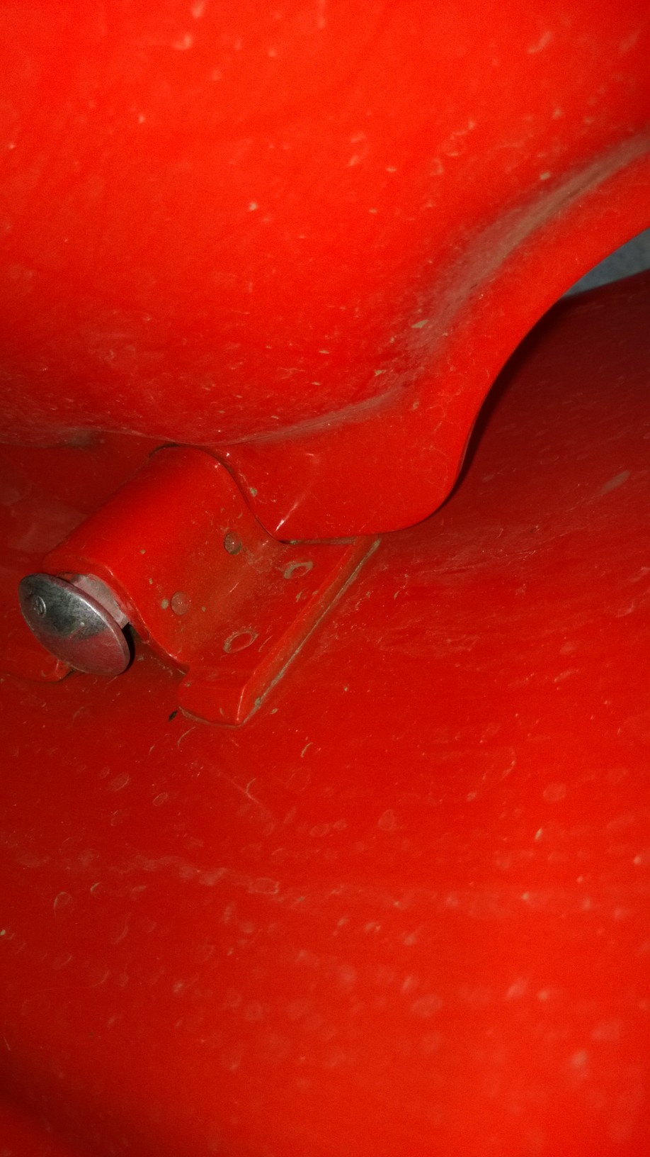

After trying to figure out out to get that dip stick out, i found out it was very low! So i filled it up and also going to change it and put the synthetic in- Bx2660. Wish i saw this post 50 hrs ago! Would have thought that Messics would have checked that when they did the 50 hr service!

For me, getting that axle dip stick out works best by using two, broad blade screw drivers....one on each side of the stick. Prying straight up brings it out without any damage or cussing. Darn...I like to cuss.:laughing:
