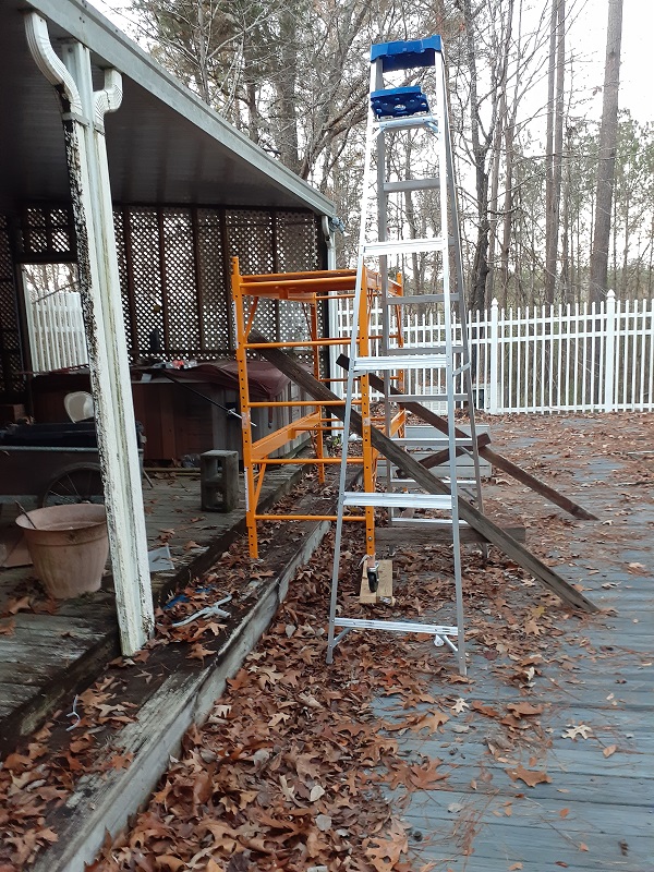

Well I completed my first project with it - removing about 5 years of "leaf" buildup on a standing seam patio roof that is connected to my house.
The procedure I eventually settled on was taping together Aluminum Swimming Pool Telescopic Poles (I had laying around) with a hoe on one end so I could span the 20' plus roof. Then while standing on the scaffold, slide the extended hoe up on a standing seam, flip it over to bite in, drag a pile of leaves down, repeat until I got a build up I could scoop off the roof into a bucket, then dump off the pool patio.
Due to leaning over etc needed I wanted extra stability. So I added two outriggers consisting of 2 pieces of scrap 2x4 and a few bolts.
I worked with the scaffold at it's next to last hole high and it was very stable.
I'd strongly advise to add outriggers, they make it really stable and for the cost of a few bolts and scrap wood are priceless.
And plan to use a ladder for access.
   / Do you need a small scaffold? Look at TSC - 6'x6'x29inches - $130 #18
^^ I got two sets and have set them up side by side for extra width and stability. Also lets me use one at a lower height to get on first, them step up to the other higher one. I don't have the optional outriggers, but in every use so far, I've been able the uprights to tie-off to something solid.
