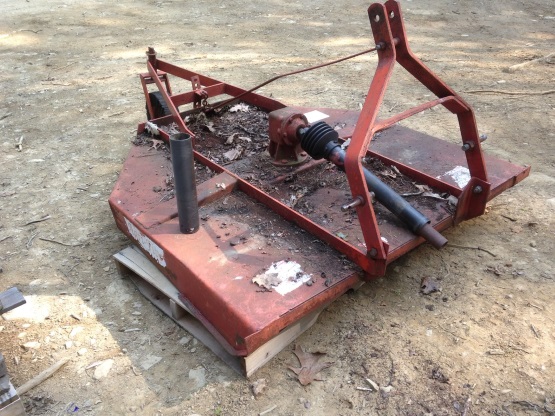

Do you know who makes this?
/ Do you know who makes this? #21
I have seen several brush hogs with a chain welded to that strap.
Big Bee makes some of theirs that way.

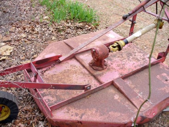

I had a Huskee that looked a lot like these, but it had no diagonal chain or any facility to attach one. It was a great mower if only we could have kept the gear box anchored to the mower deck.

That's actually a Lowery 'Andy 500' cutter made by Lowery Mfg in Boaz,AL. I'm up in Guntersville and have one just like it. You can get any replacement parts that you need from Lowery. I got a stumpjumper with blades and shaft nut for mine for a little over $100 a few years ago.

The strap and chain looks like it is a bit low rent, but it works great.

Thanks for the info. i have a lowery 6' boxblade and that is one heavy attachment.
/ Do you know who makes this? #29
Looks like a 5' Howse! I have one sitting in the bone yard I no longer use.
/ Do you know who makes this? #30
I don't think it is a Howse. Most of them have slot rather than a hole on the top of the A frame to let the machine swivel so it would not need the strap/chain setup.

It does have the chain attached to the strap.

An update on the mower. I hooked it up to the Kubota and gave it a whirl in the big field. had to stop and adjust height several times. Blades are pretty worn so they need to be replaced. I did pump some grease in the gear box. Cut pretty good, I was pleased so far. As I was finishing up, it started vibrating some. I kept an eye on it. When I finished and went back to the barn, I was looking it over real good and notice that one of the gear box bolts was laying on the deck. I then noticed that another bolt had disappeared. The bolts looked pretty new that attacked the box. There is only two bolts holding it down right now....guess I get to take the stump jumper off and replace bolts and use a lock washer which they probably did not use so they got loose and came off. I'll also use some red loktite to make sure that they stay put. There is a small crack that runs from the deck to where the gear box mounts. I may get someone to stick weld that while I have it apart. I will also replace the gear box seal on the bottom so I can refill with oil. Or at least add some oil to the grease in there now. I hate it when someone did not use the correct lock washers to hold something down that is hard to get at for a fix. I would never do that even if I were going to sell it. Do it right and someone will appreciate it. :thumbsup:
I have a mig welder with gas, but I'm not sure it is powerful enough to weld up the crack. Think it would work on a mower deck like this?

I'm sure you could weld it up with the mig. Decks probably only 10ga or maybe a little heavier. What welder do you have?

It's an older sears craftsman model so could be anyone's brand. It's a 115V so it is slow.
/ Do you know who makes this? #35
The deck is pretty thin. I can't imagine anything that's labeled as a welder couldn't handle it.

I had a small Lincoln flux core wire welder that wouldn't do it. Thin sheet metal gave it a fit.
