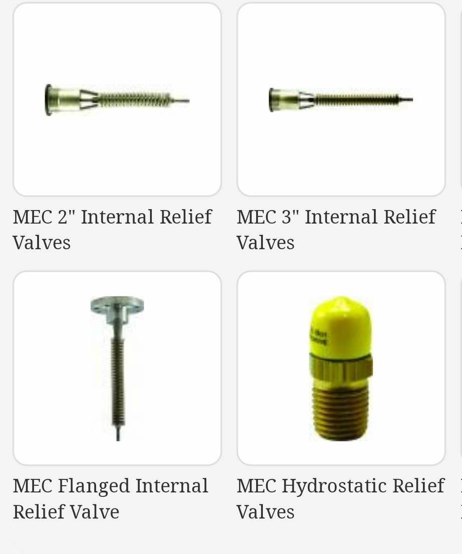

The MEC is a small hydraulic relief valve. Its part of the MLS.
Not all tractor manufacturers use them, and those that do use them, may not use MEC valves in all their tractor models. If one of these failed, it should be quite simple to replace....unless it was stripped by over tightening.
Also, here is a link to a previous thread. Same problem your having Erik. Posts #1 to #16 deal with your specific problem.
https://www.tractorbynet.com/forums/bobcat-tractors/277308-another-winter-more-mls-valve.html
That thread sure sounds like the current problem. I saw in this video Kioti CK2S Tractor MLS Valve Adjustment on 3 PT Hitch - YouTube that there is an adjustment to fix the bouncing, which was the original problem. Makes you wonder if the dealer found the messed up threads or caused them while trying to make the adjustment shown in the video. In either case, while replacing parts, they could have jarred a spec of dirt of Loctite loose and plugged that tiny hole mentioned in your posted thread (causing the current overall failure).
Ford850...you caught that critical piece of information. Apparently a small pinhole blockage in the MLS can cause a complete failure of the 3pt hydraulic arms. Its almost like Chaos Theory at work.
