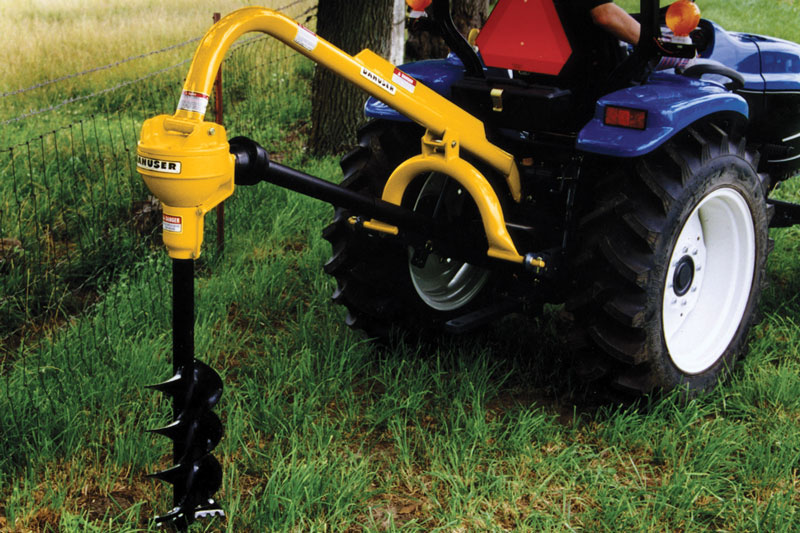

Could it be a Danuser?

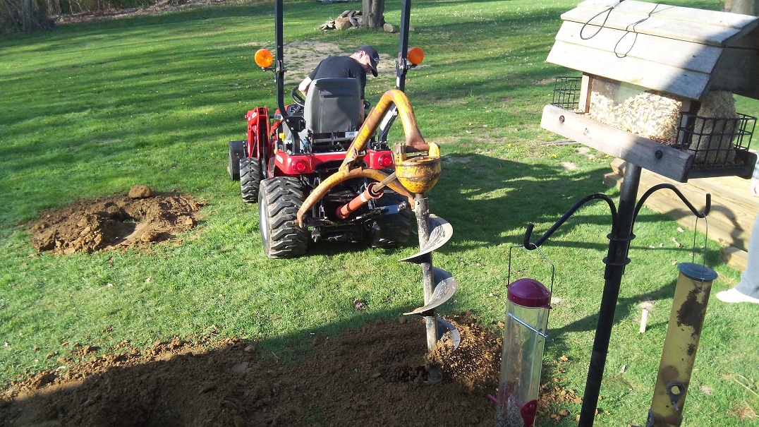

Here's a pic of mine (Shaver). It's at least 20 years old and still going strong.
