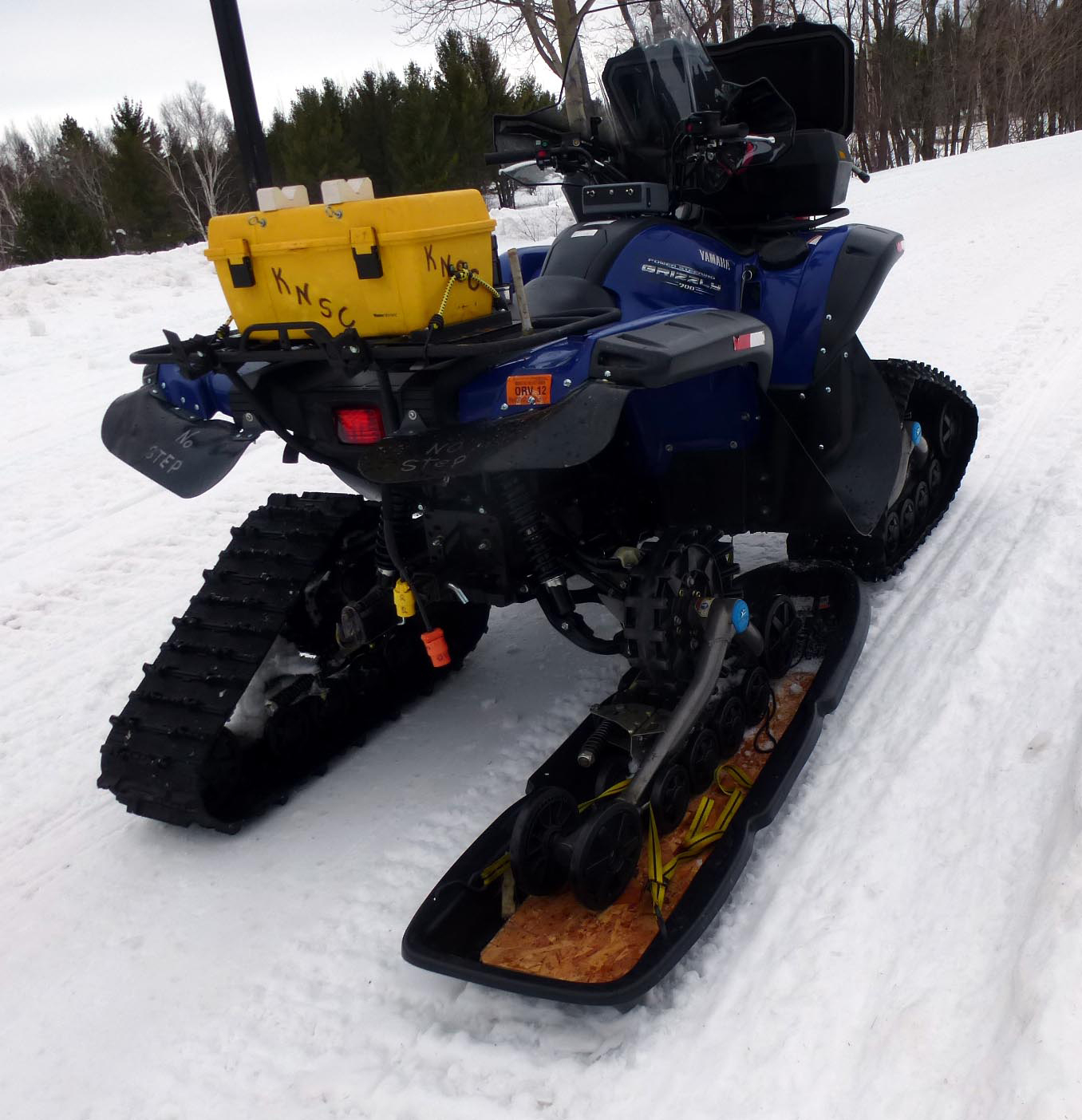

A division of Camso is pods for atv's but I know them make them for AG tractors and many, many other machines. We used them on 2 machines for a few years. In the 6 years these were used, we far exceeded there original cost in repairs. Now I recommend and use Soucy built ones.. YRMV! 🤣
