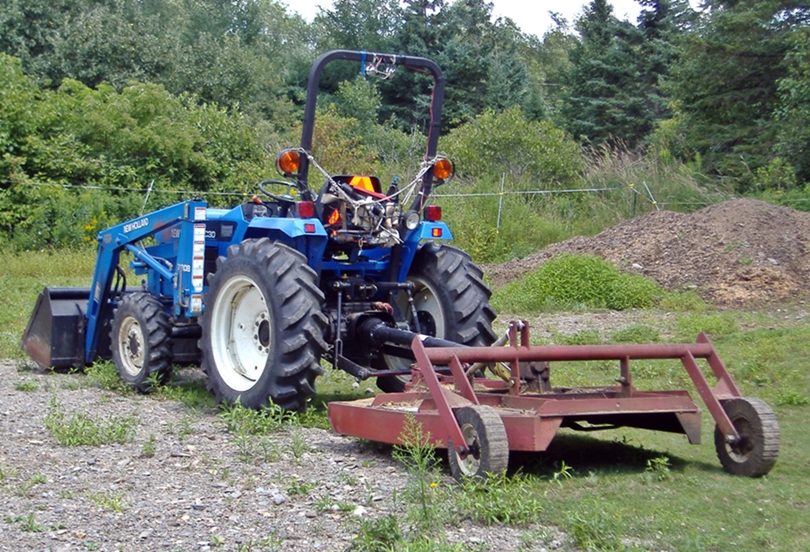

My 5' bush hog would have no problem with the brush. I pull it with a 30 hp TC30.

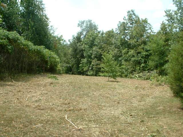

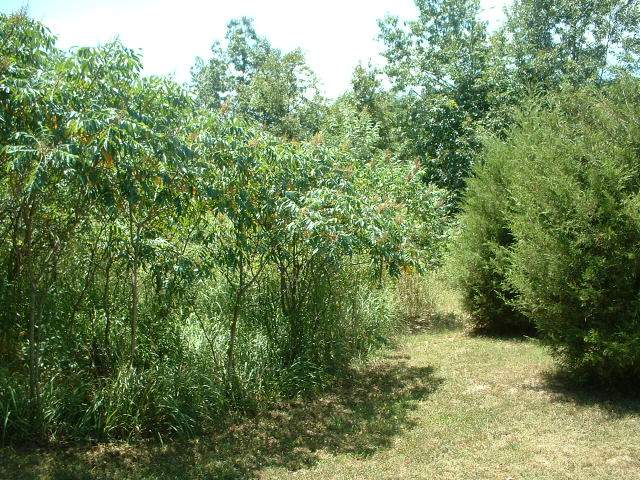

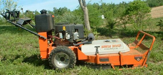

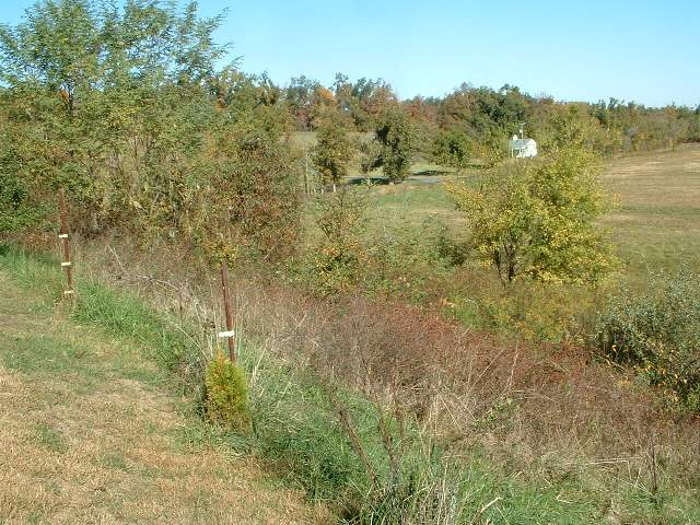

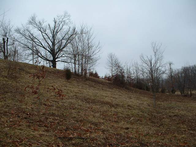

I went from this:
View attachment 586770 View attachment 586771
To this:
View attachment 586772 View attachment 586773

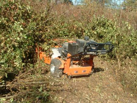

With this:
View attachment 586774 View attachment 586775
Granted it wasn't 5 acres, and it took a while. But it was done.
I did this also on my farm when I got it. DR mower I bought nearly 25 years ago. Used it until I got my first tractor with a bush hog. Still have it, can get into tight places tractor won't go.

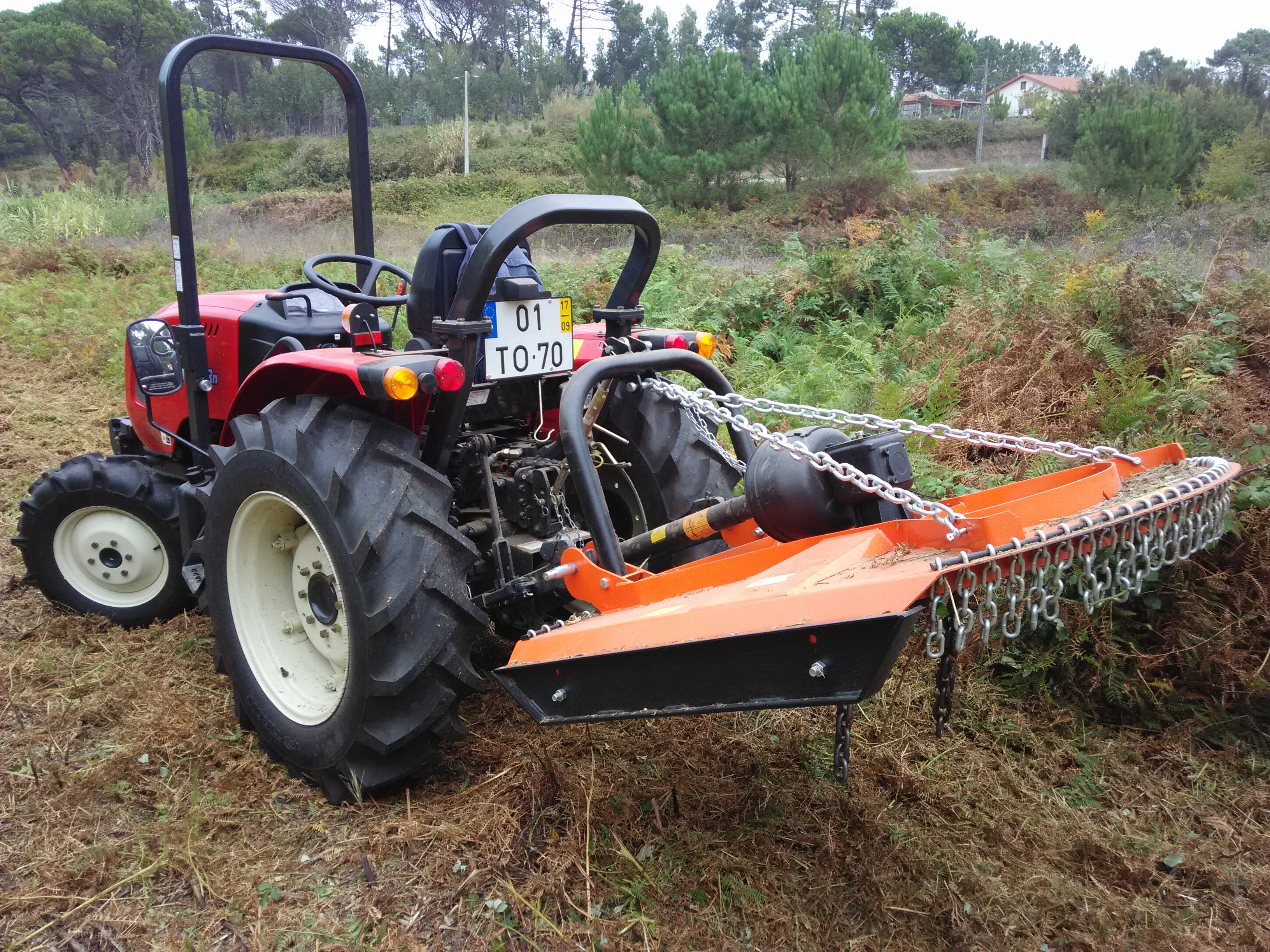

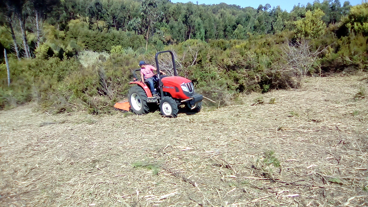

I've done worse with a 35 hp tractor and a 4 foot mower. However, over here, we use high strength chains in the mowers instead of blades, for this exact purpose. Shown in the second picture. It eat more HP of the tractor, hence the small since mower, but it shreds pretty much everything and won't get hurt if it hits rocks.
I've mowed small trees close to 3" in diameter. Taking it slow so I won't break anything.
View attachment 586857View attachment 586868
I like the way the chains are attached to the back of the mower. All US mowers have a solid piece there. I also like the front roll bar. Much better for going thru brush.
