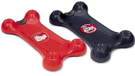

This is how I slide around on my back, a creeper with 5" diameter casters. :D
