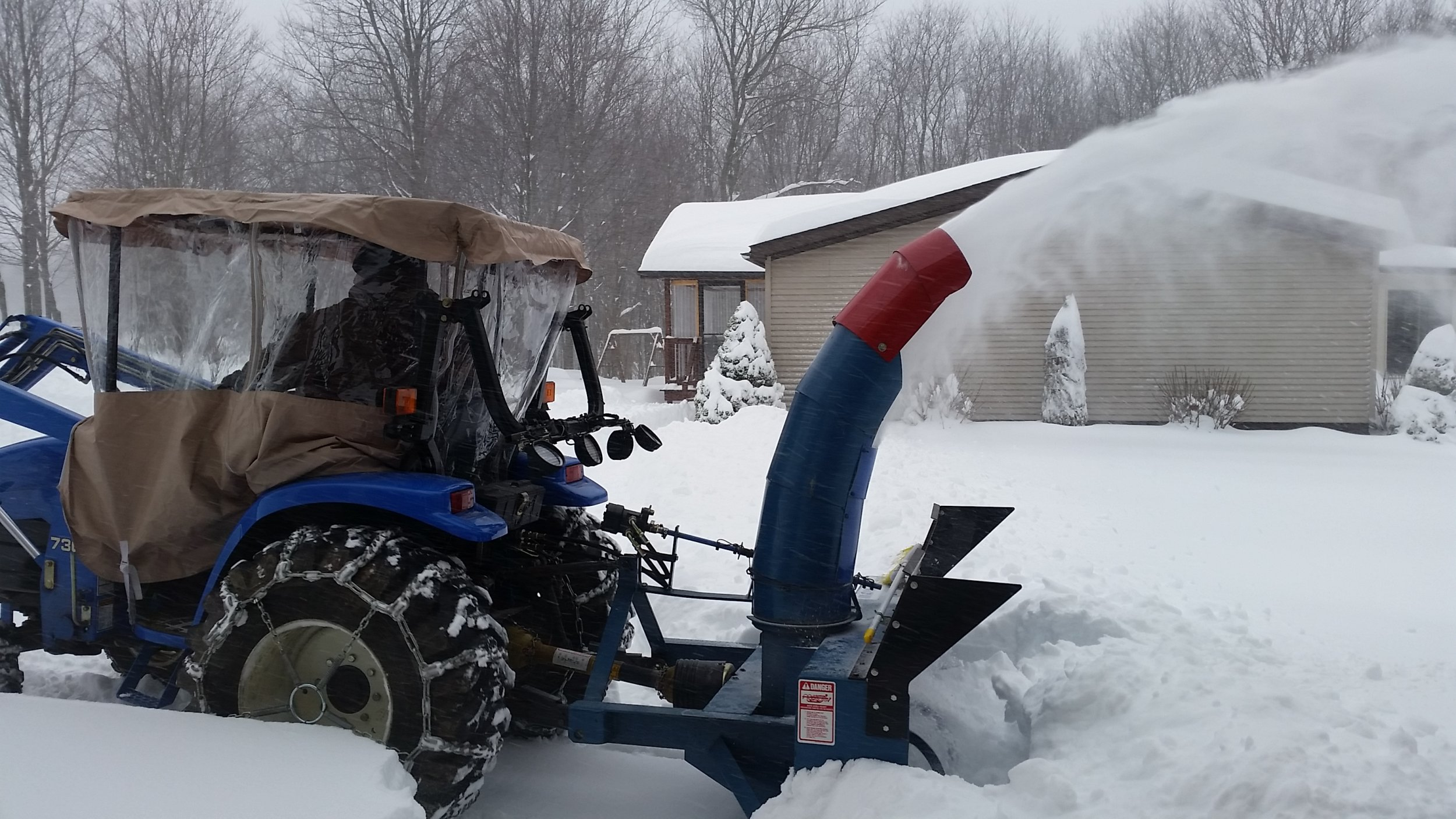

I went with a rear snowblower. Our
plow guy moved and apparently was giving us a great price. The new company came in and milked us. They were supposed to make a single pass every 6" and ending up coming 3-4x per storm. We spent $1000 plowing that year and it wasn't even a bad winter. The blower cost about $2500 and we are heading into year 4. I guess it's paid for itself not factoring time. The other thing to consider, I could sell this rear blower for $2000 in a heartbeat. I repaint each year and stored in a carport so it's in mint condition
