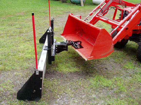

No matter what you attach to the front of your FEL, you still have the problem of pushing snow straight ahead such that it gathers and eventually exceeds your traction capability. You have mentioned using it to help push "heavy" snow. This might work for a while if you have a very large tractor but what you really need is a way to angle the front so the snow dumps off.
How about an old grader blade mounted offset to the bucket or a system like my attached pic.

Thanks SeymourBota. Does the setup move manually?
I'm surprised a plow designed that attaches like yours to the FEL is not available for those who don't want to remove the FEL. I have a angle manual blade on the JD..just looking for a way to move snow only for the BX23 with a simple or no change to the FEL/BH setup. Since I've never removed these two attachments yet, maybe it's just anxiety.

I would think that setup would put a lot of side stress on the loader arms while pushing snow with it angled sharply. To mount my plow (Kubota) you remove the FEL and mount a quick hitch to the front of the tractor. The plow then mounts to that. More work taking everything on & off, but no stress on the loader. Disadvantage: it can be raised, lowered and angle left & right, but not tilt forward or back like yours could.

I installed extra steel plates on the top and bottom of the bucket surface in the setup I posted the pic of, to distribute stress. This is used strictly for smaller snowfalls- there's a 60" 3PH snowblower on the rear for winter.
The best thing is that if I really want to use the bucket, I just pull one pin, back away and I'm in business!!
   / Do BX users think this will work #10
Tractor Jim CT- yes, I can manually angle the blade left, right or center (there are only 3 positions).
