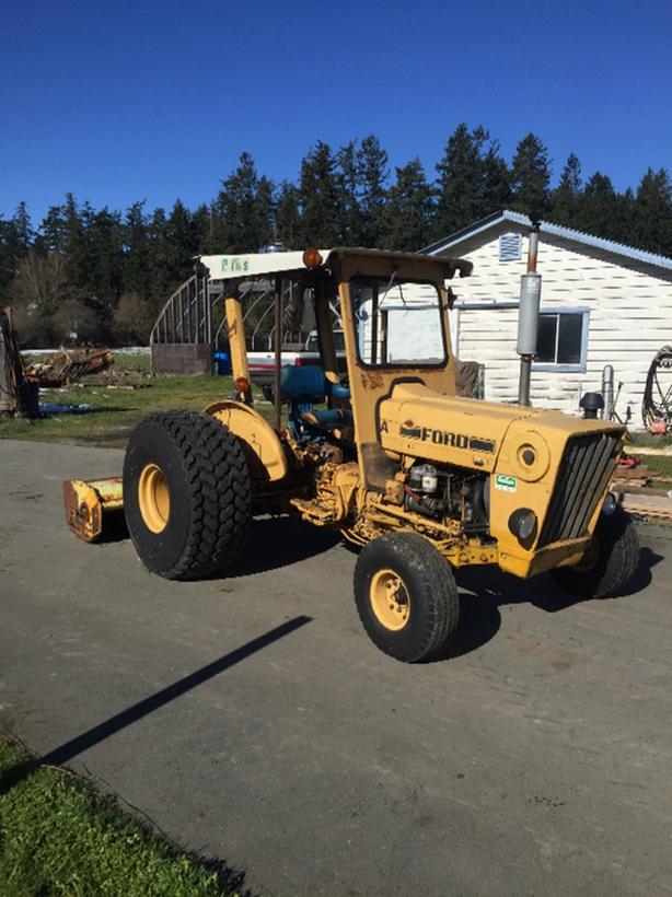

You used to see more low profile mowing tractors. Low turf tires, spread out far. Probably not even any ROPS back in the 70s. That's what you want. Your average loader tractor has no business being on a hillside!
Something like this:

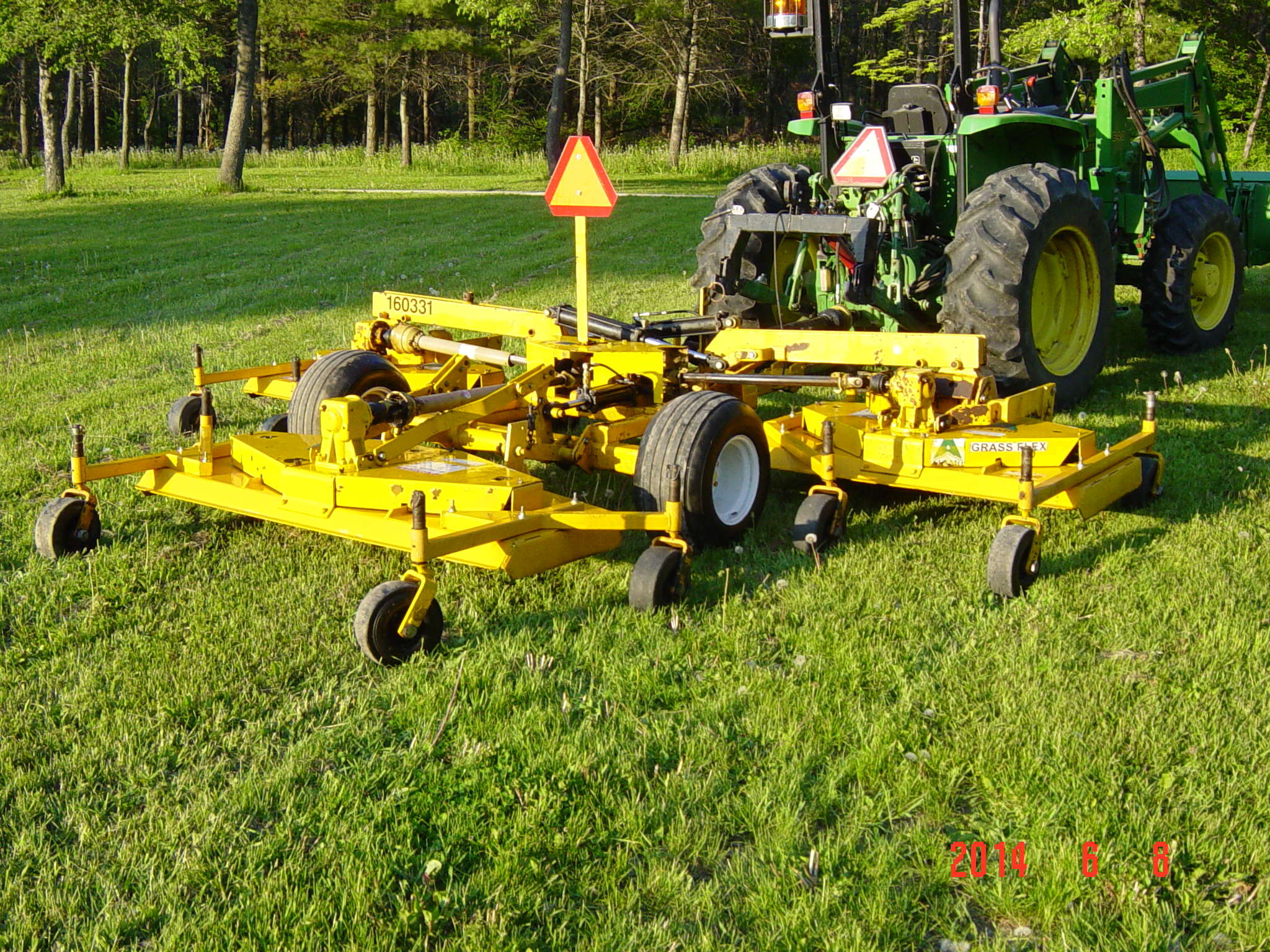

According to my neighbor, who I pay to cut my hills each year, his 15' increases his stability such that he can cut my hill side-to-side vs up and down like I do with Kubotal L4330. He uses an M5060; his tires are not widened as near as I can tell.
Here is the hill I used to cut and now he does:
   / Do Batwing Mowers Increase Lateral Stability on Hills? #20
What brand is your batwing mower?
How high will it cut.
Looks like an Almo Grass Flex which was available in 13-1/2', 14-1/2', 15-1/2' and 16-1/2' cut models.
I would hazard a guess that mower is a 15.5' or 16.5' wide cut model and most of those go from a 1.5" cut to a 5-6" high cut.
