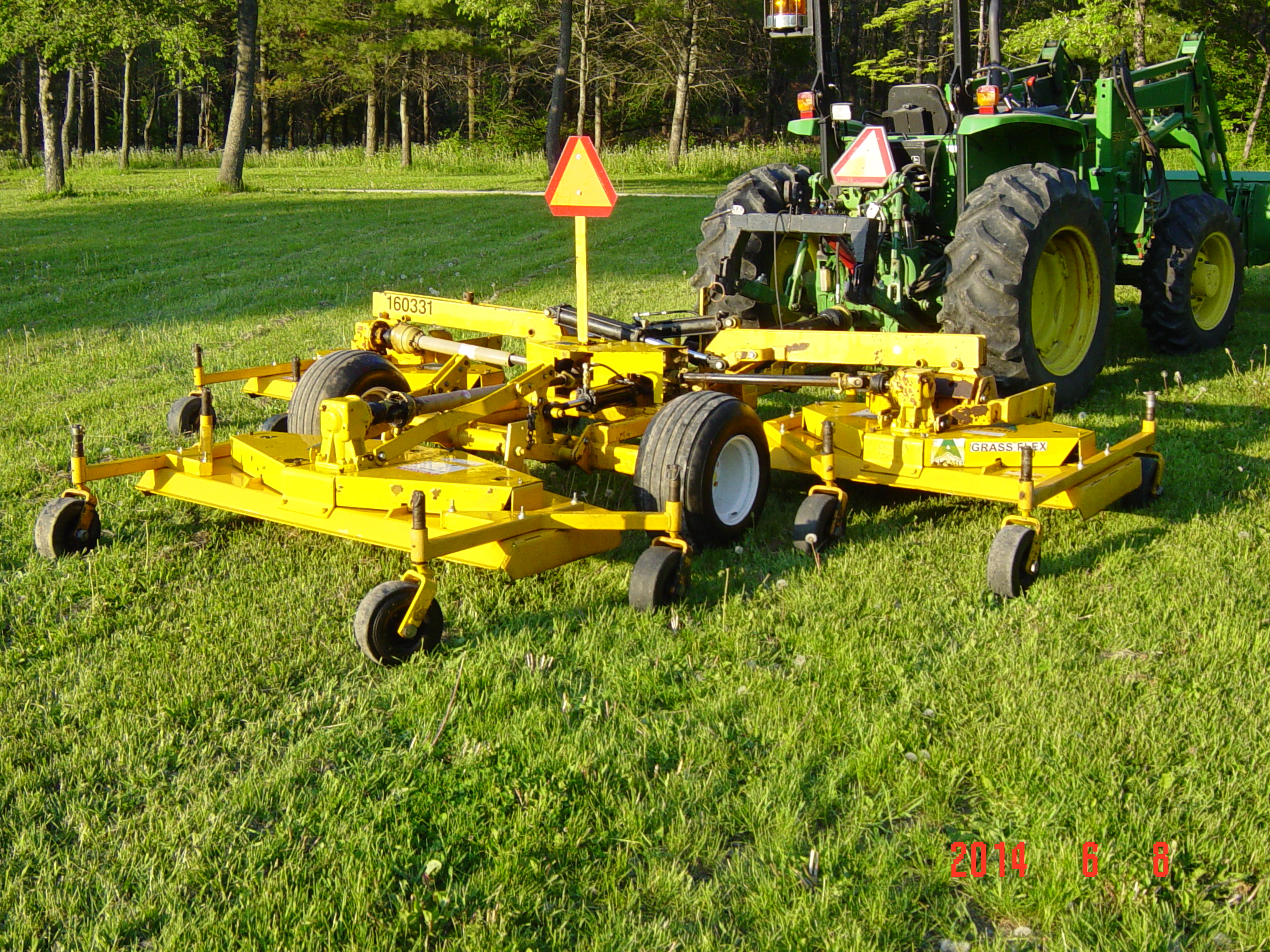

I would not bet on that at all. I have an integrated 10' 56hp bat wing mower that has tremenous capabilty on hills. Can run circles around my steiner, but it's all one unit.

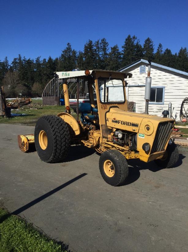

That's what I would think and giving you any illusion of a safer setup is just plain dangerous. If you ask me.
I had this rig, with also a good amount of tongue weight, but I never dreamed it would increase my stability.
