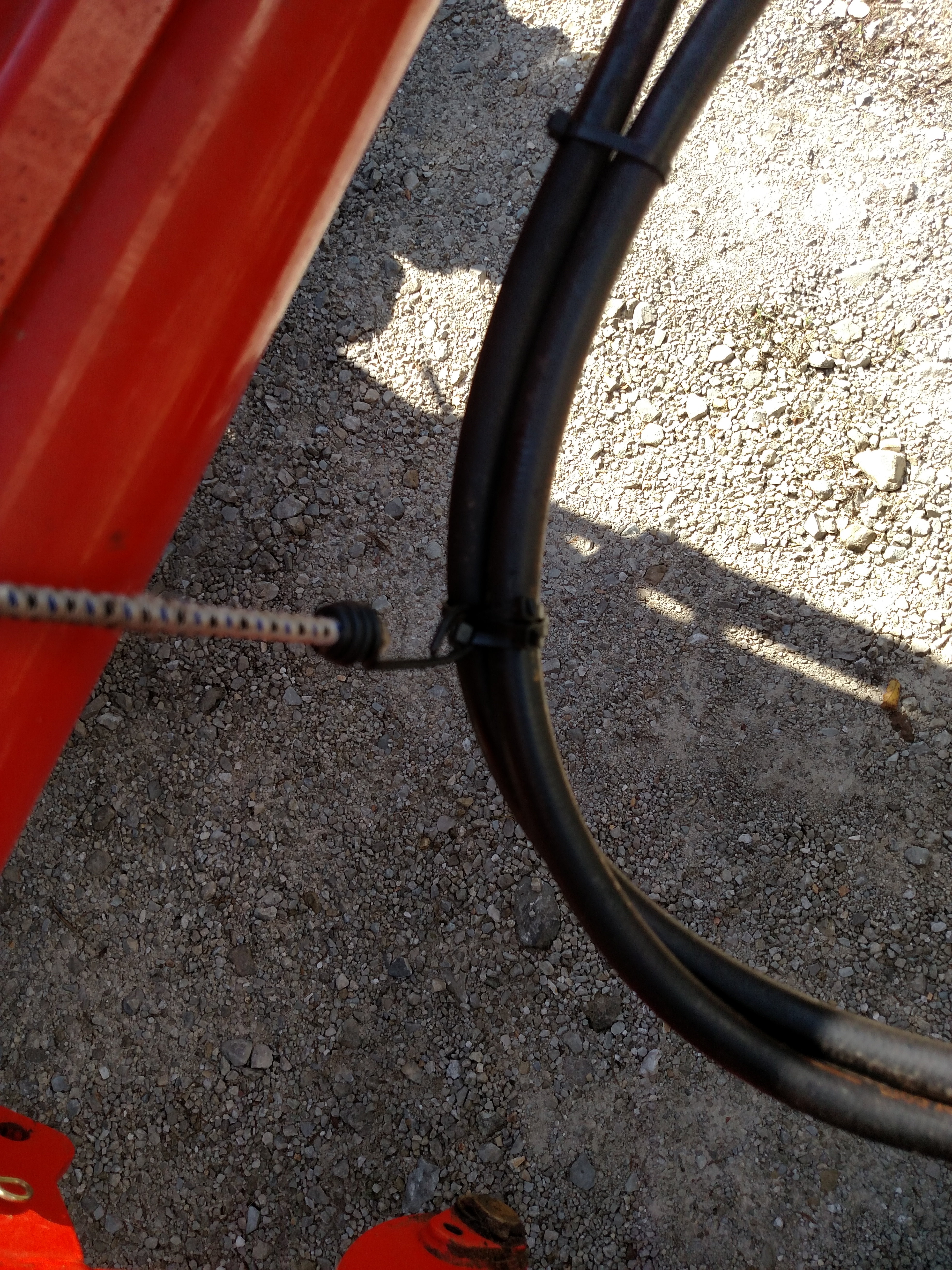

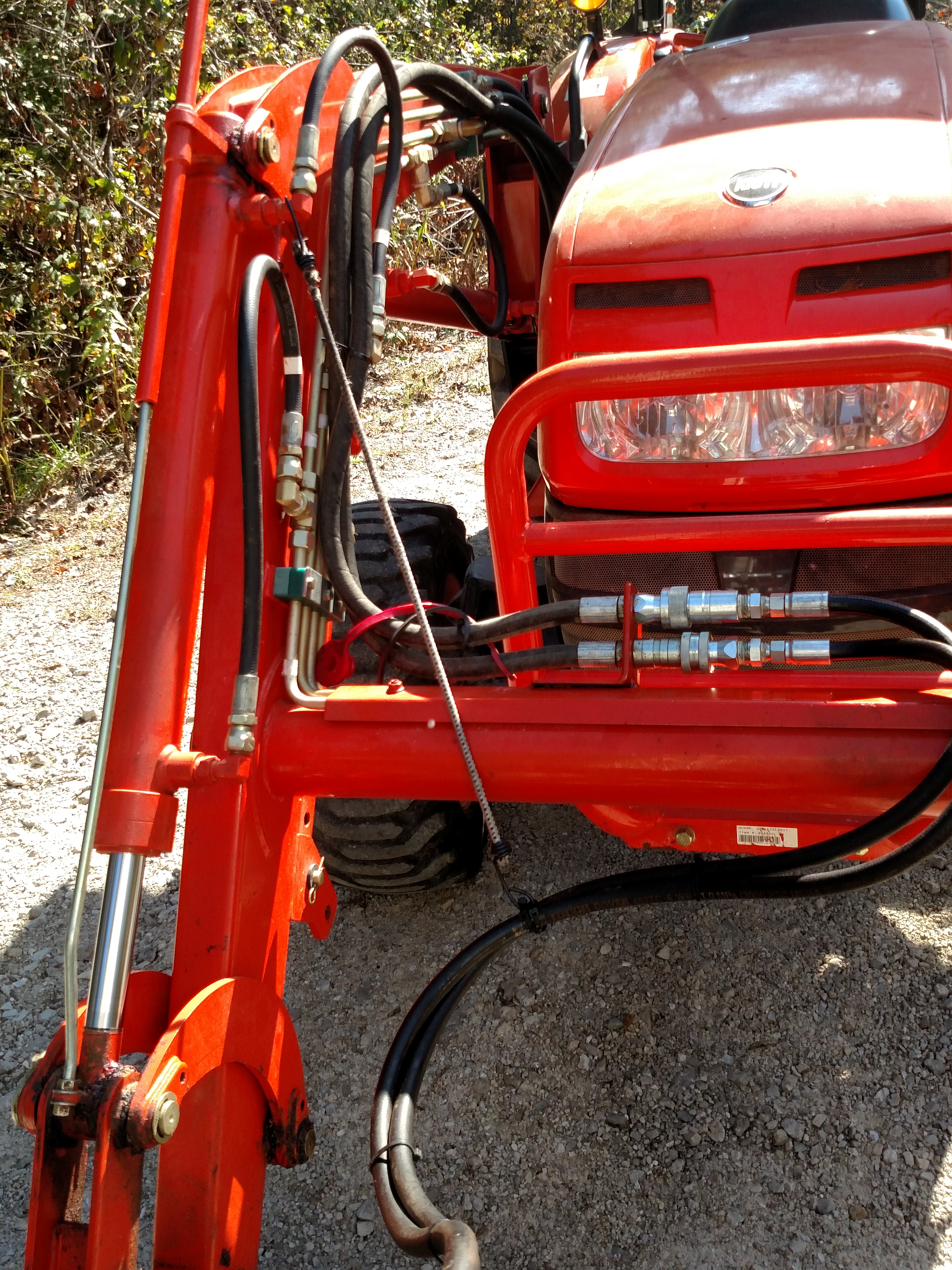

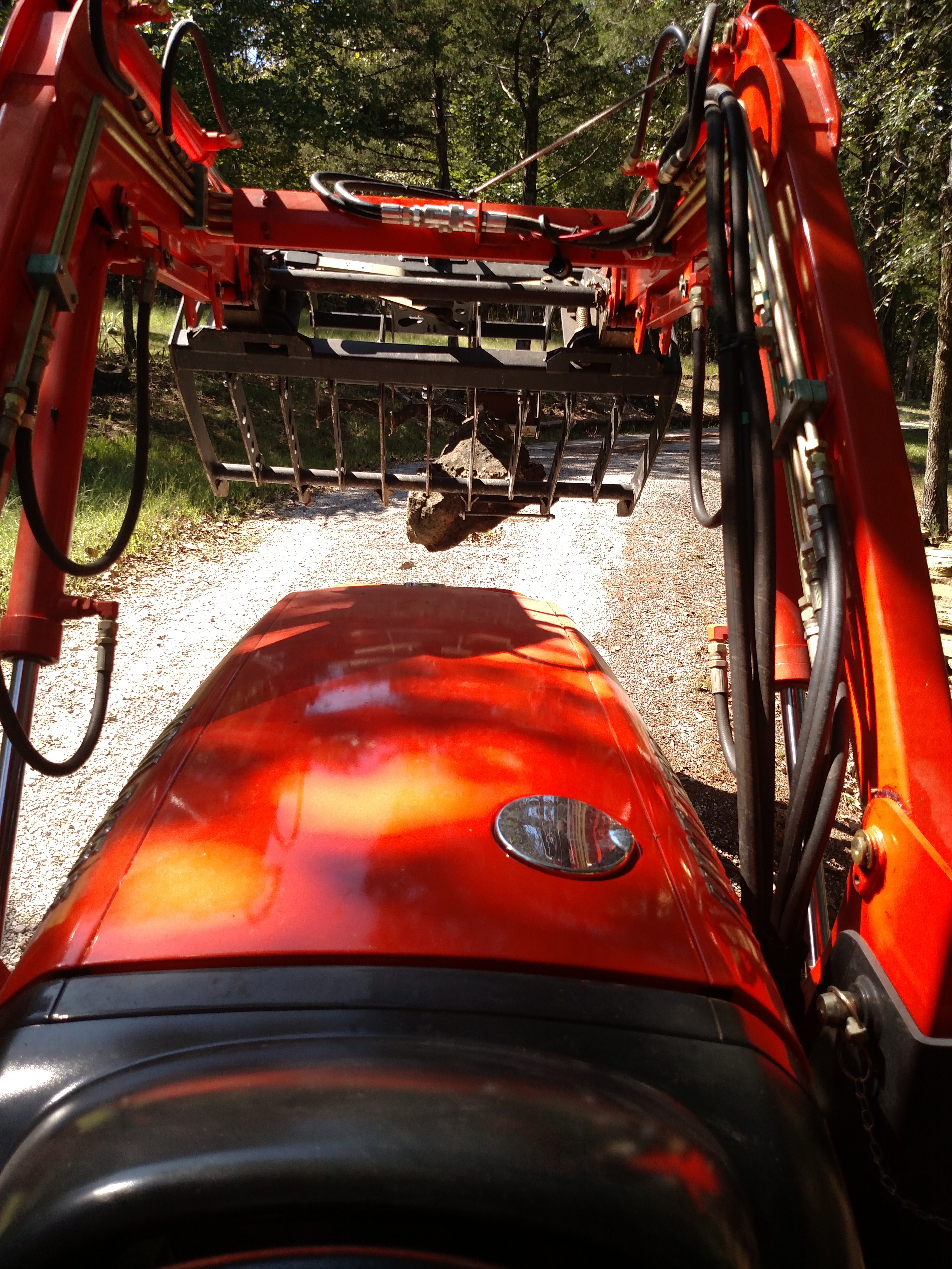

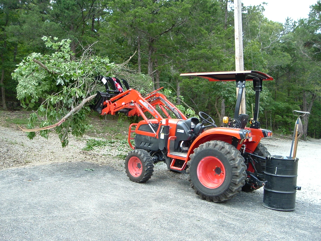

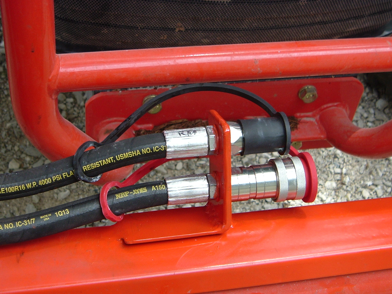

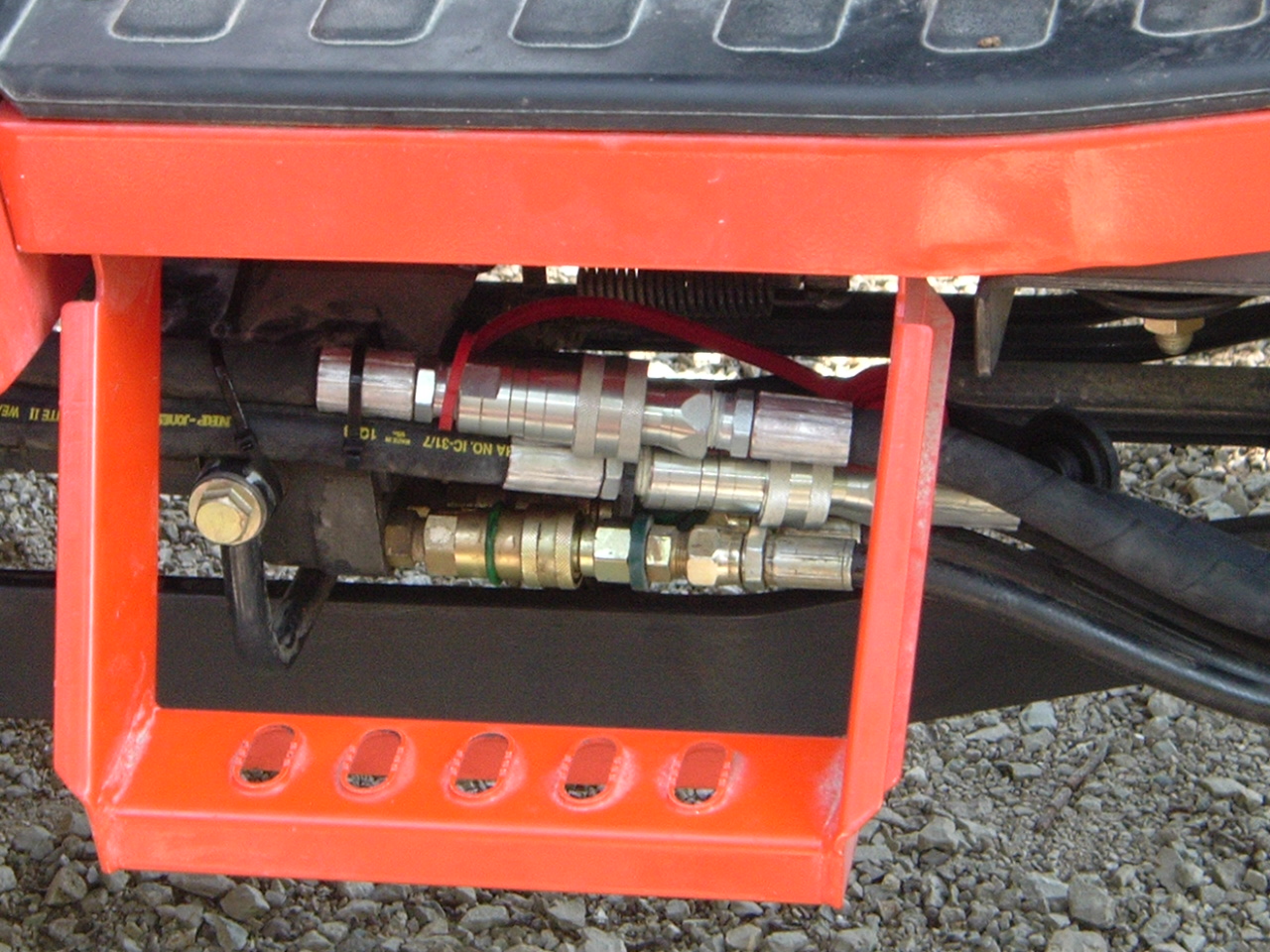

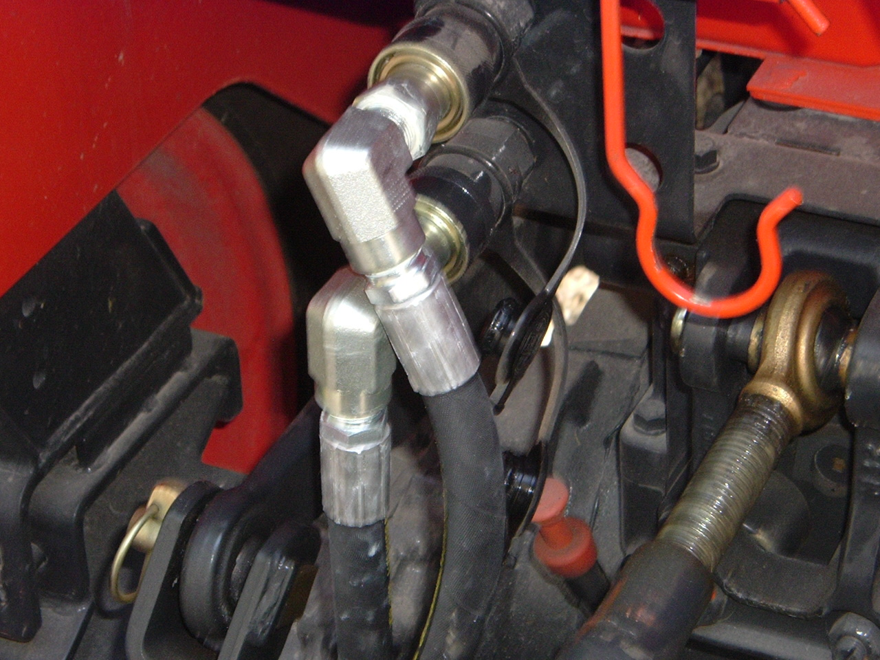

I do. It works fine for me because the rear remote lever is "handy" and it was low cost. I had about $150 in hoses and couplers. Don't forget you will want a set of couplings at the center so you can still take off your loader without removing your hoses.

I ran my grapple for years from the rear remotes. I did not find it that problematic especially for occasional use or where you have a lot of travel time between grab and dump. My FEL control lever is pretty high and sometimes I would reach across with my left hand to control that while my right hand controlled the remote at my right thigh. Very doable, but having a one hand control is much better for more than occasional use or working tight quarters where grab/dump cycles are quick.

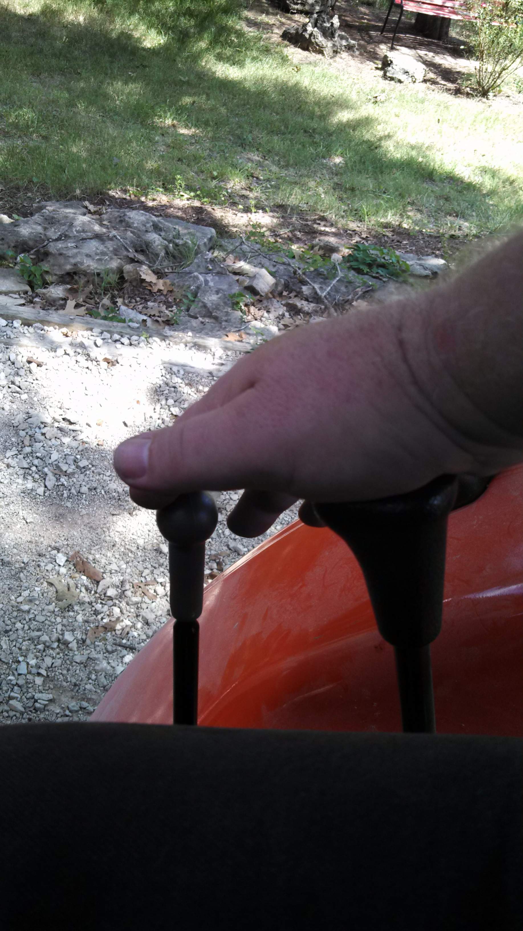

I think the key takeaway here as some of us are doing fine with our rear remotes control lever and some of us didn't care for the way it operates is that some of the remote levers are easy to reach and some are not. On mine, it was OK in its stock configuration, but I lengthened it 4 inches and now I can keep my hand on the main joystick and still operate the remote lever with fingers. You can read about that mode below if you like.
