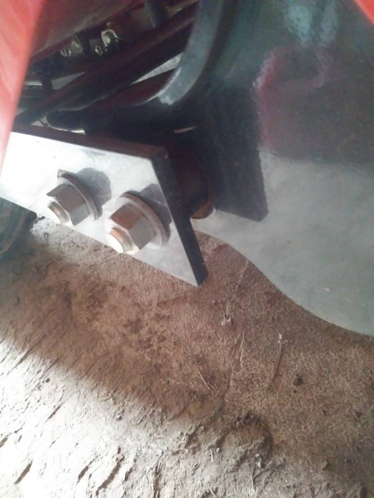

I would contact the dealer and tell him your concerns, send him the pictures if he is not close, document what is said, if something is wrong and you use the equipment, warranty might not cover it since you used it with known issues. Kubota can call that operator error and deny a warranty claim. I know because it happened to me.

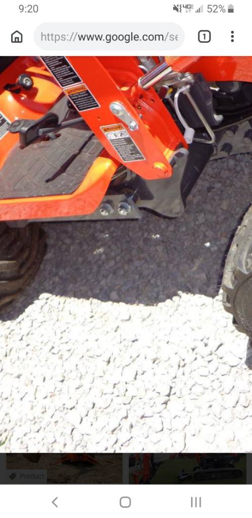

I found l pictures online of other BX23s' and they looks the same as yours, definitely looks odd but not uncommon. I have a few spots on my B where parts were mounted during assembly/painting and there isn't paint on those areas. Screenshot_20190311-092056_Chrome.jpeg

Thanks guys for all of your input. I will definitely check it out and also call the dealer. The leak is so minimal. It's only a few drops over a couple of weeks. I was just wondering if anyone else had the leak coming from the factory.
The bushing thing is weird. I wouldn't question it so much if not for noticing the hole in the offset.

My 23S has the same marks, and so did all the others on the lot (8 of them). I didn't give anymore thought to it not did I ask about it.

Here are pics of my brand new BX23S that I picked up last Wednesday. I see a similar gap as yours. I agree with JS5020, don't worry about it.

I bought a new BX23S last fall in October. I haven't used it yet and it's been sitting in my garage. Today, I was scoping it out because I am getting ready to do some projects. I noticed a couple of issues:
1. Underneath the operator platform on each side, it appears as if there was a larger metal bushing that was replaced with a smaller one. The bolts are not even centered in the hole. Does your BX23S look like this?
2. There is leaking (some drops on the floor) at the loader hydraulic quick connect (see picture). I did not do anything just yet other than look at it. Have any of you seen this or have had the same leakage?
I would appreciate your comments and advice.
Thank you.
When my BX25 was new the hydraulic connector for the loader leaked. My son tightened it and it has not leaked since. The quick connect coupling was loose.
