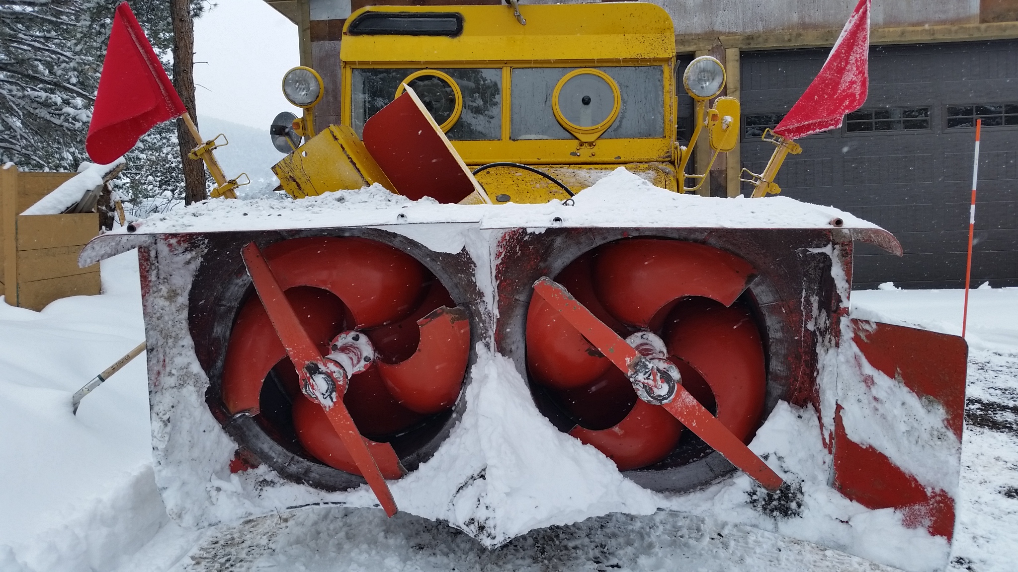

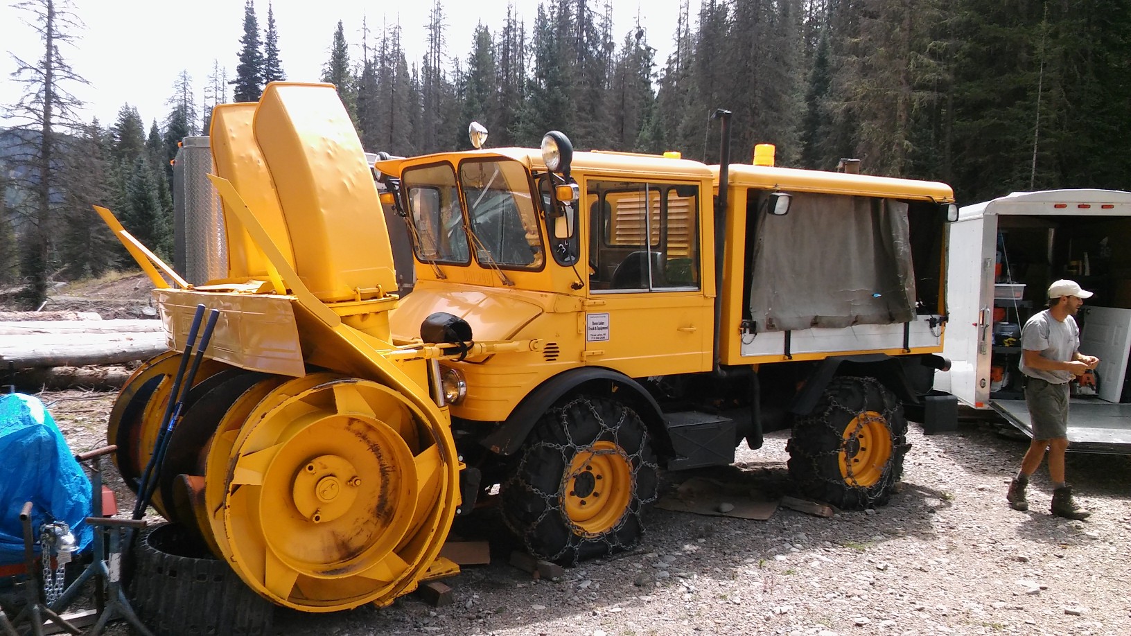

Hard for me to sit on the sidelines when the bashing of single-stage blowers gets going.
For small or mid-sized machine with typical snow conditions a two-stage blower is probably the way to go. If you have very difficult conditions (hard packed drifts, or very tough refrozen berms) something like the Reist blower mentioned by Dave M7040 above would be your new best friend. No, it doesn't blow as far, but in those conditions who cares?
When you get up to 100 HP or more, single stage blowers are common and they work darn well.
Below are single-stage blowers made by Beilhack and Schmidt, both running on Unimogs. The Beilhack is ours. But on my Kubota I run a 2 stage. It works really well for the easy stuff, but with PTO at 50 HP it can't compete in throwing distance with the single stage Beilhack at 110 hp.
That single stage design works far better than the one the OP pictured.

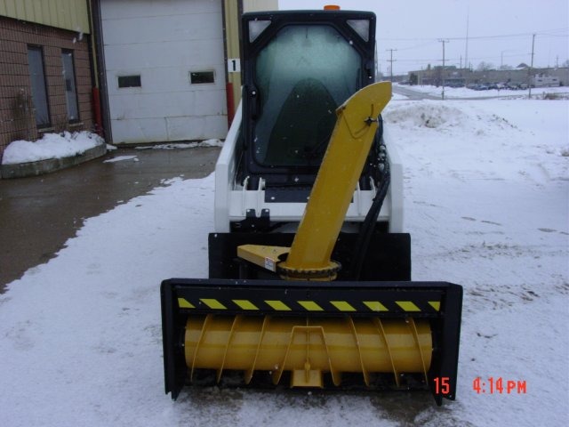

Looking for a blower to mount to my skidsteer. For budget reasons I'm wanting a tractor unit that's at least 6' wide. Looked at a two stage unit today, price was right, but there was too much damage to the fan and the unit would extend too far in front of the skidsteer. Even though he wanted $500 for a 7'-9" 120hp blower, it was just too big of a project to convert it.
Checking Craig's when I got home and I found a 72" single stage blower. Yea, it's a single stage tractor blower. The auger is much smaller than the typical tractor blower which is good because I'll be able to see over it. The blower looks just like the cheap homeowner single stage blower, but it' much wider. I think this might be perfect for my application, but I have no way to test it. My only experience is with two stage blowers, so is it possible for a single stage blower to not suck?

I have a picture of a hydraulic drive Reist Series 1000 and 2000 and picture of their separate hydraulic pump and drive system mounted on a tractor.

Does the Reist really require 35 gpm min for the 1000 series?. My power unit delivers a max of 32_33. GPM I need to look at max width for the 1000 series . Would be mounted on FEL so I need 78" min.

The Series 1000 comes in 48 and 54 inch widths
540 RPM at the PTO
13 inch snow blower rotor
18-30 gallons per minute oil flow for hydraulic drive
2500-3000 PSI
15-30 horsepower mule at the PTO
custom widths are available SO keep that in mind for a rear mount
If you mount a wider series 1000 on the rear PROVIDING you have plenty of power you will have plenty of snow clearing ability
The Series 2000 comes in 60"; 72"; 84" widths
540 RPM
24 inch snow blower rotor
25-55 horsepower mule
oil flow 20-35 gallons per minute
2500-3500 PSI
IF your mounting it on a mule with a front end loader you might as well buy a power pack from them for YOUR specific mule or buy a complete power pack that mounts on the three point hitch.
Your going to end up looking at close to 70 feet of hydraulic hose for flow if you mount it on the loader versus mounting it on the rear with a much taller discharge chute to eliminate the snow spray.
YOU need to keep in mind a wider cut with a single stage will take longer on the first pass and then you can take half cuts BUT a single stage slightly wider than your rear tires will not lack power as long as you follow the Reist size recommendations for power and you can clear half cuts faster. The more power you have the more effective a standard width single stage will be for you as you will have more power than recommended by Reist.
