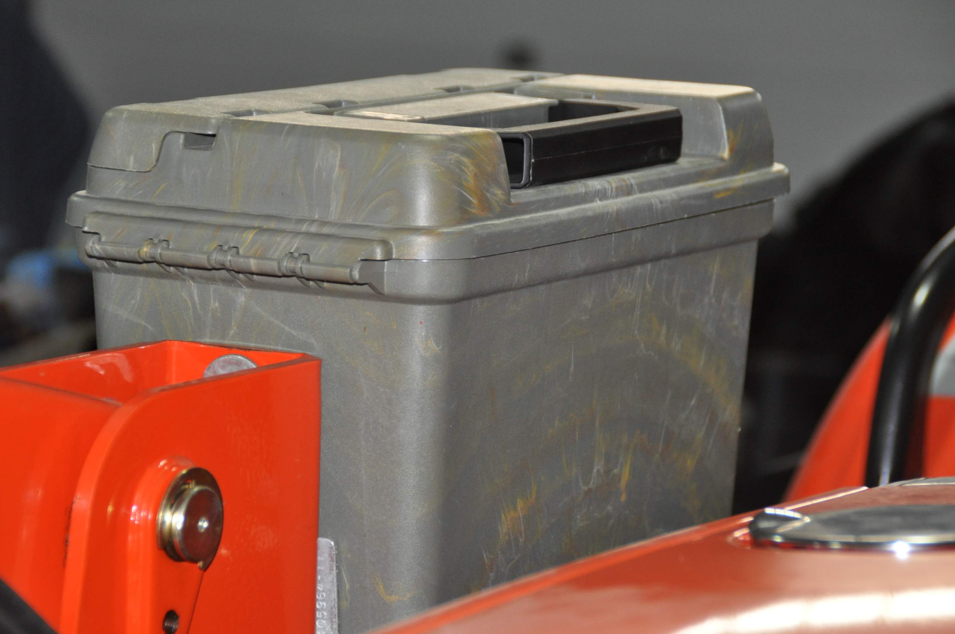

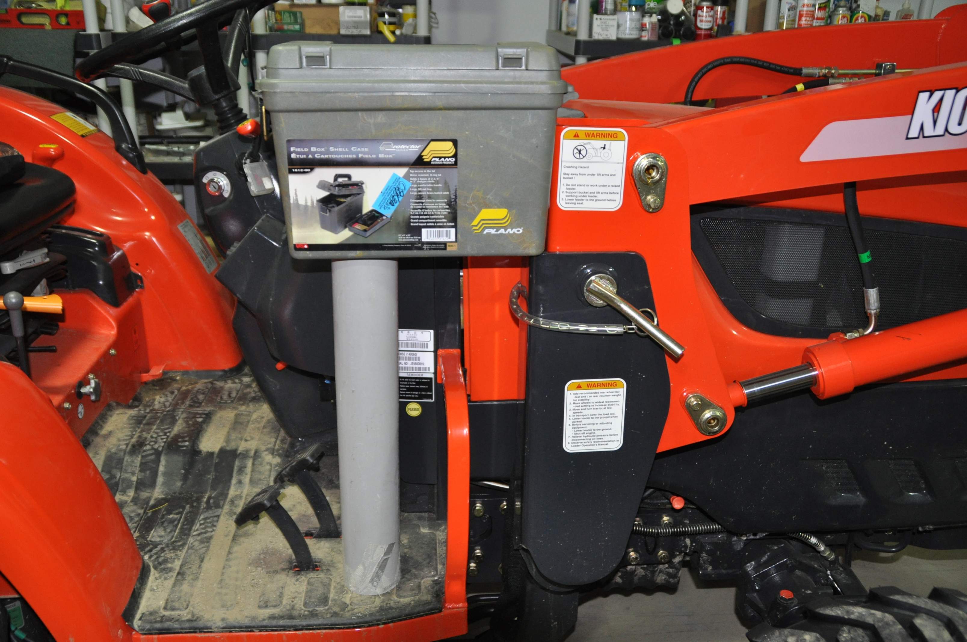

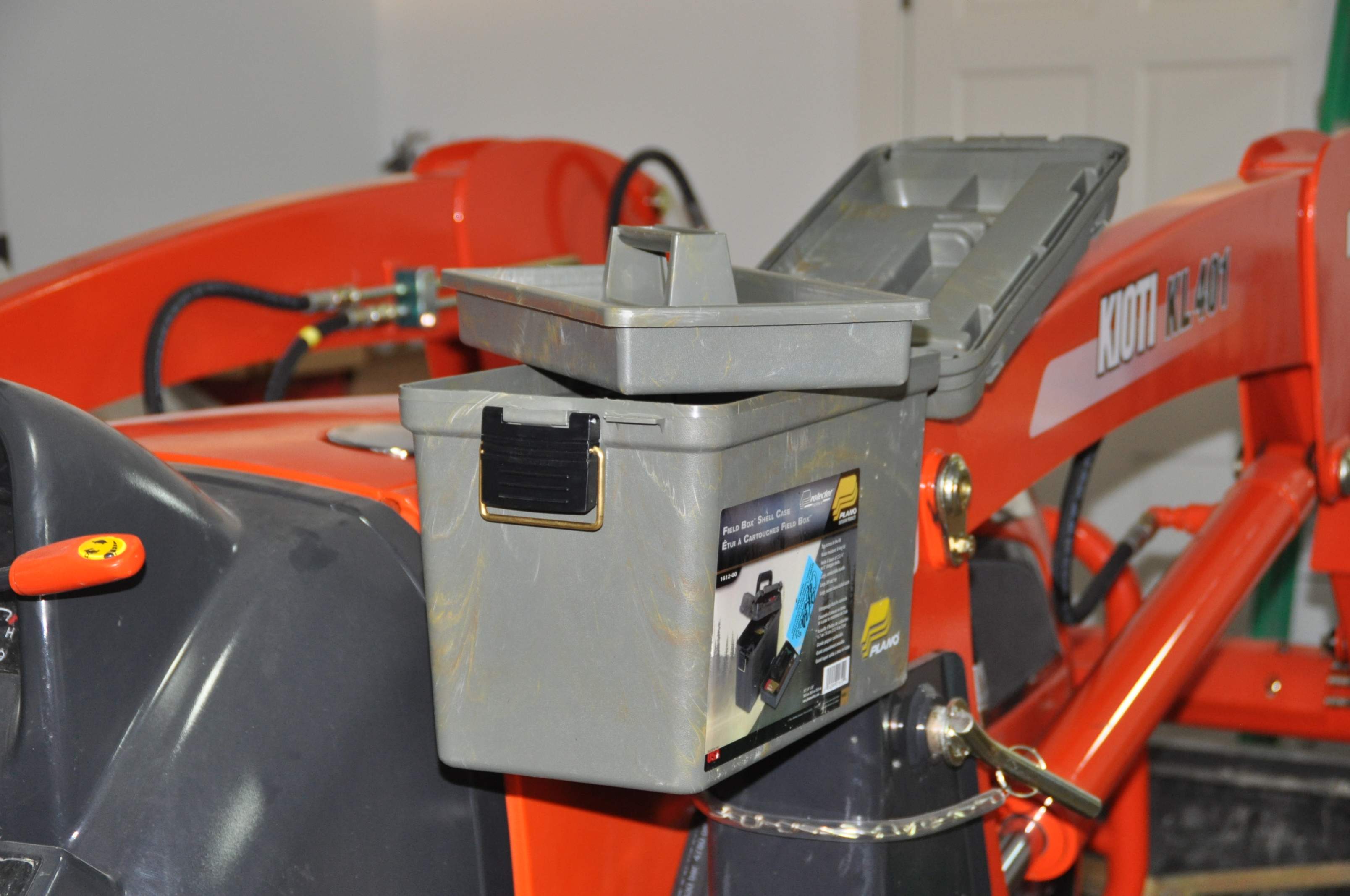

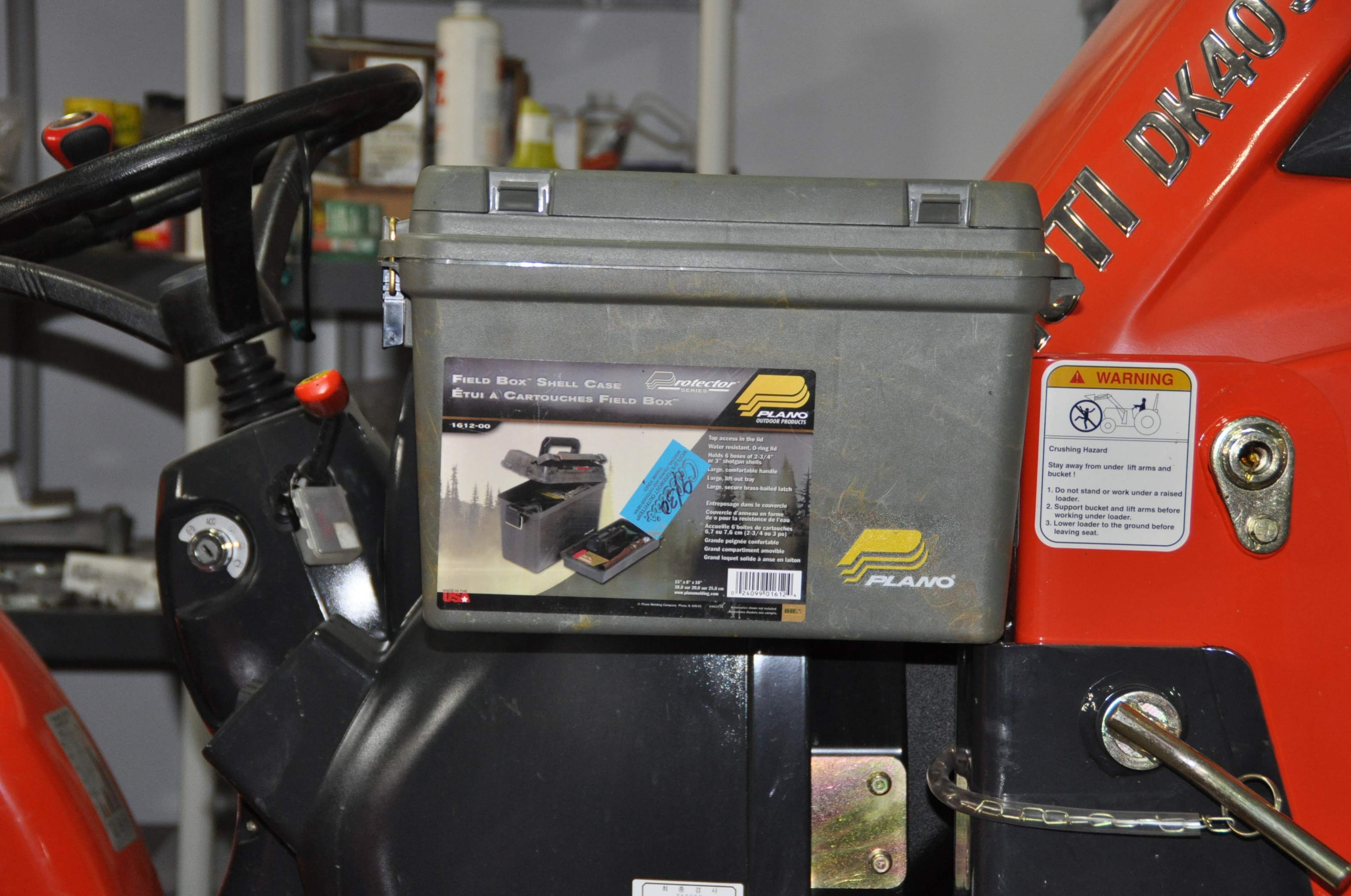

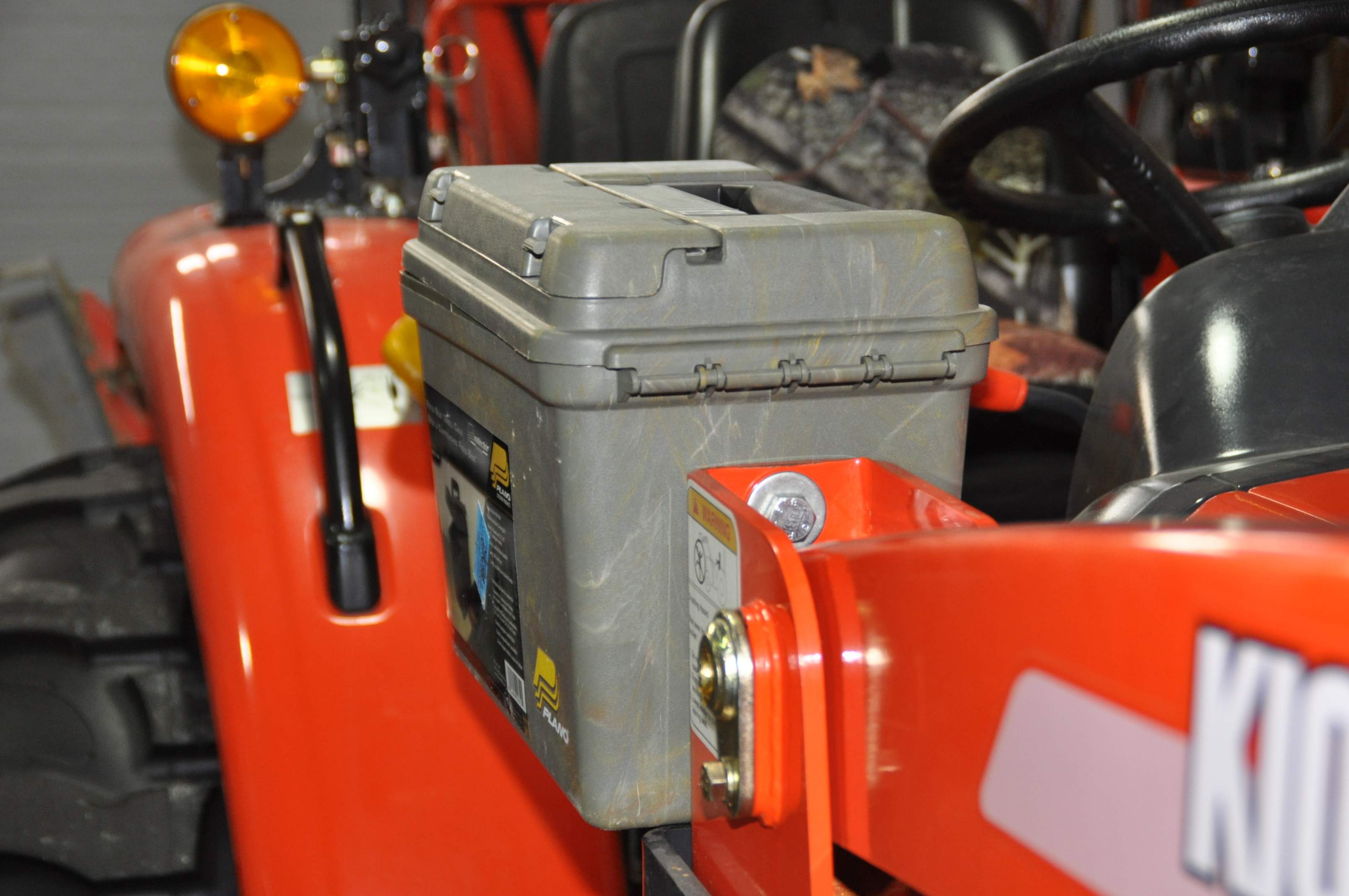

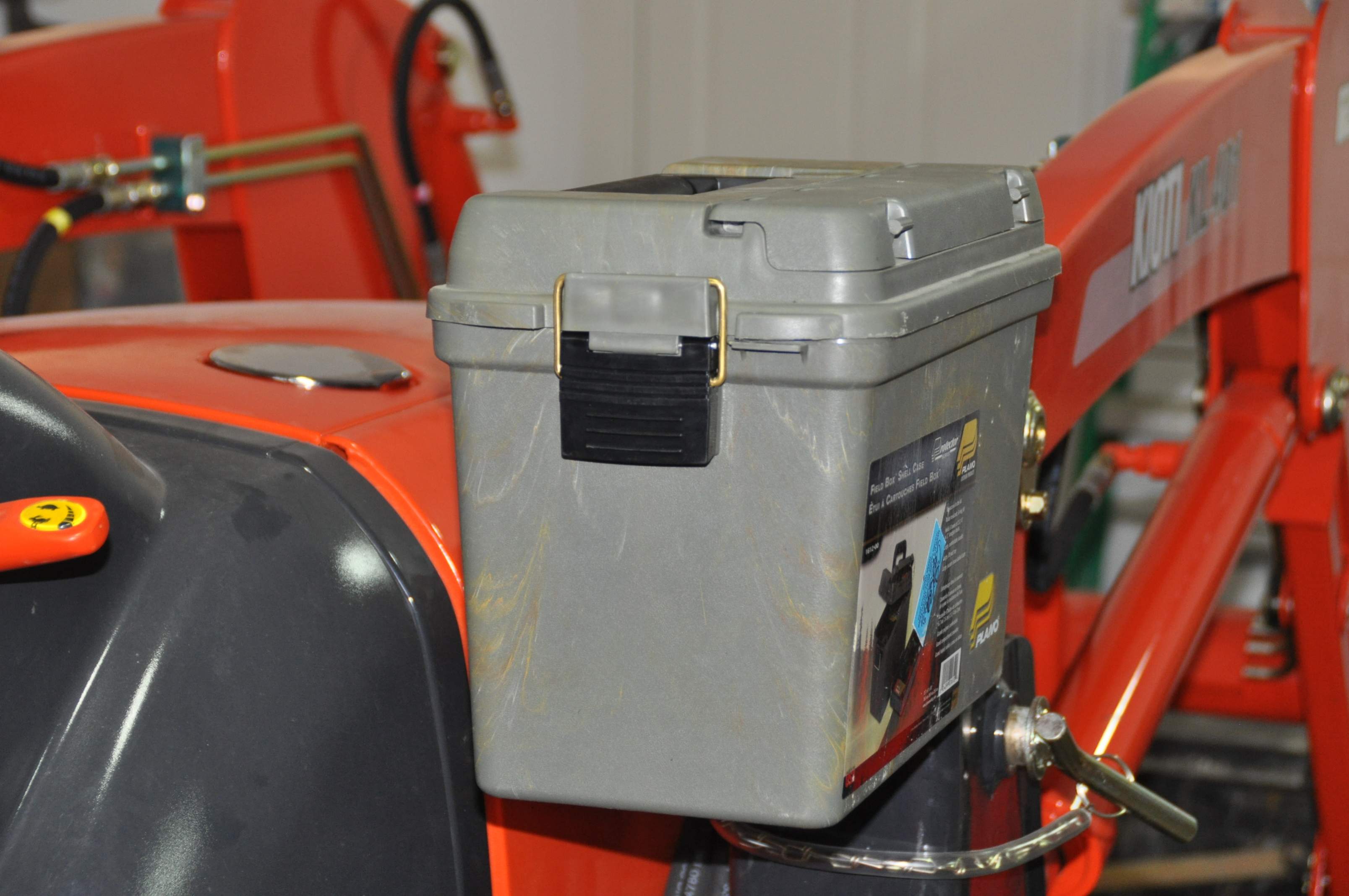

I lucked out when I purchased a Plano #1612-00 Deep Field Box; Size is: 15 x 8 x 10" It fits perfectly bolted to the right side loader arm, just above the diagram of loader's joystick operation. There is a bolt hole in just the right place to install a 1/4' or slightly larger bolt from the loader's (orange) vertical steel frame into the end area of the Plano box. Placed properly this allows the bottom edge of the box to sit on the gray/black loader frame member. With the Plano box label facing to the outside of the tractor, one can open the box lid and it will hinge toward the front of the tractor.
The box may need a 'leg' support which I will probably add to the setup mentioned above, for additional support, since the box is not really meant for this particular application, and the wall material is not particularly heavy duty use. My current thinking is to use a piece of threaded rod with a fender washer that will sit on the floor-mat and a nut directly above to keep it held in place to disperse the downward load from the box above. Then I will allow the rod to enter the Plano box's floor with a fender washer and nut just below the floor and the same rig inside the boxes 'floor' to lock everything together. I've mounted mine so it is split, and evenly balanced on the end of the loader arm, so it is not protruding out beyond the protection the loader arm provides due to it's mass. And the box is high enough to not be anywhere near the hst pedals. Since it is mounted on the right side of the tractor it will also help to remind one to enter the tractor from the left side only, for safety in relation to the loader joystick, etc. And so far it does not seem that it will block visibility too much; the loader's arms are doing a good job of that already:laughing:
My original intent when I bought the box was to install it where the little black box Kioti provides goes behind the seat, but for several reasons, mostly due to size restraints, it would not work there, or for that matter anywhere else I could think of until I saw the above opportunity.
It is available via Cabela's or via www.Planomolding.com
I have no association with either company.

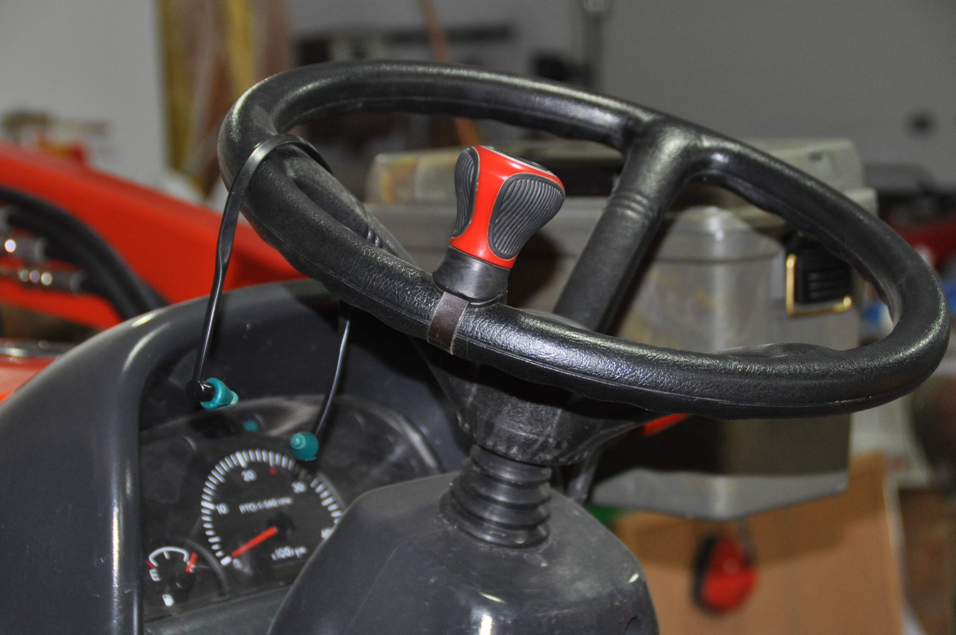

Here are the pics!
[/ATTACH][/ATTACH][/ATTACH]
Me not so good at uploading pics.... Don't do it often enough. :)
Please note: one of the pics shows how I enclosed the loader pin retaining chain(s) with clear plastic tubing to prevent the chains from scratching the loader arm's paint.
While I'm on the subject of pet peeves about Kioti tractors - man would I like it if they made the hood open high enough to get at things on the firewall. Ideally it would open to vertical!
How do you guys like the pics?
Thx,
CM

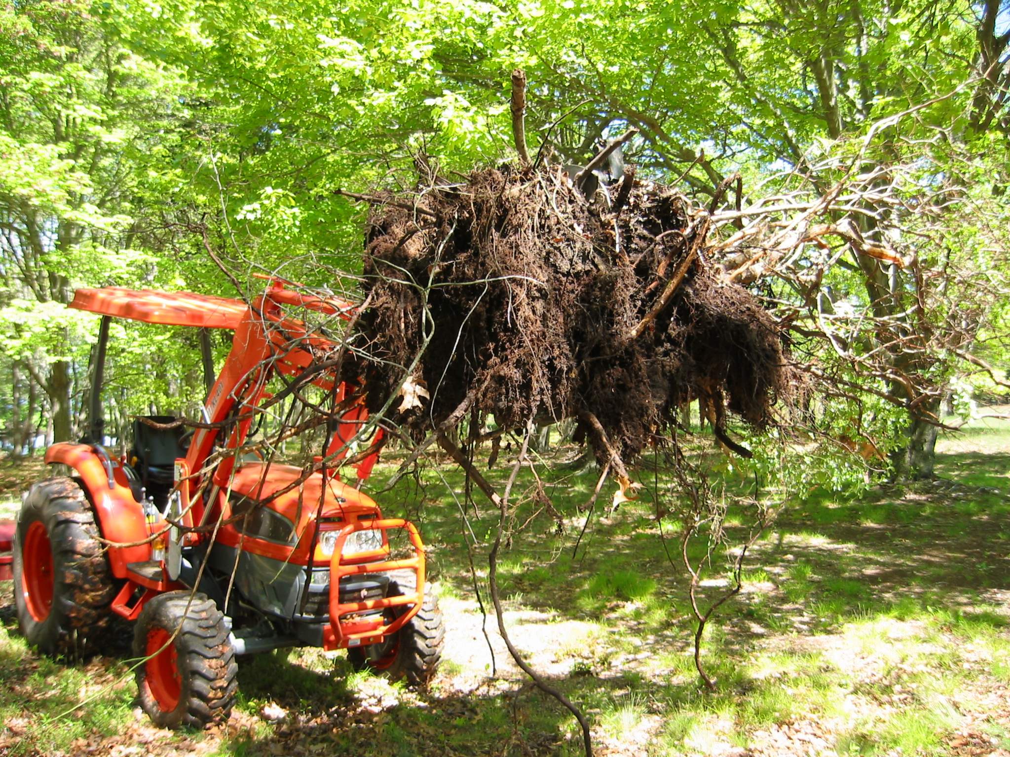

Pictures are nice but man, that tractor is way too clean! WTF? There is not even any grease around the zerks. The tires are clean too and look like they've either never seen dirt or are polished each night.:confused2: Please don't tell us this beautiful DK is a garage queen.:( We need photos with DIRT!:thumbsup:
Here is what a real working DK40se looks like.:D

There's plenty of dirt on the backhoe, which is not in the pics I posted, but believe me when I say I'm not one of those wash and wax guys.:cool:
I can't remember if I EVER completed washing and especially waxing anything I've ever owned- it seems like a colossal waste of time to me.
Hey Island,
What's on the backhoe in the last pic? Is that an 'ice pic'?
O2batsea,
I beat the snot out of the hood of my DK-35se/hst right after getting it, when a stump rolled and missed the brush guard and headlights/radiator, but pounded the front of the hood.
It cost me a new hood when I traded the 35 in for the 40. So far this one seems to be doing the havoc wreaking on things other than itself; and I'm hoping to keep it that way.

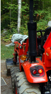

I used 2 feet of 4" Pvc attached to ROPS using carriage bolts.Holds a small cats paw hammer, wrenches pliers and assorted extras. Pressure cap glued on bottom and screw cap adapter on top. Water proof and better than factory box on my CK 20.
