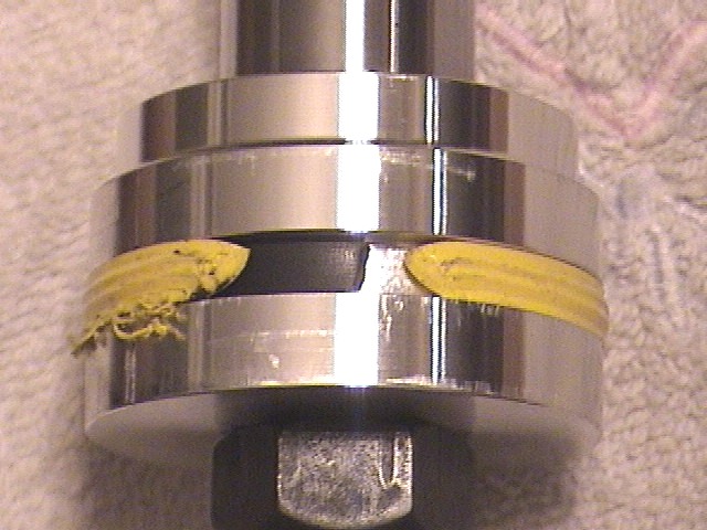

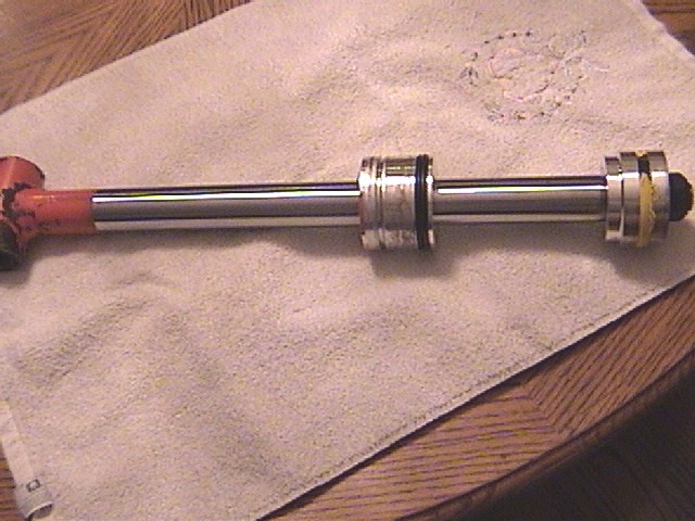

Been busy doing other stuff, but finally got the cylinder apart. As expected one of the seals was bad.
I've purchased some new seals and should have it back together by weeks end!!
I have a picture of the seal.
RedDog

Put cylinder together today. They (the hydraulic store) didn't not have an exact size seal, so I bought the one that was slightly larger. I sanded it down slightly (store said that a lot of people do this).
So far so good!! Loader is curling and holding its position.
Total cost of repair was just under $8.00. Not to bad for my first time taking a cylinder apart.
RedDog

It wasn't bad at all once I saw how the metal "ring" comes out. I took it to a friend of mine who does cylinders. He got it out pretty quick while I held the cylinder.
Once the ring was out he shot air through one of the hoses that I still had attached to the cylinder. He said a lot of times this will push the piston out of the cylinder. Unfortunately my one seal was very bad and you could hear the air going past the seal and not forcing the piston out.
We then went with "hammering" it out. It came out pretty easy, and you could immediately see the bad seal.
The spanner wrench helps a great deal with getting the metal ring out, and putting it back in.
RedDog
