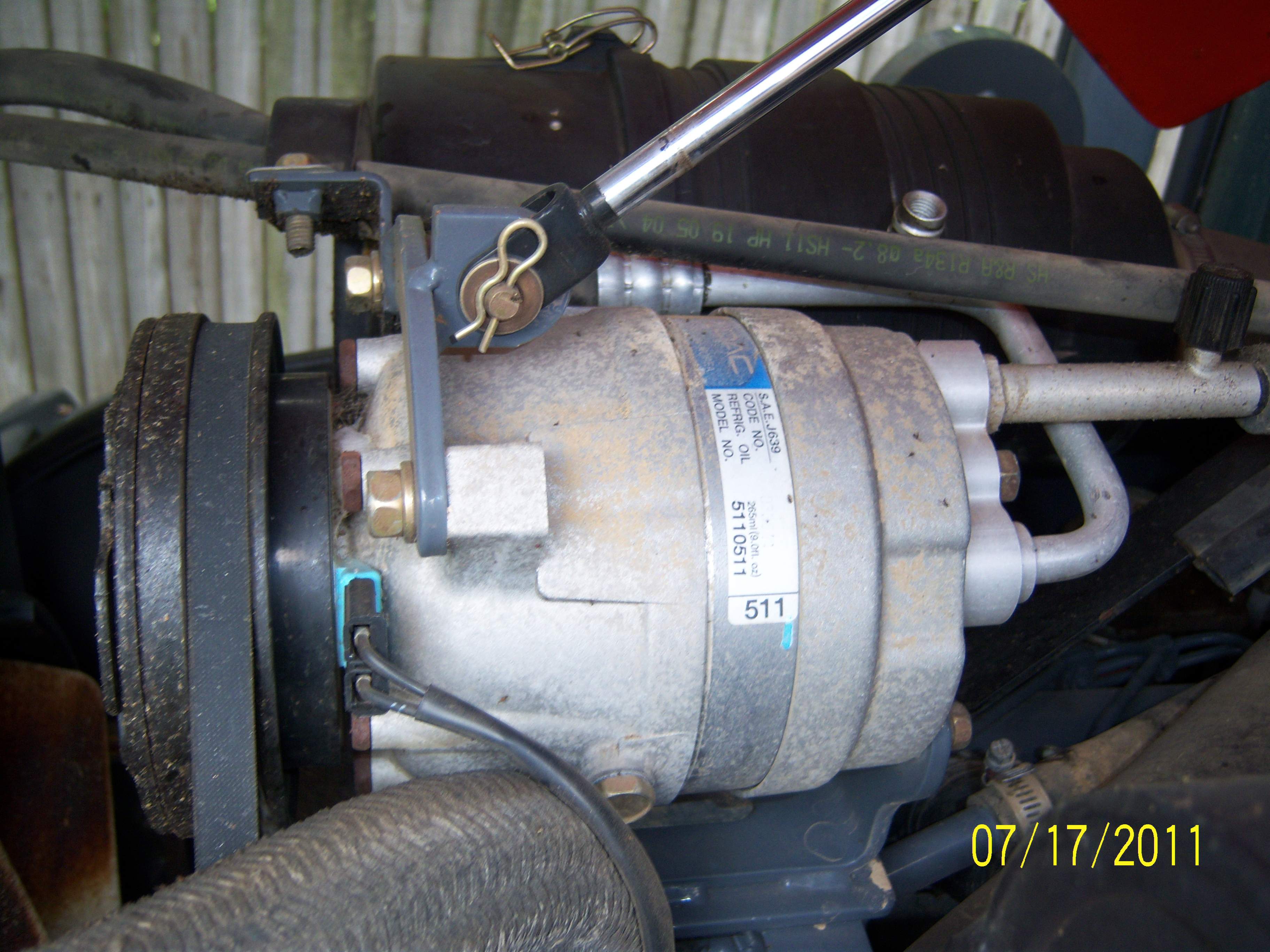

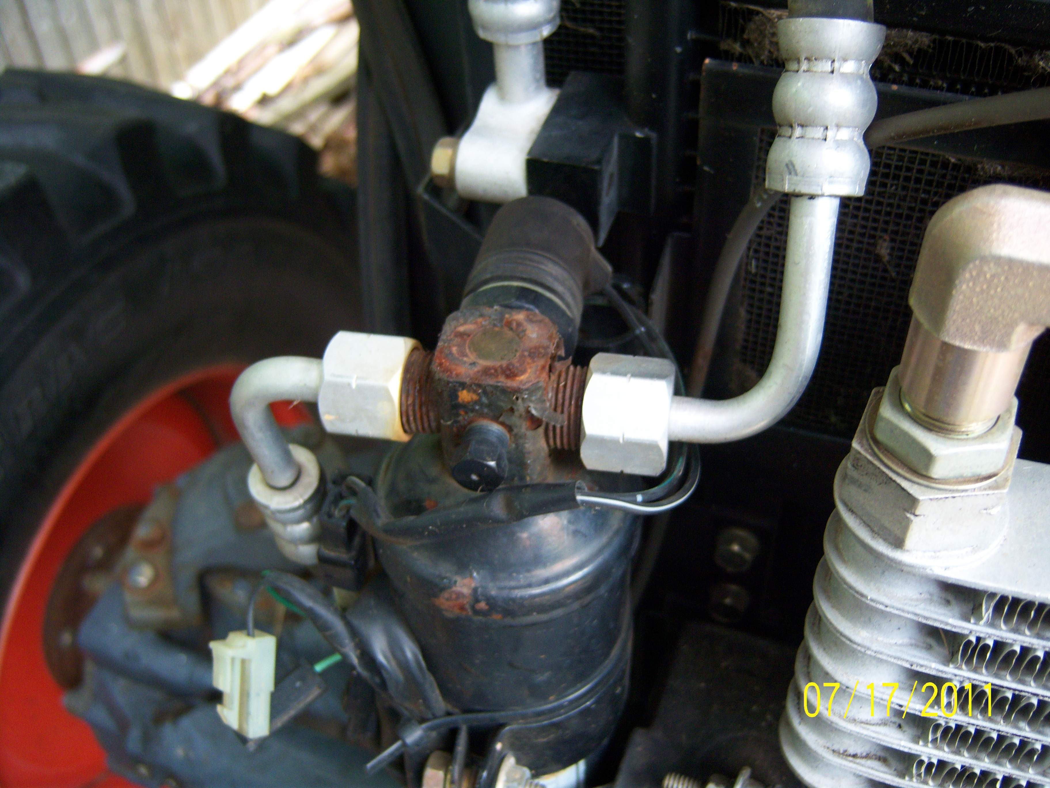

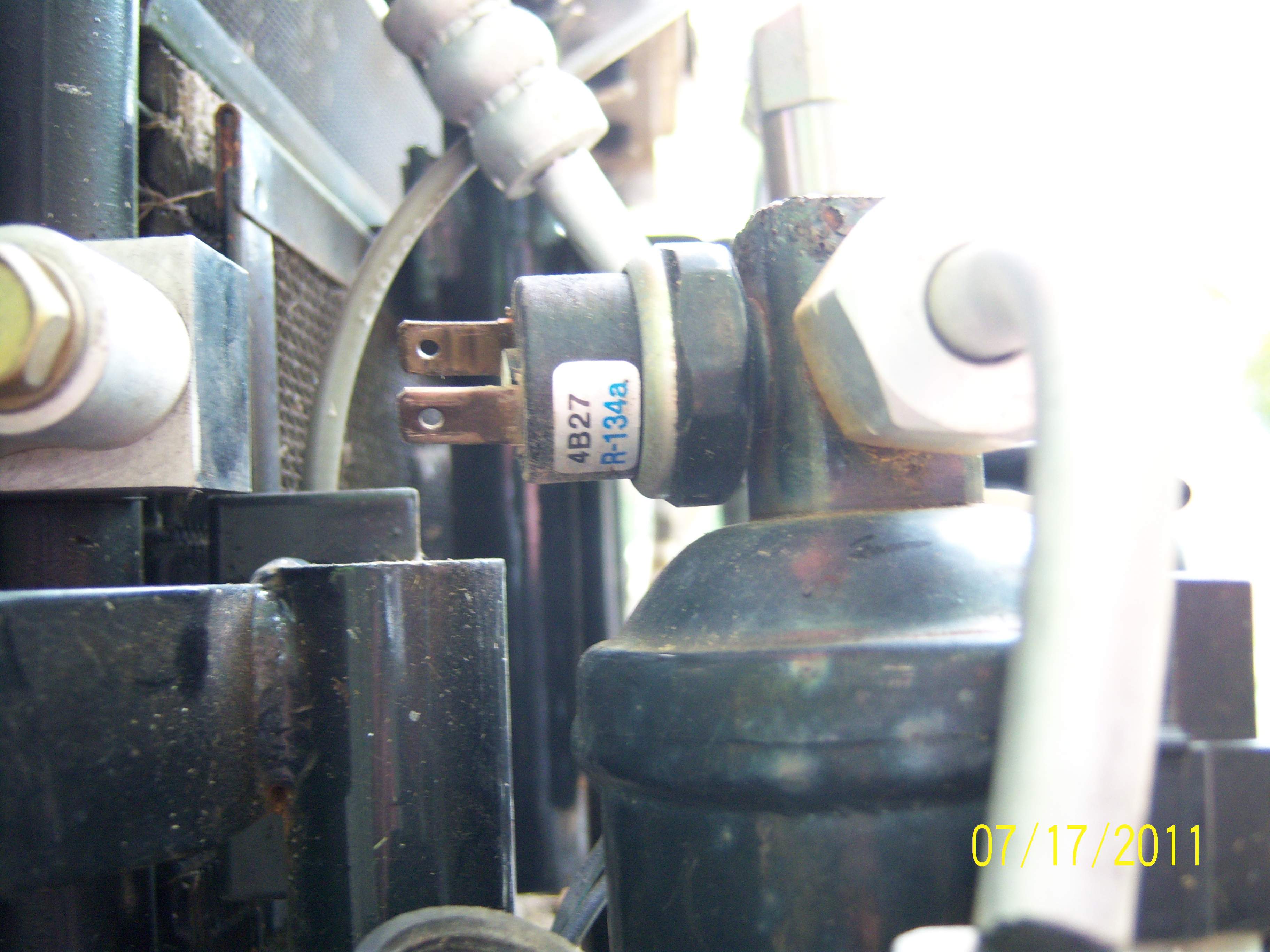

arsenix2001, I hear you im going to call tomarrow, Im one of those people who bought a Kioti knowing there is no dealer near by so have two buy parts online then find a mechanic to help me fix it. So ill call a Kioti dealer tomarrow. I only found one switch looking thing on the inside of the canister looking thing it has wire going to it. and one relay switch in the fuse box. I checked the compressor too, it turns by hand with the wire disconected, i toulk a picture of some parts incase someone can see something important.

Check the part number of the a/c relay with one of the other relays, like the headlight, and if it is the same part number switch the relay and see if the a/c runs and cycles. If there is no change you might an expansion valve in the system. The switch on the dryer (the black canister) is the low pressure switch. This appears to be a similar to the old Chrysler system which used an expansion valve to regulate the flow of freon. All the low pressure switch does with this system is shut the compressor down if the freon is below a certain pressure. The newer systems regulate the flow by turning the compressor on and off. An expansion valve is like a rectangular block of metal at the end of the line from the dryer.
/ dk55 ac questions #20
The dryer has a sight glass on the top. Run the a/c for severl minutes until it stabilizes. Look in the sight glass and you will probably see air bubbles. A constant flow of bubbles may indicate the need for freon. If you only see occasional bubbles you are OK. The best way is to drain the system and recharge with the recommended amount of freon.
