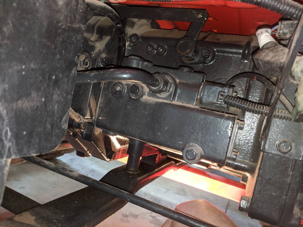

My 2016 DK5010 Hydraulic Shuttle has started to pop out of forward gears in low range on flat or up hill. I can hold it in gear with one finger on the shuttle. Strangely, downhill is fine as is high range.
The local dealer wants me to bring it in and I will one day, and they warned me (kindly/wisely) they will likely have to split the tractor and that operation is 15 hours labour plus repairs. My warranty ran out a couple weeks before I reported the issue and Kioti has no grace period. I figure this will be a $2k to $3k repair.
Question to you wise gentlemen,. Any guesses as to what my problem likely is in light of the up hill, down hill difference in symptom?

In your case, I suspect that it's either the fork as well or a bad synchro for the forward.
Is there anyway to adjust the linkage for the shuttle shift lever? Some tractors have adjustments on those that can be done externally.

There is an adjustment on the shuttle handle but that has no bearing on the linkage arm into the side of the transmission case (attached photo). It is so close that likely a 1/16" adjustment would probably solve the issue if it could adjusted, at least in the short term. The difference of a 5 degree grade has me baffled as well. Is something loose on its shaft?
Any tips in the EX50 shop manual? Forgive me for hijacking the discussion. IMG_20200714_131400.jpg

Wondering if the bolt that locks the fork on the shaft is loose and the fork kinda moves around loosely.
