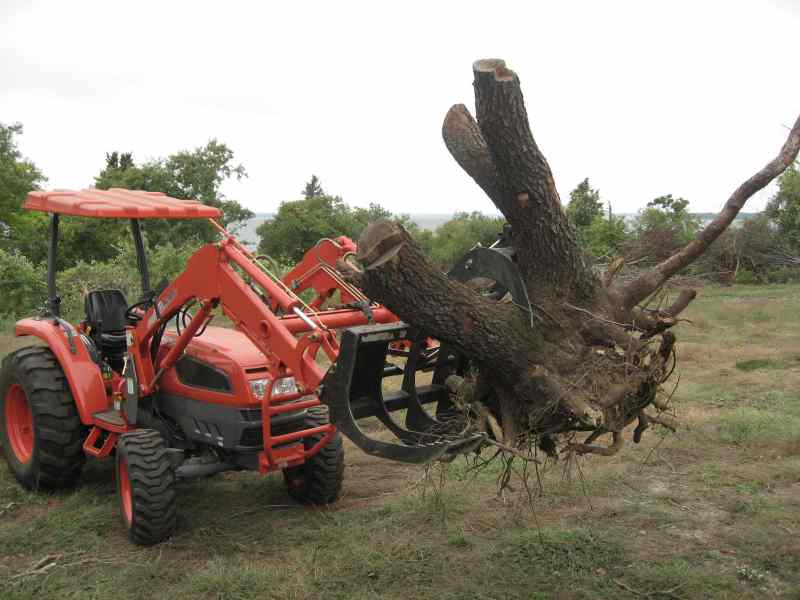

Easy decision for me. DK45se plus grapple (or other extra implement) will get more work done than a DK50se. No need for extra power you really won't use. Not sure what tires you will get but my R4s are the limiting factor in how much power I can use. I can spin all four, so traction, not horsepower limits what I can do.
I had faced a similar choice with the DK40se vs DK45se. Identical tractors and engine except for 2.0 vs 2.2 liters displacement. I couldn't see paying Kioti an extra 1500 bucks to bore out the cylinders a tad more. Never regreted the choice. If I ever upgrade to a cab model I might get the DK45se just to make up for the A/C parasitic load but the 40 is just fine without the cab.
