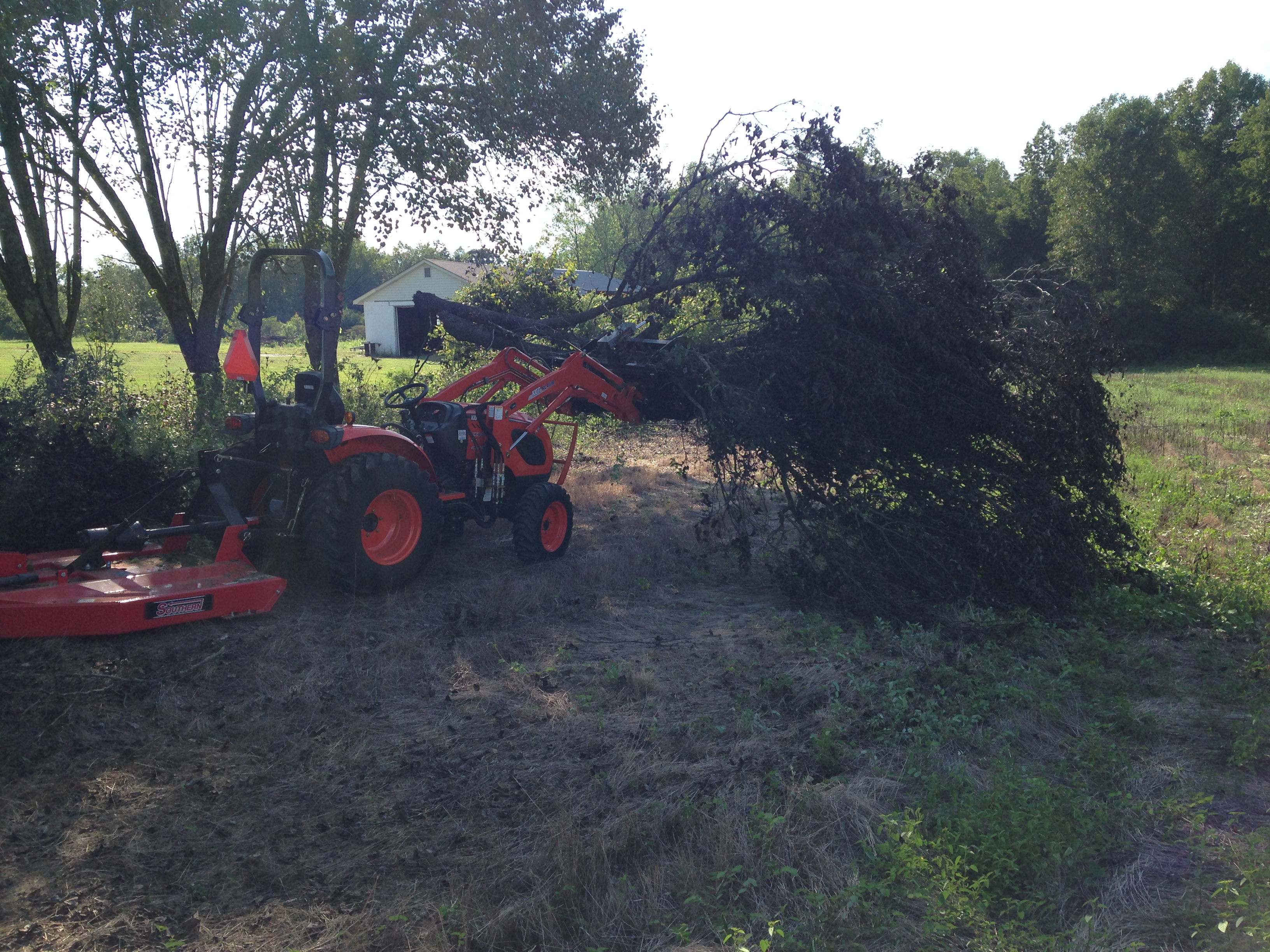

Great choice! That is a beast of a tractor! Here is my CK4010HST with a 66" Tomahawk Grapple. Yours should be able to grapple a small church.

How does yours do with saplings and such? My ground is WRP planted 12 years ago but the same year it was planted we had one of those 100 year floods which seem to happen about every 5 years. It is thick meshes of maple, ash, cottonwood and other such trees in certain areas. Most in that 1-3 inch range. I hope to be able to just sink the grapple teeth a bit and rip them out as I push. That's the hope anyway.
   / DK5010 vs NX4510 HST both with loaders and rear remotes #17
Sorry, but the site wouldn't let me re-post until I had five post so here is what I was going to post
Let me mention a thing or two that I failed to on my first post. For what you are doing the the Hydroshuttle should do what you want (since you are an experienced tractor operator) without lost pto hp or burned up clutch discs from loader worker. Second I wanted to go with a 54" Grapple and my dealer talked me into the 66". I was hesitant but became VERY thankful afterwards. The smaller Grapple would not have been able to do nearly as much work. I would recommend a 78" grapple for your or no less than 72". Your loader lifts @ 800 more lbs than mine and the work that I have accomplished is incredible. Make darn well sure you have the thing ballast well, use a heavy rear implement and drive off with the load backwards for safety. Grapples get things done! As to your question, I have not done that (uprooting) yet but will in a few weeks at a different part of my land. You should have very little problem up rooting the small seedlings up to 3 inches though especially with the power of your tractor. Just don't get a running start or you may bend the grapple.
