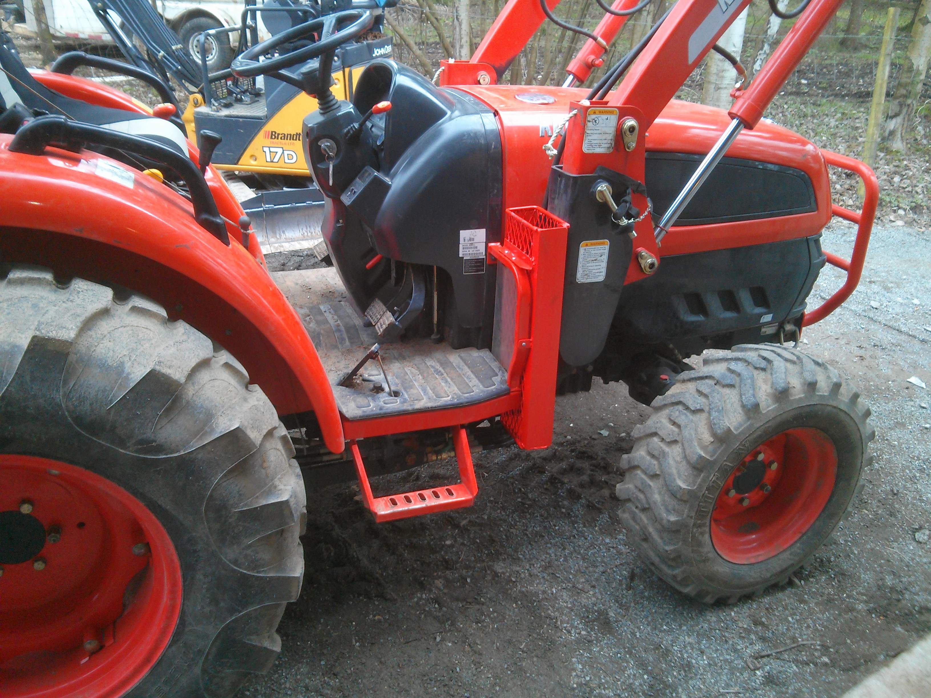

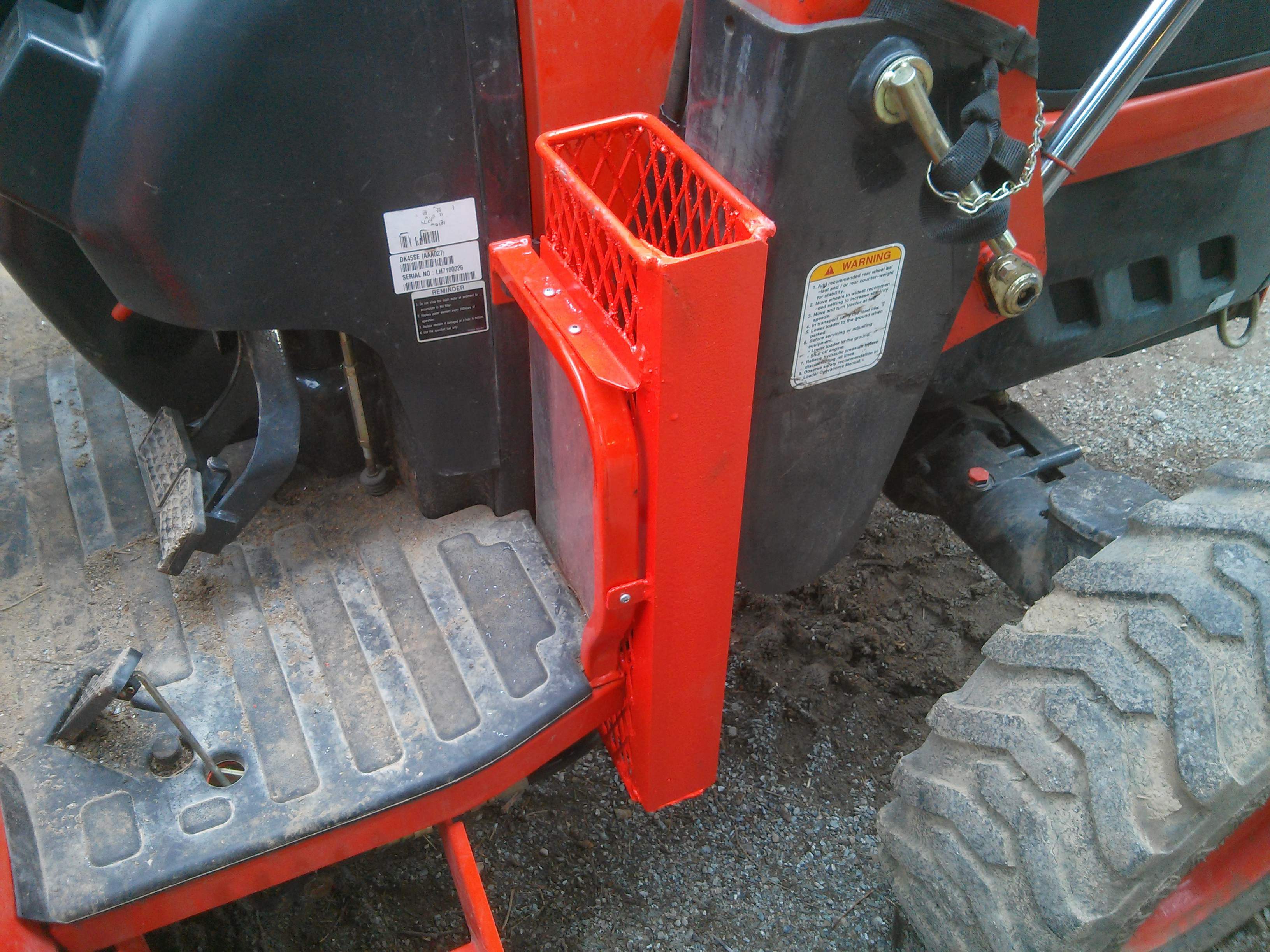

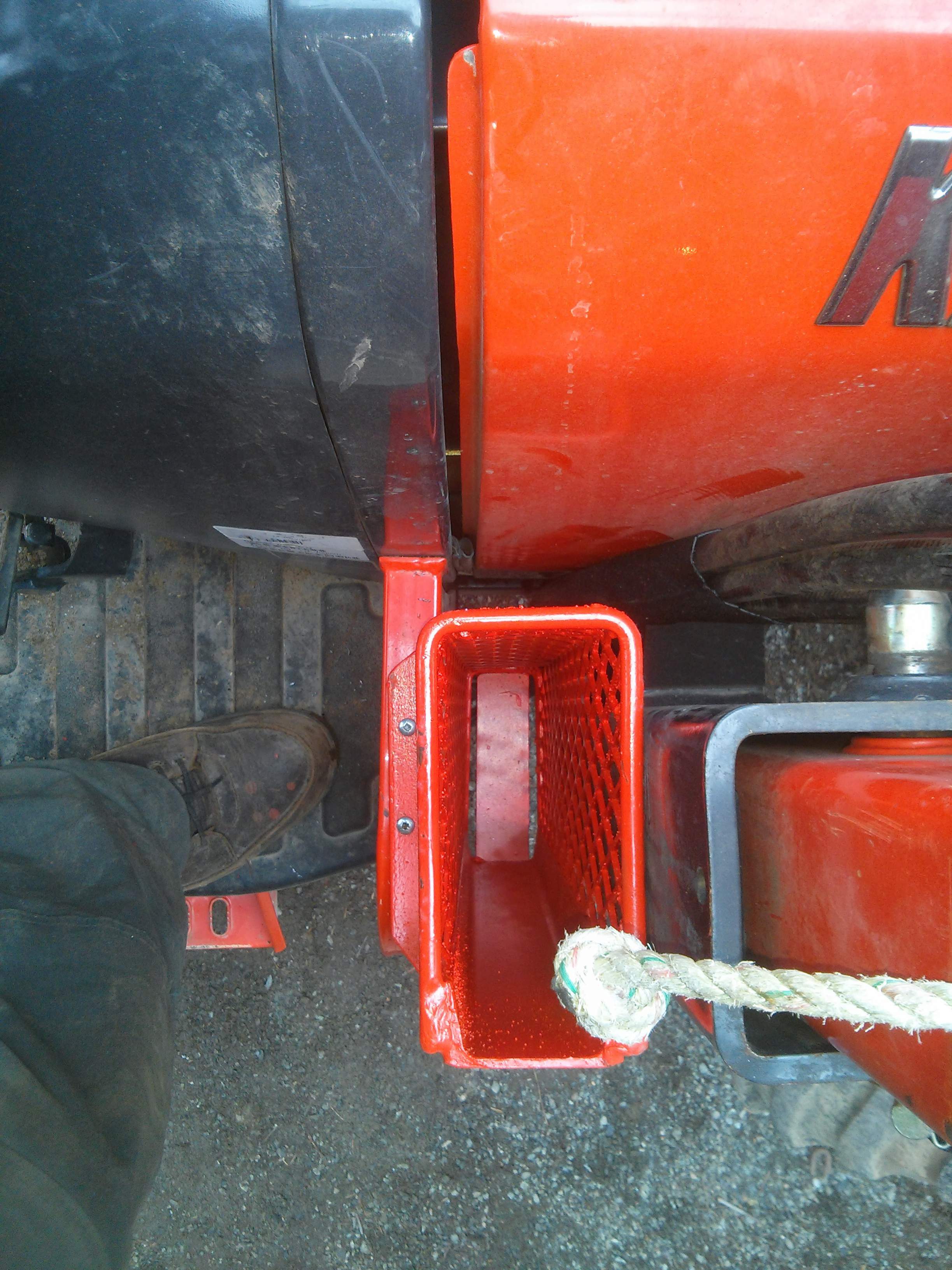

Some shots of a tool holder I welded up. Previously I had one made from plastic pipe much like some others have made. My mistake was using thin-wall pipe. After a year of use and a couple repairs it became clear that thin plastic pipe would not stand up. So I made a metal tool holder.

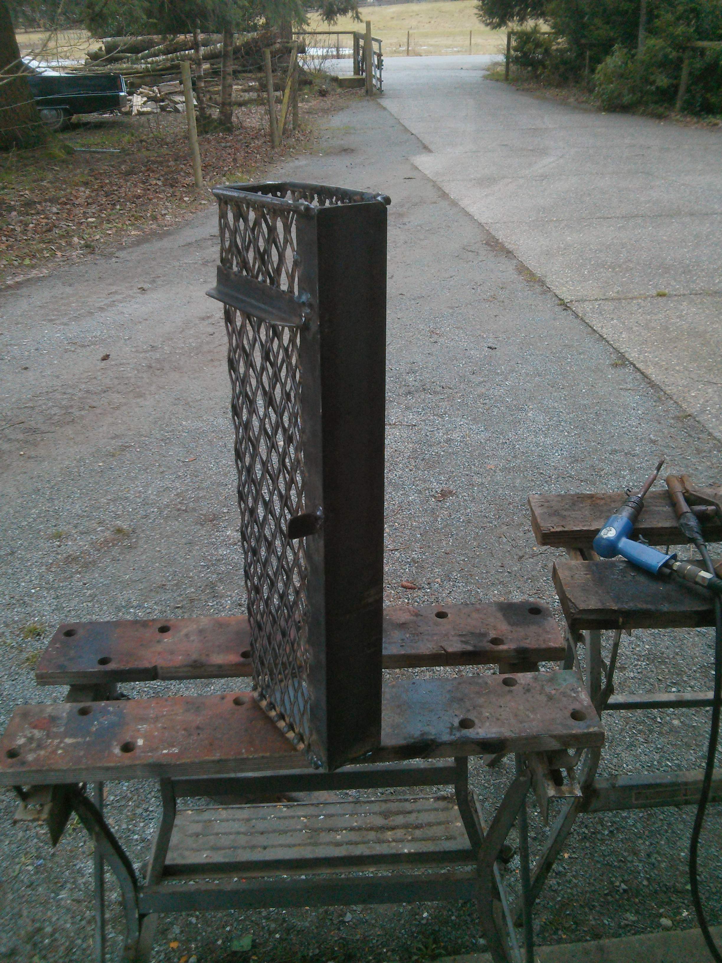

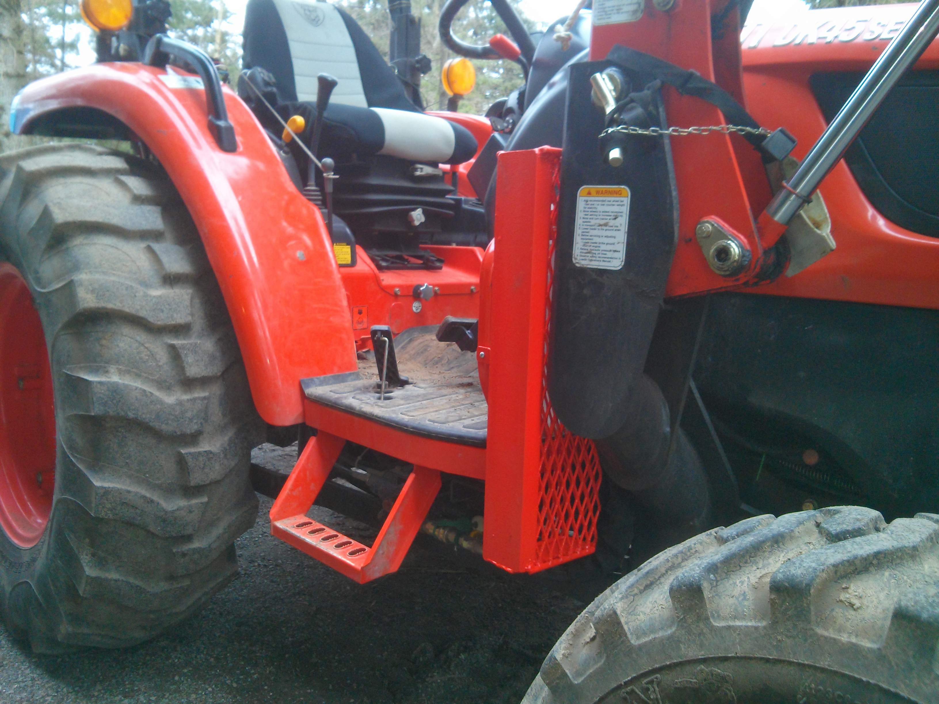

Height - 24", opening size approx 3" x 7". The expanded metal is 9GA, the vertical solid member is 3"channel. At top and bottom are stiffeners bent out of 3/8 round stock. The bottom is 2" x 3/16 flat which leaves a space each side for dirt & water to go through.
The paint used is shown, it was a very good colour match I thought. Also is very good paint, I have used it for years.

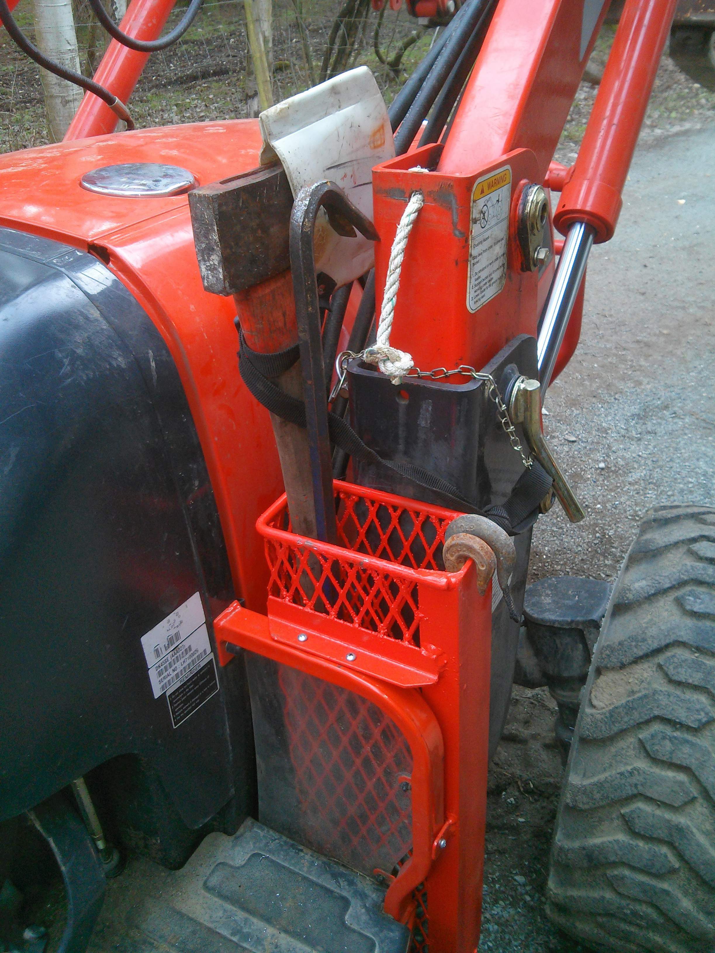

The axe sheath in the last photo is homemade from PVC pipe warmed with a propane torch and moulded to fit the axe head. There are lots of youtube videos on how to do this.

good idea and great execution.

I like...heavy duty!
What is that short hank of rope hanging there for?

The rope is a handhold for those who jump onto the side of the tractor for a short ride to the next work spot. (Their other hand grabs the factory grip on the fender) I didn't want to make a proper metal handhold because the safety police around here might not like it, but a guy can tie a chunk of rope onto his tractor if he wants! I did not want a loop because that could be hard to let go of.

Baaaahhhh, weld a handle on there anyway!

OK, busted! It only took a minute to put the rope on and it got the job done that day!
