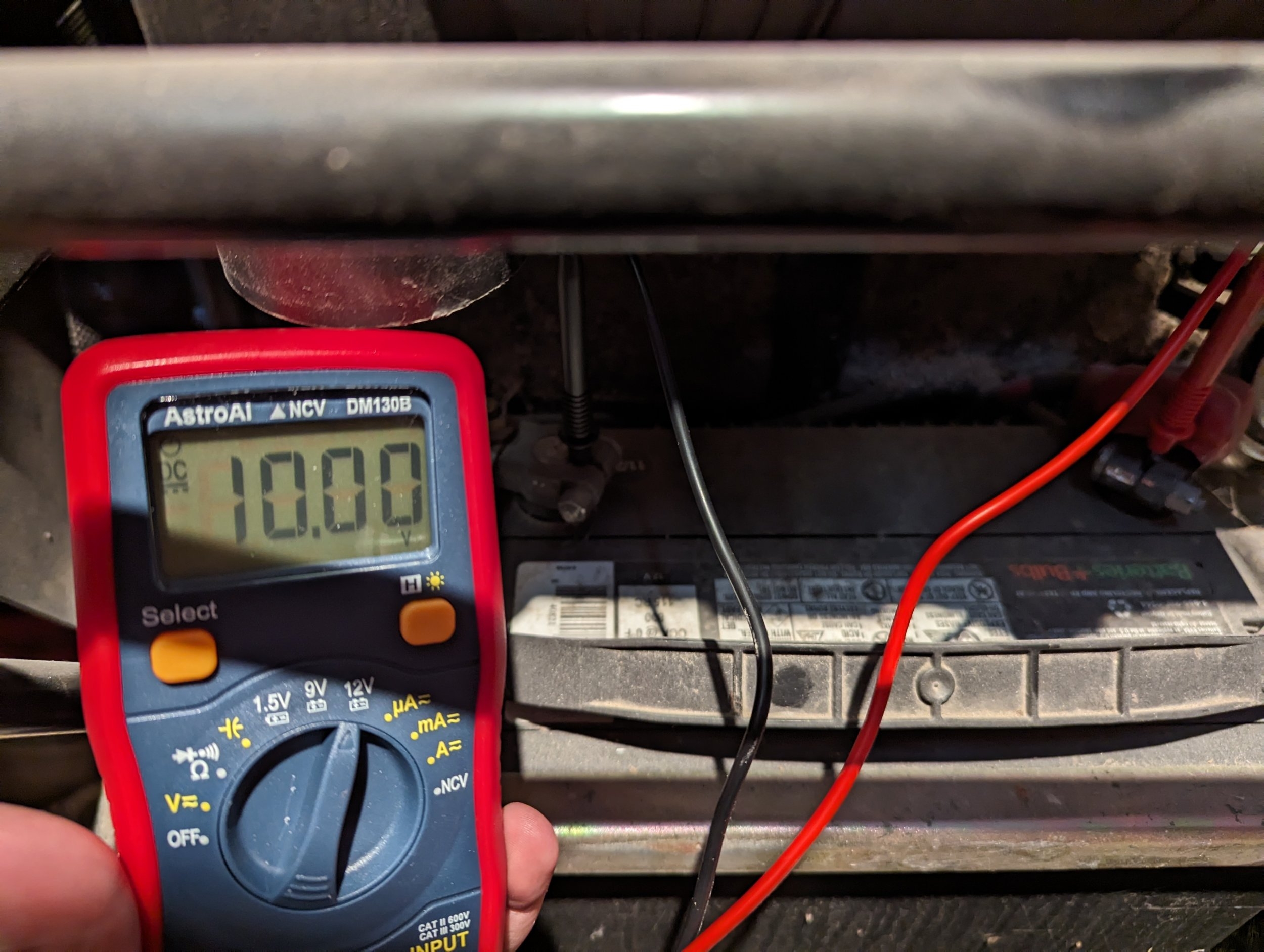

Yup, I have a charger/starter. I hooked that to the battery when cranking which caused the clicking. Let me grab a video of it and post which might be helpful for troubleshooting as well.
   / DK45SE Starter doing machine gun imitation
So looks like 10V at the battery
   / DK45SE Starter doing machine gun imitation #8
You don't seem to be charging at all
   / DK45SE Starter doing machine gun imitation #9
Bingo. And since the solenoid started clicking only with the charger/starter hooked up, this strongly suggests your battery is either severely discharged (hopefully) or simply bad. Is it possible that you inadvertently left the key switch in the accessory position after the past use, and drained the battery down? I've done that before with my NX. :oops:
I'd disconnect the battery first (to rule out a parasitic drain), then put the charger on it long enough that it should be fully charged if good. If the voltage still doesn't come up to 12.5 or 12.8, suspect your battery.
Pain in the rear, but I'd pull the battery out and have it fully load-tested before spending much more time on this problem.
   / DK45SE Starter doing machine gun imitation #10
Also, as Murph notes, you might not be charging properly during operation. One quick thing to check there is the tension on your alternator belt. Trying to rule out the simple stuff.
