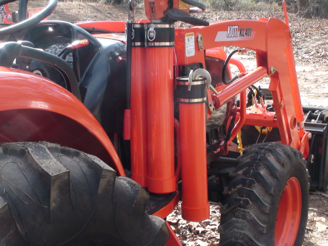

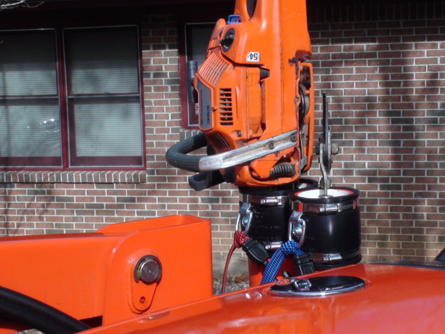

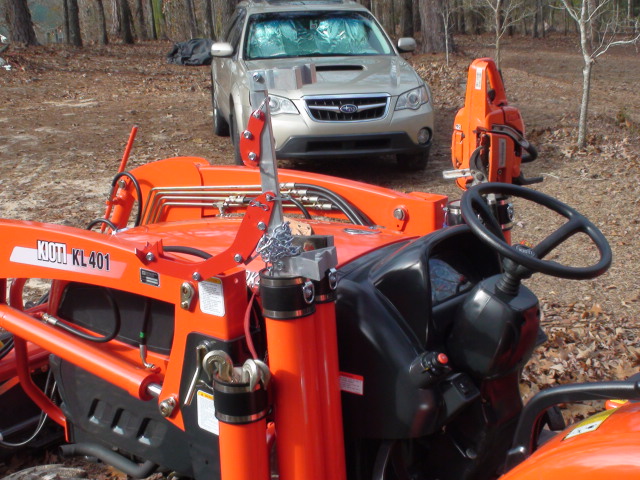

I looked all over for a commercial method to mount my chainsaw, including ATV mounts and found nothing that was simple, easy to use and fool proof. I like your idea. I need to carry a lot of tools with a goal of storage flexibility for the many various items I am using to clear my new home site. I also have a Dewalt DCS380M1 reciprocating saw coming for cutting large roots that should "mount" in one of the 4" tubes. Here is my setup.
View attachment 354470View attachment 354471View attachment 354472View attachment 354474
If I had things to do over, I might replace one of the inboard 3" and 4" tubes with a single 6" that would carry tools with a D handle.
Looks awesome, getting ready to make some of these. How did you mount the tubes to the tractor?
/ DK45SE chainsaw holder #24
The tractor is 35 miles away at the moment and I would have to look to be certain. But as I recall, I used a piece of flat plate for the bottom mounting piece extending from the outside of the existing orange square stock across to the other side. I seem to recall I anchored the other end with a piece of angle. I use bolts for everything (no screws) so think I must have through bolted the angle piece also at the hood area but it was difficult to access, I seem to recall. Had I been able to weld at that point in time I would have made a one piece bracket extending across the bottom. (Now have a Miller 211 MVP). The top mounting for each tube is simply through the existing square, orange tubing.
The only difficult part was getting the carriage bolts inserted through the inside of the tubes prior to mounting the tube to the framework. I finally came upon the idea of inserting a string through the outside of each mounting hole and using gravity to allow it to drop down through the tube to a point I could grab it with my hands, tie it to the carriage bolt and gently pull the string back to the hole and the carriage bolt with it. At this point I needed to hold the string taught with one hand to keep the bolt aligned inside the tube at the bolt hole and then with the other hand used a piece of wood to then force the carriage bolt inside the tube through the hole far enough I could grab it from the outside of the tube with my other hand and pull the bolt through. Sounds more difficult than it was once you figure out out how to do the first one.
Be careful when making the hole in the tubing. The hole size needs to be small enough to capture the square end of the carriage bolt to keep it from turning when you tighten the nuts, yet large enough the bolt can be pulled through with the string still attached.

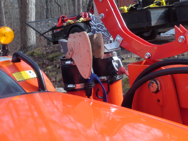

Can you tell me what the purpose of the rubber coupler at the top of each tube is? Does it extend above the tube to act as a cushion, just curious.
Thanks
/ DK45SE chainsaw holder #26
Thanks
Yes, exactly. It keeps the top of the tube in good condition. The 4" couplers are a bit scared up from the chainsaws bucking teeth. Had the couplers not been there, the tops of the tubes would have been a mess by now from all of the different things carried.
