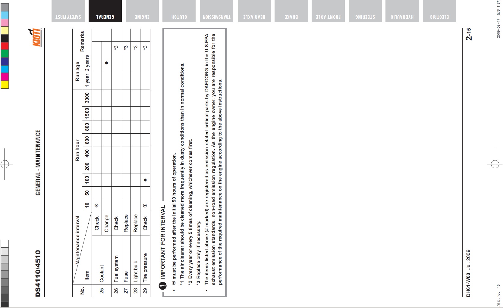

Looking at the service manual, the 200 hr service looks quite simple: Check a few things (like tire pressure) and change the fuel and transmission oil filters.
   / DK4510 200 Hour Service Questions #8
Looking at the service manual, the 200 hr service looks quite simple: Check a few things (like tire pressure) and change the fuel and transmission oil filters. <img src="http://www.tractorbynet.com/forums/files/kioti-owning-operating/438556-dk4510-200-hour-service-questions-ds4510-1-jpg"/><img src="http://www.tractorbynet.com/forums/files/kioti-owning-operating/438557-dk4510-200-hour-service-questions-ds4510-2-jpg"/>
Don't forget to check and tighten every accessible bolt, especially those mounting the FEL and BH subframe.
