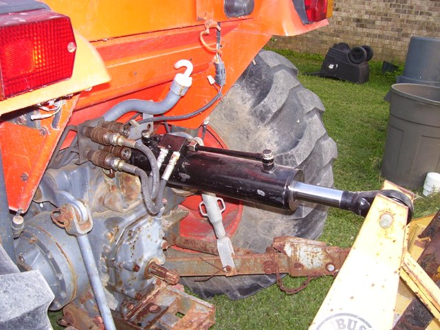

I would like to put in a hydraulic top link for my DK45. What's the correct size and type of cylinder? I'm thinking 3"x10"x1.25' (18.25" - 28.25").

Got it installed. I had to buy a 3/4" - 1" bushings and actually had to grind off a little bit off the side of the eyelet to get it to fit. Now it works like a charm. As you said, I have to watch it a bit but I finally begin to get the box blade to behave the way I want.

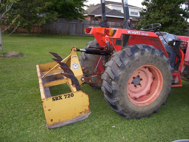

I have a DK45se with a backhoe. I am curious about the hydraulic top link that you are discussing. What is a hydraulic top link? I have two hydraulic hoses in the back of my tractor that are hooked up to my backhoe. Are those hydraulics what you are talking about? :confused:
I am new to tractors so I have a good excuse for my dumb question. ;)
/ DK45 Hydraulic Top Link #11
The standard top link is replaced with a hydraulic cylinder. With a hydraulic top link you can make adjustments to attachments on the 3 point from your tractor seat while on the go.
Makes a huge differance when working with attachments like boxblades, backblades, Etc.

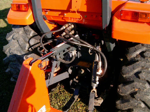

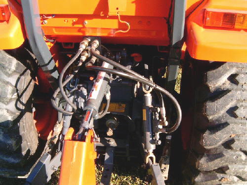

Here's my oversized top link. It's a lil big but it works fine for me. I don't have the side hydraulic cylinder so no tilt for me yet.
