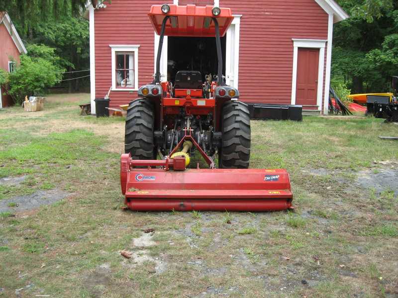

Island or anyone else who might not mind - could you you measure the width of your DK40SE tractor from tire to tire.
Trying to get an idea of whether one can get by with a 5ft bush hog (probably not) and a 5.5 ft snowblower (probably).
   / DK40SE width with industrial tires #2

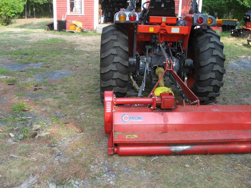

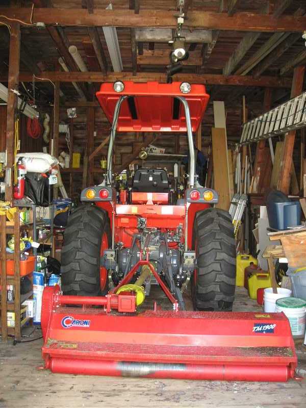

I'll measure accurately this weekend if the weather holds....however I am pretty sure it is over 60 inches and under 65 inches. Here are some photos from the rear with a 75 inch flail mower. The left side is flush with the mower. I'll let you do the trig/math.;)
I would buy a 6ft cutter if I were buying new but if I already had a 5ft brush mower I think it would be fine.

I was wrong. It measures 68 inches from outside of R4 tire tread lugs. It would not fit through a 68 inch gate as the tires bulge out another couple inches on each side but the foot print is 68 inches wide.
