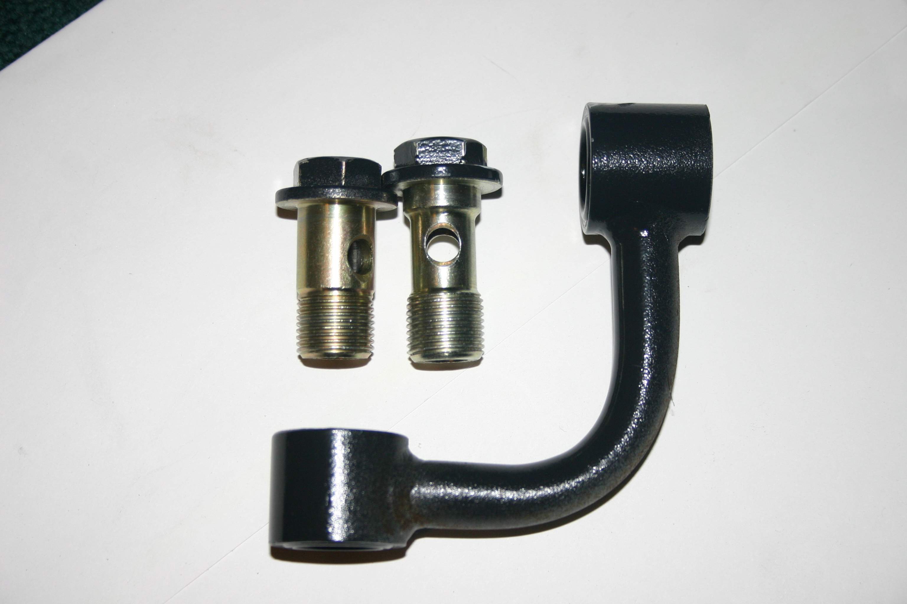

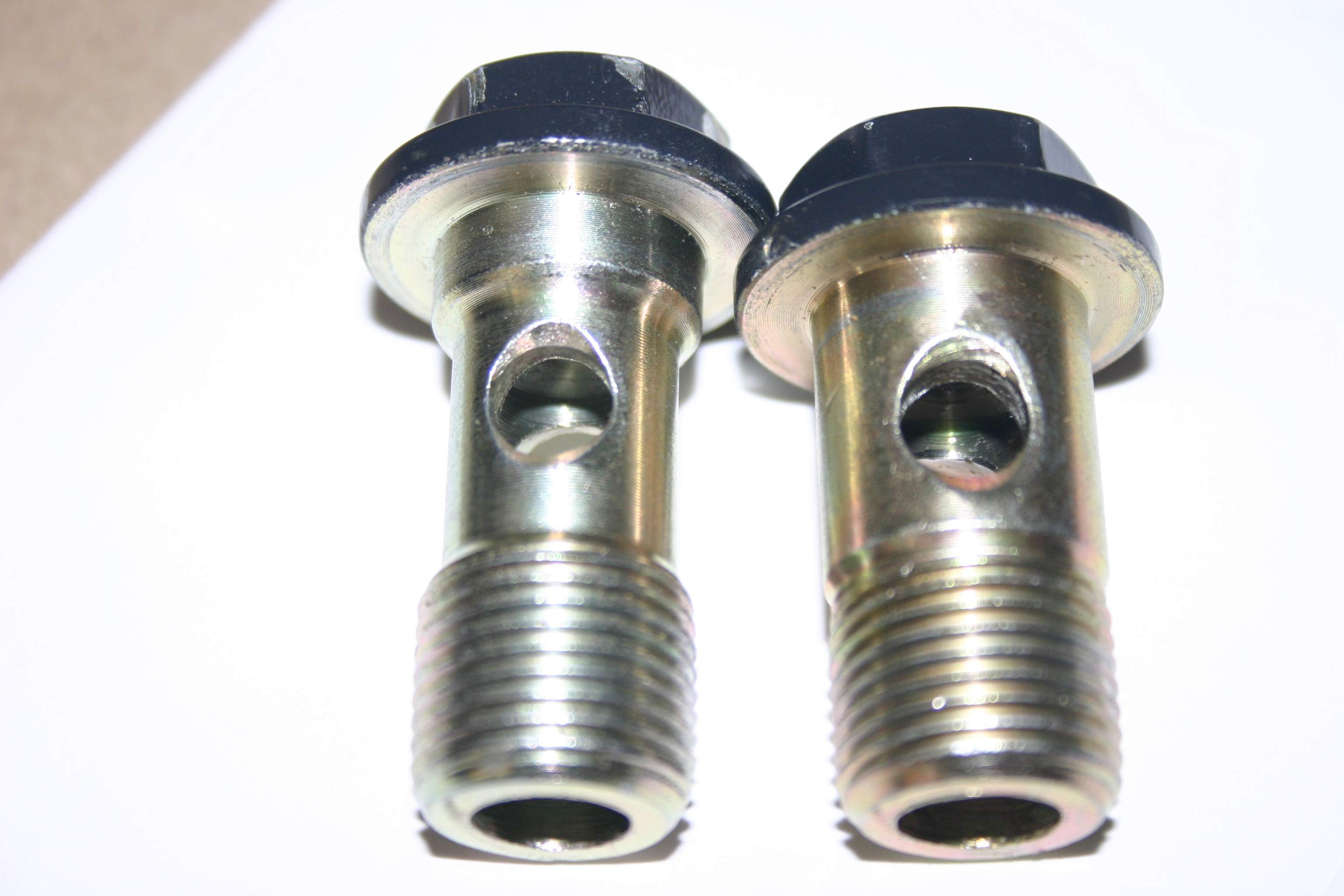

This is not finished or over and I am waiting for parts for the final conclusion but here is what I have so far.
The HST pre-charge pressure is supposed to be 255 PSI. The pressure is supplied by the secondary pump (power steering circuit) and controlled by the charge relief valve in the HST. I found the charge pressure low 205 PSI as per the manual I went looking for a restriction. I measured the pressure at the output of the power steering and found the pressure to be high about 450 PSI. This is indicative of a restriction or leak between the test point and HST. I traced this all the way to the HST filter.
So I bit the bullet and replaced the new (about 50 hours) HST filter. I know its expensive and I did not want to do it but man there is a restriction so what else could I do. So I did it and was I pissed to see it was still the same. High pressure before and low pressure after. GRRRRR.
In a last ditch effort I decided to try and test the pressure at the HST. This is very tricky as the connections are hardline banjo fittings. So I removed them and what to my surprise. Why is this banjo bolt different than the rest. Why is this bolt not tapered down like the others to improve flow (see attached photo). Could it be.... off to the hydraulics shop to build a test rig to check the pressure. Ouch those metric fittings are expensive but this should work.
Armed with some shiny new fittings I connected the filter to the HST including a test tee to may handy pressure gauge. Fired up the tractor and wow..... the pressure is 260 - 270 PSI right where it should be. Warm it all up and check the charge pressure and relief valves. Just like the manual says right on the money. Perform the tasks to get the squeal but wait its not there. Call my new best friend to spread the news.
So it would appear that is the bolt specified in the parts manual but wait. That was not always the part (the restricted banjo bolt). There is an ECO (engineering change order) that modified this part. I wonder when that went into effect. I would bet right about or before the time our tractors were built. The banjo fitting is about 2.5mm shorter on the filter side (were the new bolt was specified) and the new bolt is shorter. Ok so they wanted a shorter banjo bolt but somehow the new bolt did not have the taper to improve flow (see the attached photo).
Now its time to exercise the tractor. Remove the test equipment and hookup some implements. After over an hour of abuse no noise. I can usually get the squeal in about 5 minutes at low RPM's and in this heat get constant squeal in less than 10-20 minutes of work. I have it down to a science.
So in conclusion this is not over and the engineer in me is still looking for proof and answers. Still need to show the correct bolt vs ECO bolt pressure differential but I have to wait as its not in stock. So for now I can avoid my shiny new tractor being split in 2 and see how things progress. Repeat "Small things cause BIG problems" or "Simple things cause Complex problems" or ...
So how are your pressures? Do you have the mystery banjo bolt in the top of your HST filter? I hope this inspires you to check and not just blindly trust other will. At the very least ask. Don't be afraid to ask questions and make sure you understand the answers. Most people who understand are glad to give you an explanation. The ones who don't usually get angry and take your inquire as a challenge to there ability.

AWESOME!:thumbsup::D;) I'm certain you have found the problem! I can see how the lack of machining of the shorter bolt would make it want to squeal like a stuck pig! And, if it wasn't the problem wouldn't the squeal have returned like it did after you did the first HST filter change?
I'm curious, how are you able to find things like the ECO's and such, and get the side by side pic of the two bolts in question?
What are your thoughts on the possible damage(s) that might have occurred in the circuit with the higher than normal pressures, due to the restriction?
Can you site part number(s) for the correct bolt so those of us who have the squeal can get the new bolt in place?!
I'm still in shock- this is/ was the thing that kept me from being able to really like my new tractor, and wish I had stuck with my DK-35 with no squeal!!
Your 'proof' can be further verified by kattywumpus getting a bolt in place on his 'squealer'. Repeatability is certain to satisfy the engineer in you, right?:)
I'm going to my dealer tomorrow to 'demonstrate' the squeal. I will review your post with him in detail and have them pull the bolt and see what it looks like.
Will report my findings.
CM Out.

Now seeing that this squeal only effects a small group of tractor I imagine they ordered (or manufactured) the proper high flow bolt and started using it. For those of us unfortunate few we get the temporary fix. Now nobody eve gives it a second thought because how could such a little difference like that cause all this trouble. Repeat "little things cause BIG problems"
I will not be satisfied on my end until I can put a gauge before the filter and verify the flow restriction. A problem is not solved until you can prove the cause. Who knows I may find a leaking banjo fitting with the other bolt but I have a fix for that!

I don't know what the correct part number is. I have not received the parts I need to finalize the fix ( not expected until late next week. I ordered both the ECO specified bolt (incase its different than mine) and the bottom bolt which is what I plan to install. You will not find this in your service manuals. You will find schematics, diagrams and some details of how it functions but no parts details. You need the parts manual for that.
From what I understand Kioti has a bypass kit that replaces the banjo bolts and hard line. This is their solution to the problem and what I believe kattywumpus has on his tractor. This is a dealer install only item so you need to bring your tractor in for service. Even after discussing and providing the details that I shared with y'all I was assured I am not qualified to install the parts. This must be done by an authorized Kioti service technician. I don't have the details of the kit but I am working on getting them. kattywumpus can you post any details or pictures???
I currently have my own version of a bypass installed with fittings made up from my local hydraulic shop. Once I have the new bolts and a parts manual I will post what works for me. This may not be what Kioti recommends so please check with your dealers.
I am happy to report after many hours of hard work with the tractor I have not heard a single squeal. I am noticing some very faint chirping and whirring though. The chirps occur while accelerating or traveling uphill mostly going forward. Reverse is scary quiet. I don't recall hearing this before but its hard to say cause I don't recall listening for it. I can also here the gears whirring now and I don't recall that before. Maybe it was masked by other noises because it seems much quieter all around in the cab. This may just be paranoia or over sensitivity after the 7 Month ordeal with the squeal. The sounds are not loud at all actually they are quieter than the power steering and loader circuits. I just hope this is normal and not a sign of damage from the 100 hours of restriction, low flow and cavitation.
Tom

If you can't wait then here are some details of the fittings. The banjo bolts are M18x1.5 thread. I used M18x1.5 to #10 JIC with #10 JIC fittings on a hose. The hose is rather long though as I use it for testing and did not custom fit it to application. Make some measurements. Remove the banjo bolts and hard line (see attache photo). Head to you local hydraulic shop and get some parts. If you do this please post pics of your bolts and hard line.
I don't plan to keep this setup and will reinstall the hardline with the new banjo bolt. If the pressures are correct and no squeal then I will publish that part number. To piece together a bypass kit will cost you over $100. The bolt is $10 and a simple swap with minimal oil spill.
