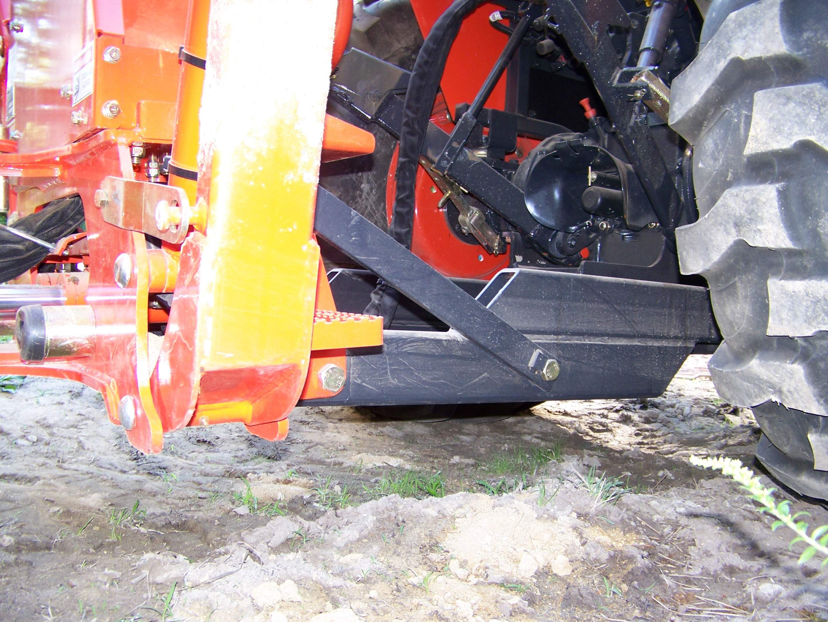

Unfortunately I did not get the results I was hoping for. The dealer stated in an email the issue was fixed and it is not. If anything it gotten worst, it now starting to make the very loud squeal going forward. The squeal appears to occur when going forward down a slope in addition to doing it in reverse. To get an ideal how loud the squeal is, my wife could hear it from in the house with all the windows closed, with the TV on, and the tractor about 300 feet down the driveway.
To add insult to injury the dealer mounted the backhoe sub-frame upside down. The sub-frame on this backhoe is designed to give additional ground clearance by lifting the backhoe about the frame. By mounting it upside down the ground clearance is reduced. There is a clear mounting diagram in the backhoe manual.
On top of that the dealer want to charge me close to $400 for 50 hours service, keep in mind most of these hours came from them running the tractor to troubleshoot the problem. There have been other issue too, for example when they were off loading the implements at my house using the FEL they swing the scrape blade into the tractor hood. The dealer did replace the hood, but it been one screw up after other. I have lost confident in this dealer ability to provide good service. I may have no choice but to get a third party involved to get this resolved. Most likely this is the last time I will purchase anything with Kioti on it.

Make sure you have the backhoe re-mounted. It isn't intended to be mounted in that position.

Wow, I am speechless...Is this the kind of Kioti dealers that are replacing me?
Come on..... put a subframe on up side down:ashamed:????????????

As I stated in my email, you want to make sure that the vents are clear of mud and open. Does it make the noise when the backhoe is not installed and plugged in? You have to add a vent to the case on the left upper side so that you do not pull a vacuum in the case when running hydraulics or HST. Do both of the backhoe lines connect to the remote valve couplers? or does one connect to the filler tube? Standing on the left rear of the tractor can you post a picture of the rear case and remote valves including the filler tube?
If he installed the sub-frame wrong he may have messed up on the hydraulics installation as well.
This is not normal, these HST tractors have been relatively troublefree since introduced several years ago.

The backhoe sounds normal and works great other then the subframe being upside down. Yes, both of the backhoe lines connect to the remote hydraulics. I will work on getting a picture. The only other thing I can add at this time is when the sound gets really bad it appears there is more vibration on the reverse petal. Thanks for your reply. I really do appreciate it.
PS: sound occurs in reverse, coming to a stop (both forward and reverse petal released) and now when going slowly forward down hill. Doesn't seem to matter if the backhoe on or off.

You have to get that dealer to install that backhoe properly. The hydraulic lines are also not installed correctly. I normally would not say anything about another dealer, but this is not a very good representation of us who strive to do things right. Check with your dealer and have him check with Kioti on the correct installation of those hydraulics. The return line must be routed into the return tube with the kit supplied with the backhoe and a new vent has to be installed in the side of the case to the left of the top link mount. This may not help the HST noise but it will allow your hydraulic system and backhoe to work properly.
If he cannot fix it call Batchelder Sales in Lebanon, ME, excellent service department and they are fairly close to you.

I really appreciate your feedback. I see in the manual were IN-OUT hose kit install instructions are. The kit was not installed and I don't have the parts. Trying to get accurate information from my current dealer has been difficult from the moment I reported the sound issue on the 3rd day of ownership. Also manager's behavior towards me raised many red flags and started me wonder if his motives were something other then solving the problem. It seem like in his opinion I was always doing something wrong, not running the engine at the correct RPMs, not using the draft control correctly, just a few examples and he would make these assumption based on were I last left the controllers. I sure my frustration with this behavior sometime came out in my posting in this issue, but until this latest issue I still tried to be understanding and work with them.
Needless to say I have loss confident and trust in this dealer. I'm even starting wonder if the year of the tractor is correct, he originally told me it was 2010. Later someone told me it was 2009 based on the serial number. I have started discussing the issues with Batchelder Sales.
