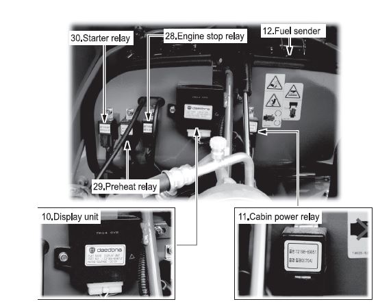

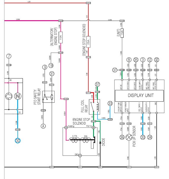

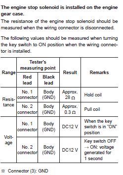

Does the fuel shut of solenoid operate? It works this way, it has 2 coils, a pull coil and a hold coil. The pull coil pulls over 20 amps for 1 second, a timer is started in the display unit and the timer controls the fuel shut off relay on the firewall. The relay drops out after one second, and the second winding on the fuel shutoff solenoid which draws less than an amp and is powered thru the key switch buss holds the solenoid operated. The fuel shutoff solenoid is located on the front of the injector pump.
The relay that operates the pull coil is notorious to fail. The oreilly part will work fine. It will never fire a lick if the shut off solenoid is not operated. If the fuel shut of relay on the firewall does not operate the solenoid, then no fuel will flow in the injector pump because the shut off solenoid is not operated. Makes some checks and get back with us.
outside firewall.JPGfuel and display module.JPGfuel solenoid.JPGfuel solenoid chart.JPGOrielly start and fuel relay.JPG
/ DK40SE HST No start - fuel problem? electrical? #3
Oh, the start relay (left most relay on the firewall) and the fuel shutoff relay (rightmost on the firewall) are the same relay, and you can swap them. If it wont crank anymore if you swap them, then you will know the relay is bad, or you can take voltage readings. The glow plug relay is bigger and is the one in the middle.

Only three electrical things effect mechanical Diesel engines like yours: (1) the stop solenoid (SS) which must retract (or be removed) before the injection pump (IP) can deliver fuel (2) glow plugs which must be powered to start a cold engine, and (3) the starter. It is obvious if the starter cranks (not the problem here), Glow plug power is easy to check with a voltmeter between chassis ground and the bus bar across the tops of the glow plugs. The bus bar should read near the battery voltage with the key in on AND crank. Finally, you should be able to hear the stop solenoid retract and also hear if it drops out after the one-second timeout (e.g. hold coil not working).

<img src="http://www.tractorbynet.com/forums/attachment.php?attachmentid=420868"/><img src="http://www.tractorbynet.com/forums/attachment.php?attachmentid=420869"/><img src="http://www.tractorbynet.com/forums/attachment.php?attachmentid=420870"/><img src="http://www.tractorbynet.com/forums/attachment.php?attachmentid=420871"/><img src="http://www.tractorbynet.com/forums/attachment.php?attachmentid=420872"/>
Thanks to all. I will be doing a relay check first and will see what happens. Unfortunately i work away during week so it will be the upcoming weekend.
Just to clarify (thx for the pics k0ua) - the relay most prone to fail is the display or the fuel stop?

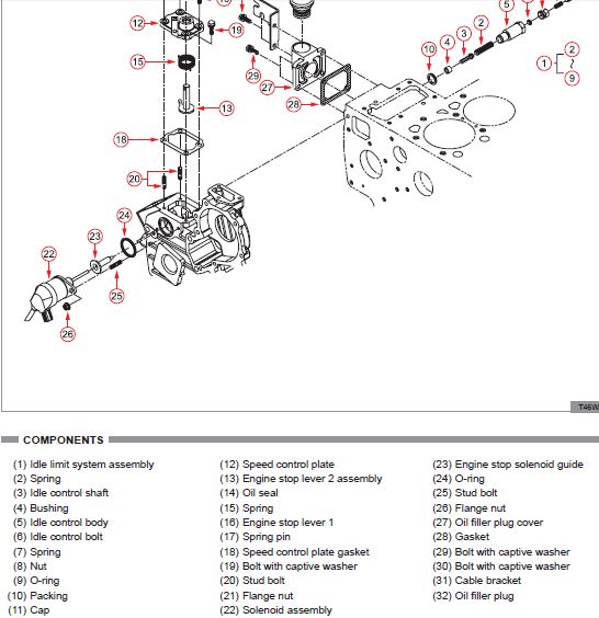

I have never done it. but I think it is easy. Just a nut on a stud. But did you take a voltage measurement? There are 3 wires, a common and the pull wire, should be energized for 1 second, ( 12 volts and high current ) and the hold wire should be energized continuously from the key buss (12 volts but very low current.)

As you observed there is a pronounced clack then the pull coil retracts the stop solenoid. But there are also at least two relays that operate at about the same time (one for the pull coil and one for the glow plugs) so the source of second sound you heard may not be obvious.
Before you disassemble anything, thy this: turn the key switch to "on" when you should hear the stop solenoid retract plus maybe a couple relays. Wait a few seconds and turn the switch off. At that point you should again hear the stop solenoid, extending, almost as loud as when you turned the key to "on." If not, there is a problem with the hold coil. The hold coil gets power directly from the key switch (no relay involved) so the problem is as likely to be the switch as the stop solenoid. The crude acid test is to unbolt and remove the stop solenoid from the front of the engine. That eliminates the stop solenoid as a possible cause of your no-start problem. You can also visually verify stop solenoid operation while it is removed just by watching the plunger as the switch is turned on and off BUT you need to jumper (or touch) the solenoid case to engine ground because the ground return for both coils is through the engine block.
The key switch has been a problem for many owners. In many cases, a couple shots of WD-40 or electrical contact cleaner into the key hole (followed by inserting and turning the key several times) will fix that problem, at least for a time.
Poor contact within the key switch can also prevent glow plug operation (I had that problem) with similar symptoms (no start when engine is cold).
You can also check the stop solenoid operation (by feel) using the manual stop linkage without disassembling anything. With the engine off you should feel very little resistance (just the return spring) when you operate the manual stop lever. With the key switch "on" (and the stop solenoid retracted) you should feel a little additional force on the manual lever because it is pushing the injection pump rack back to the full aft position.
You probably observed some of this when you removed the "oil fill" plate. By the way with that plate removed you should be able to visually see the injection pump rack pin move from the full aft position to the full forward position (and stay there) when the key is turned to "on". That's another way to check the stop solenoid.
So the next step (after charging) is to verify proper stop solenoid operation.
