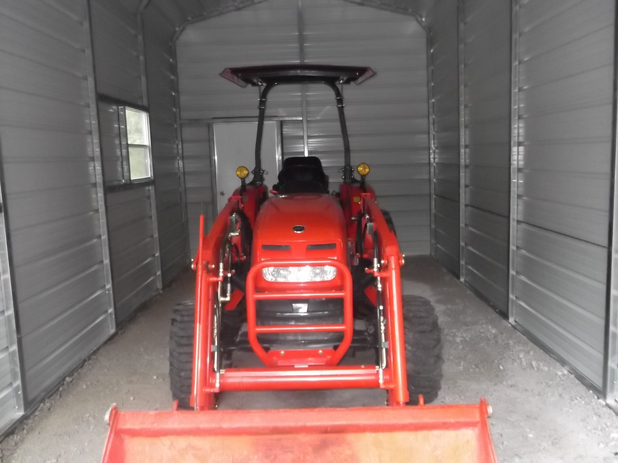

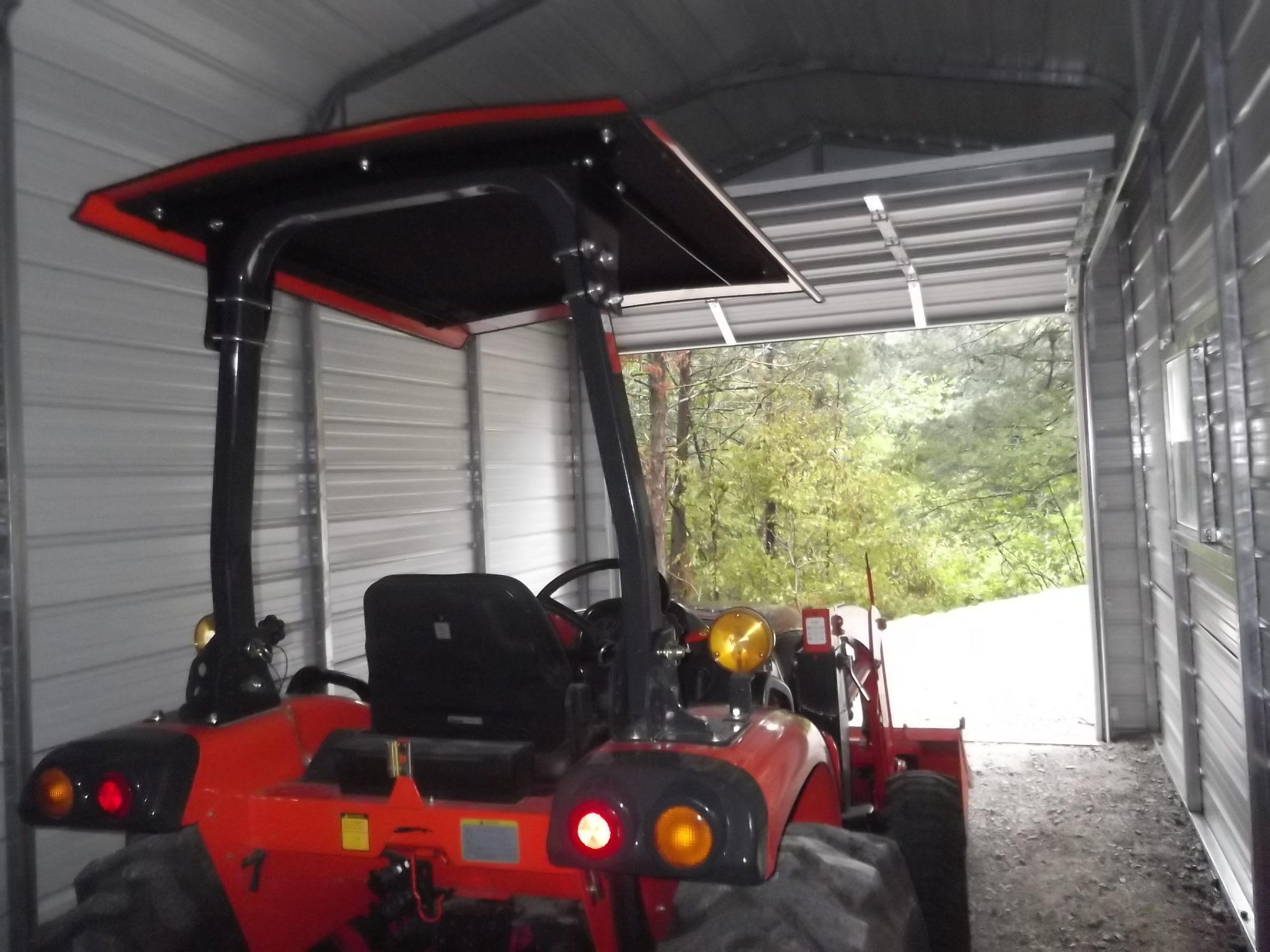

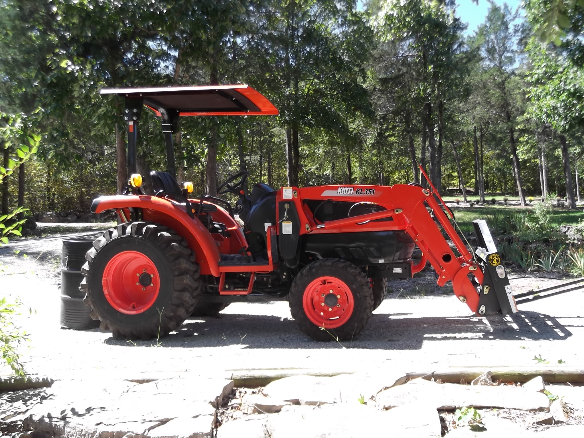

Koua, how much height does it add to the ROPS? I know the dk40 is an inch or two under 8'.
Very little.. an inch?

Then it should fit in a 8' garage door opening. On kiotis website, the ck35 is taller than a dk.
I have that exact canopy on my DK-40 and it JUST fits under an 8' door, and I mean JUST! I removed the lower handle off the inside of the door so there is less chance of the canopy hitting on the way into the barn. I had to adjust the canopy while the tractor was in the doorway so as to get it to clear with the most amount of clearance. It's a critical adjustment, AND if you get snow you CANNOT allow any build up in front of the door outside or it will raise up the tractor/canopy and possibly result in damage to both door and canopy. YMMV.:confused3:

My door is a theoretical 9 foot so its actual opening is 8 foot something.. So I have lots of clearance.

Here are the actual heights: Canopy at top, front, above dash cluster: 8'3". Overhead door at floor to max opening: 8'6" So, a bare minimum of 3" clearance. Note: that is with R4 industrial tires, and my KB-2485 backhoe on as well as my plow on the front. The hoe probably makes for 1" of the 3" overall clearance, meaning if you do not have a hoe mounted you might only have 2" clearance total.....

CM, thanks for taking the time to measure. I'm not certain Kioti has the right measurements they list on the website for the dk40. 95", 96.3" for the cab.
