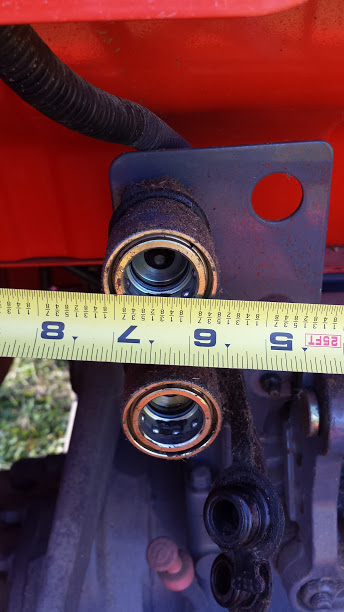

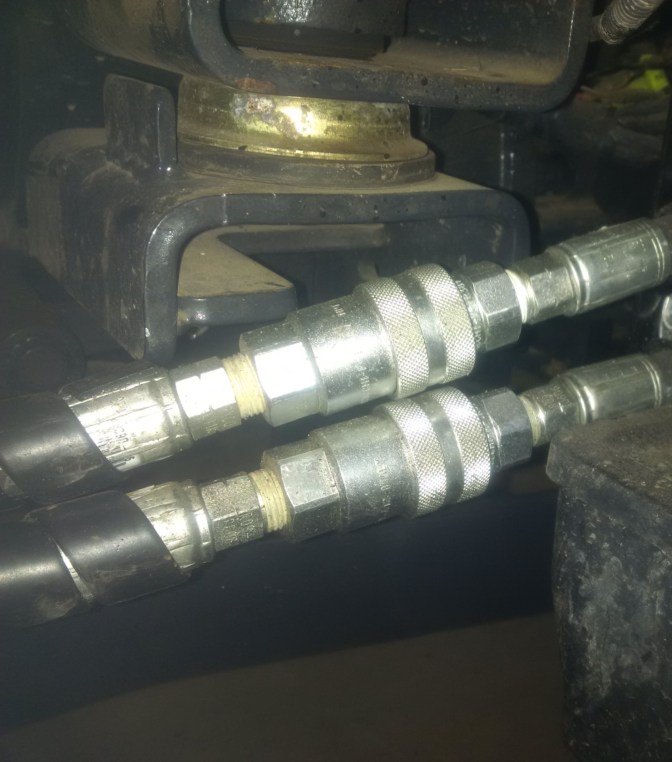

I've read in here that the rear remotes are 1/2" Just wanting to double check with a picture of mine and a tape measure. I bought a grapple and need to have hoses made up for it.

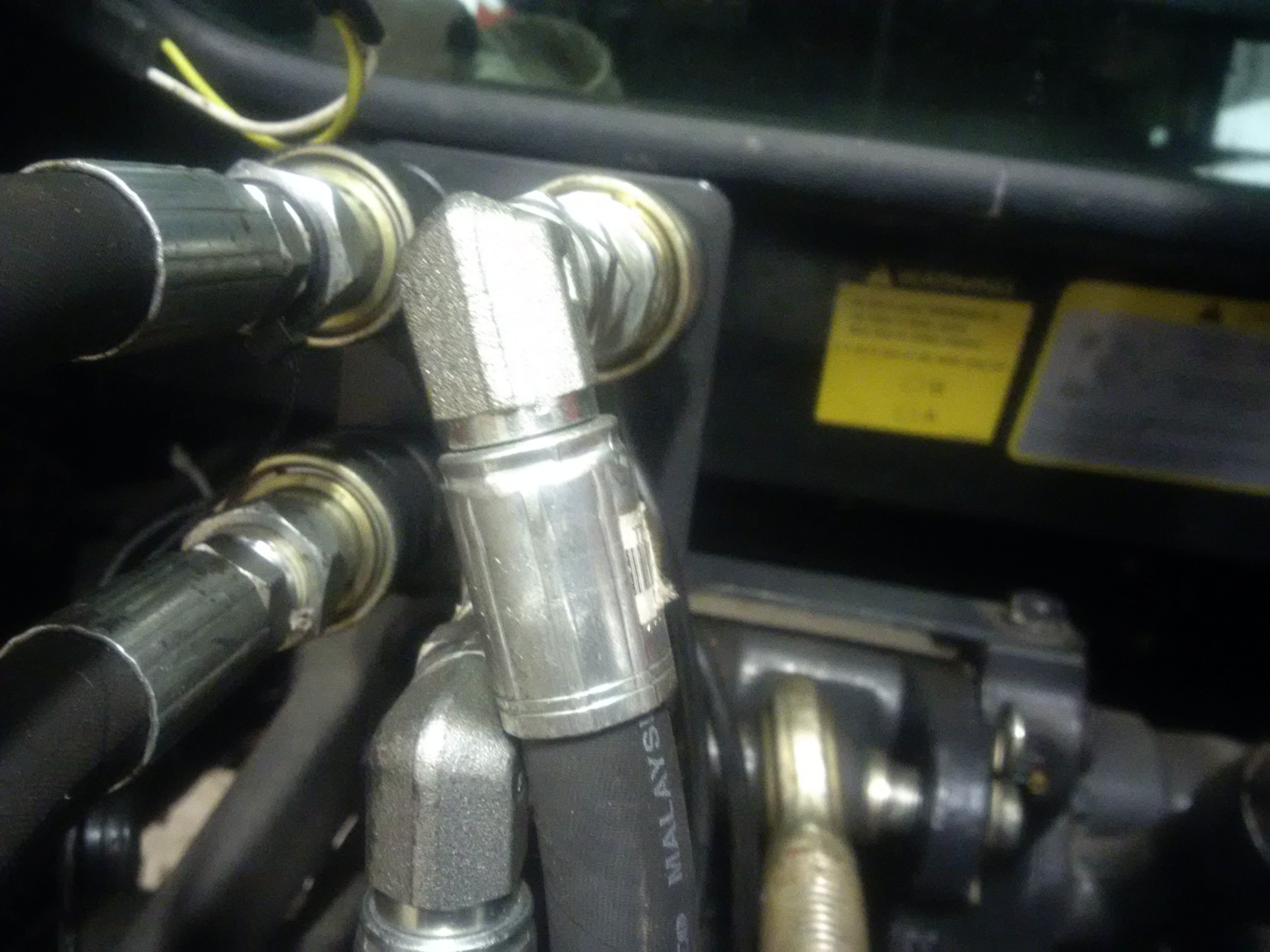

Yes my DK 45SE Hyd remotes are 1/2 pioneer type, the FEL are 3/8. Remember to have 90 degrees fittings for the the rear hoses. 3/8 hoses carry enough volume for grapples and are easier to route.
/ DK40HSE hydrualic coupler size #4
I would recommend running 3/8" hose. Cheaper and easier to work with. Of course, you'll then need some adapters to go from 3/8" JIC (assume that's what the hoses will be) to 1/2" NPT.

Yep 1/2 inch AG type couplers. ISO 5675

EA's standard couplers would be AG unless you specify otherwise (other coupler option is flat-faced skid steer, at an additional cost). Rear remotes should also be (not sure if I've heard of anyone with anything else) AG. 1/2" for both.
I went with the flat-faced connectors as they are said to be better at keeping out foreign material when disconnected. At the very least look to get dust caps (need to install when/as you make connection to your hoses).

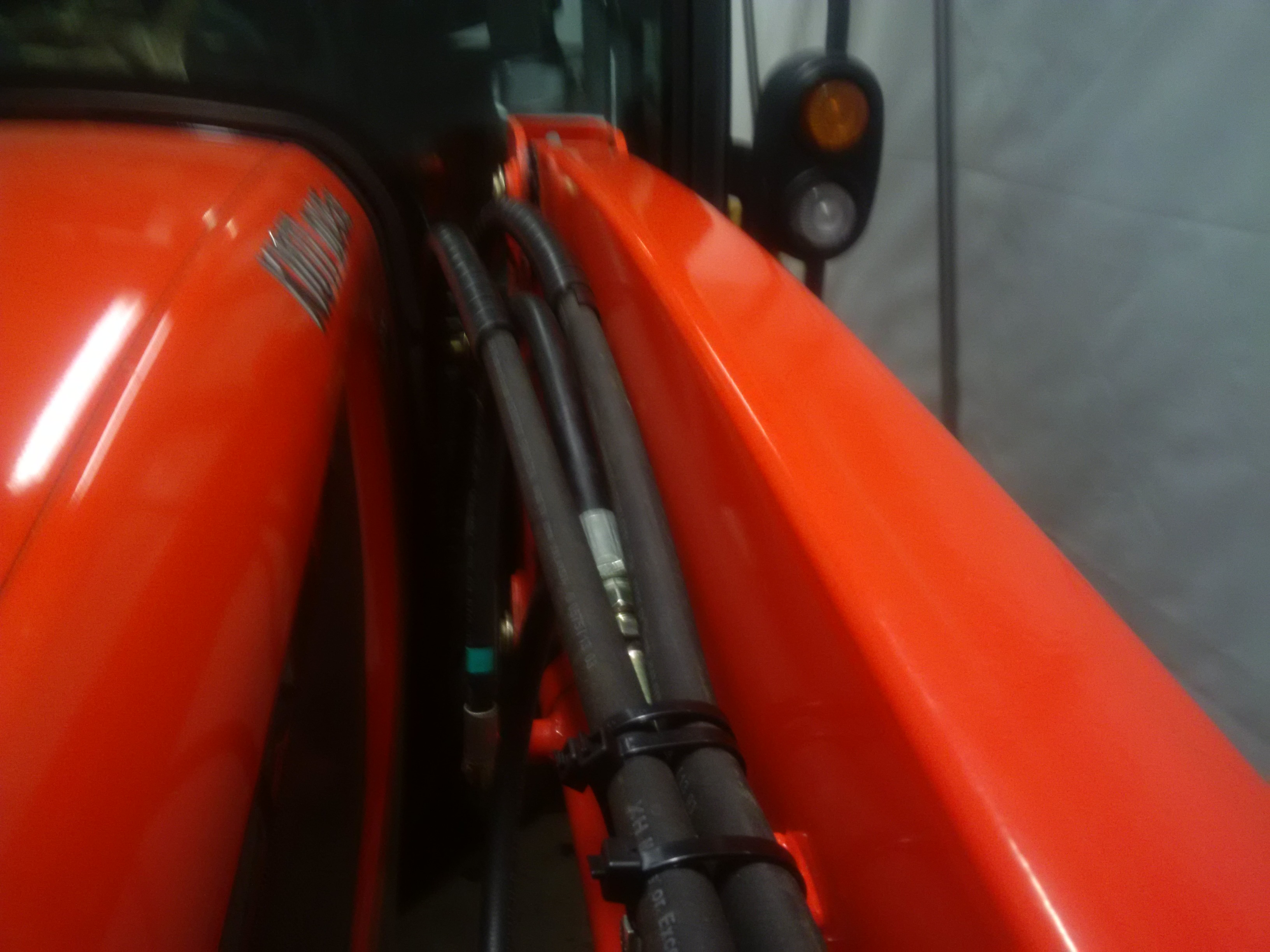

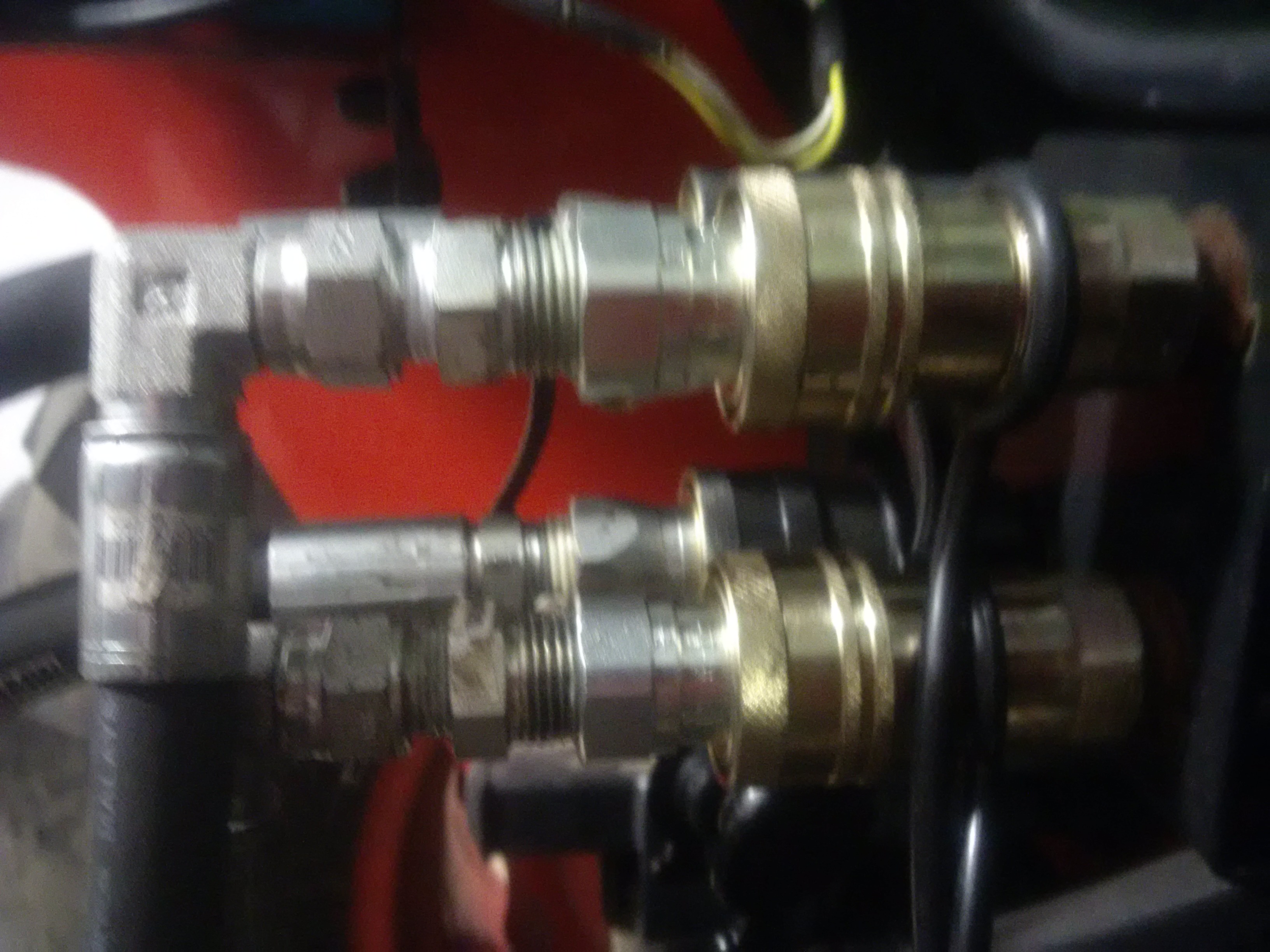

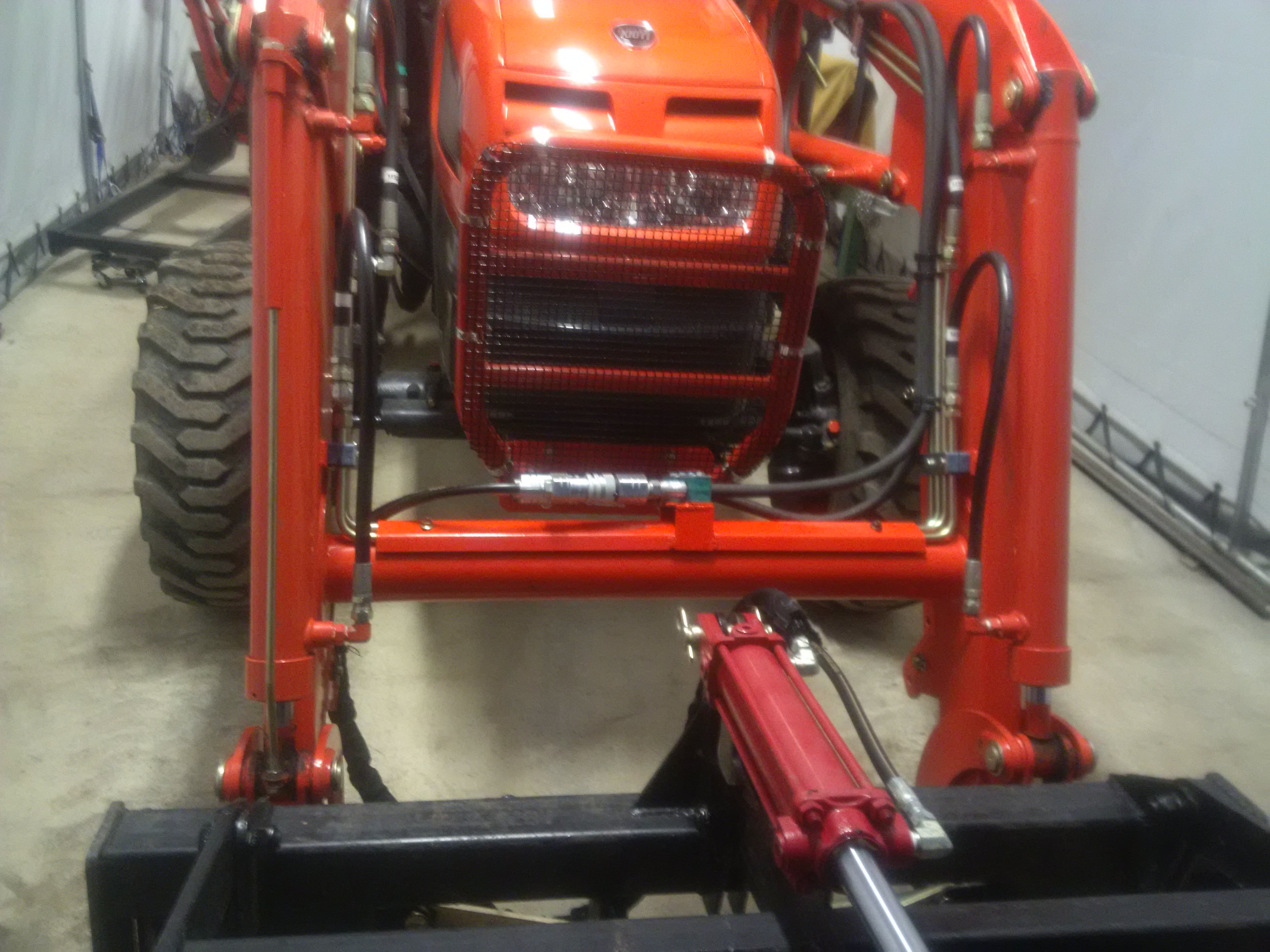

Reduced from 1/2 to 3/8 out of the QC. Hoses made with 90's.

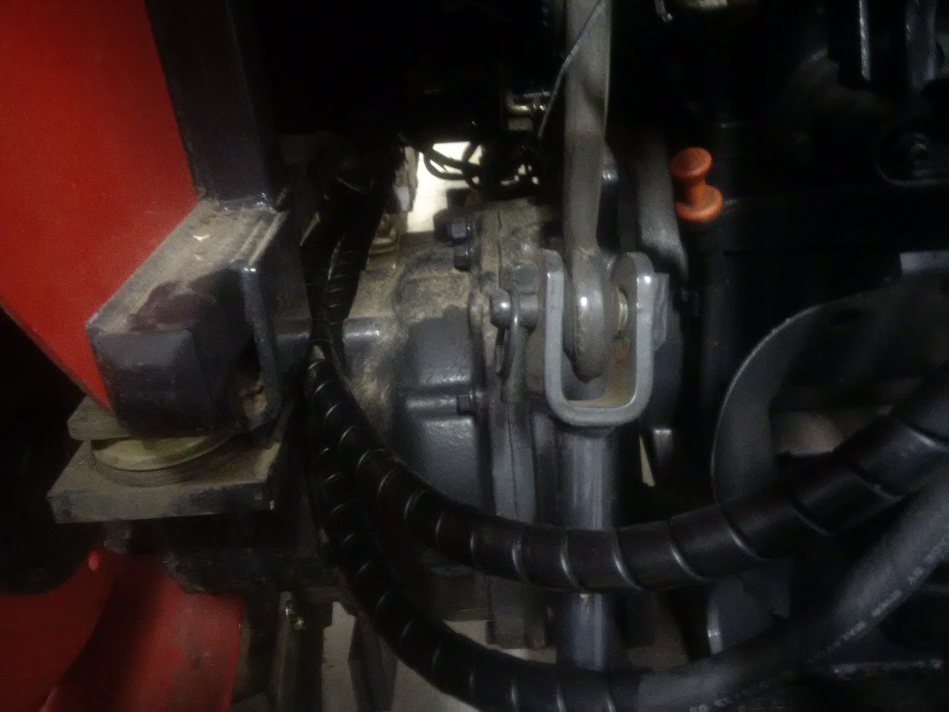

Ran hoses up the left side attached to cab frame and tool box bracket.

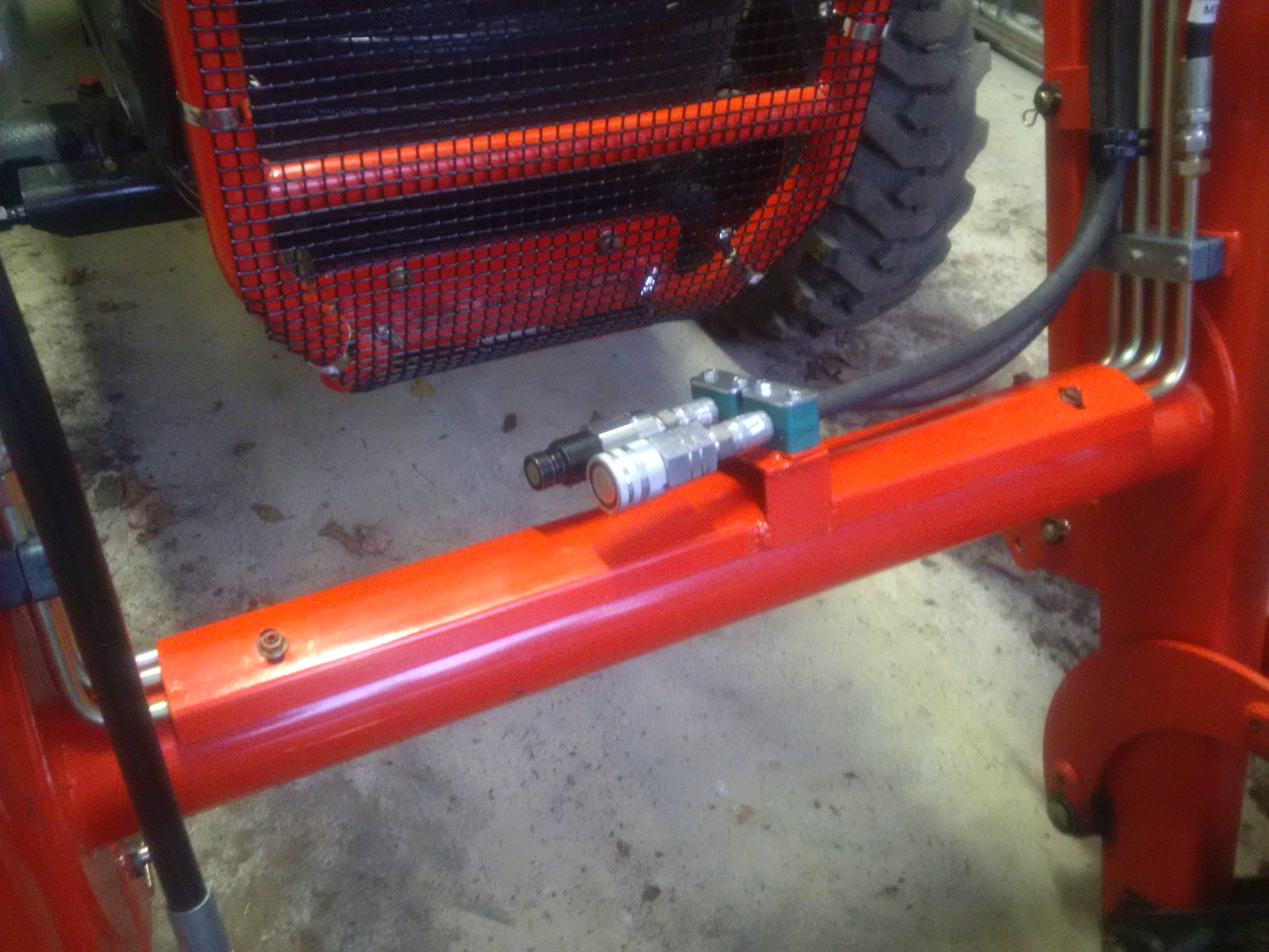

I added a set of QC in front of the tool box the hose was made with 3/8 NPT both sides here.
Up and along the loader arm similar to hoses on the right side.
The loader end of the hoses are 1/2 NPT.

Excellent job, GMIslander!
That's pretty much what I'm looking at doing (and running on the Left side too).
What is that wrap material? Any concerns that it'll trap stuff in it? (I'm trying to decide what hose protection to use.)
Oh! And I like your extra grill guard! I'd thought about doing something similar on my B7800 (but never got to it): I for sure want to do it on my Kioti ASAP. I also figured that having something that's not welded on would be good because at some point in time you're going to have to replace it.
