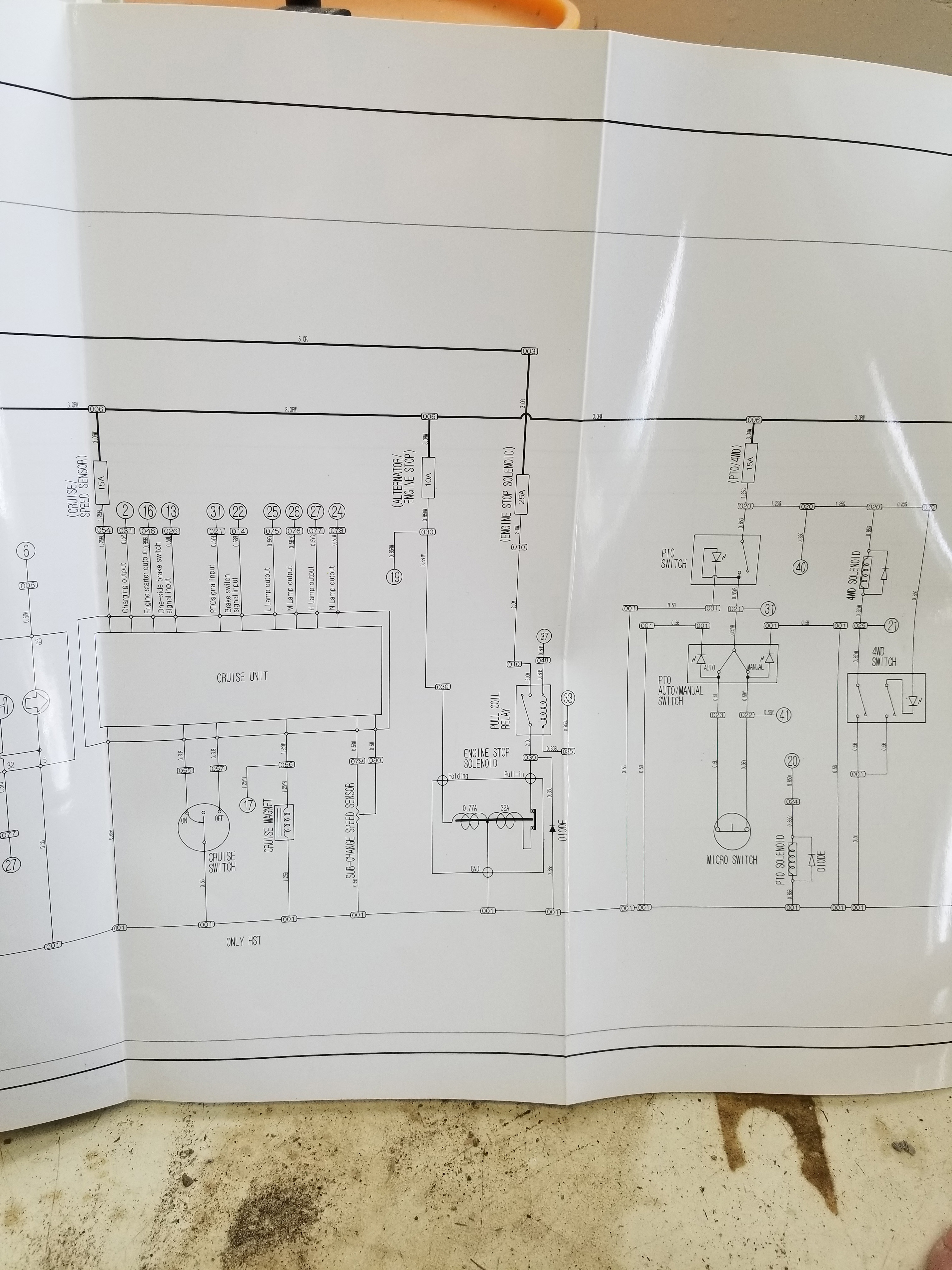

DK35SE 2012 model PTO will not operate. PTO and Auto/Man switch lights both work, PTO dash light does not work. No voltage is getting to the PTO solenoid. Micro switch on draft control works. 'No start' when PTO is switched on is working too. Possibly a broken wire feeding the solenoid? Casual inspection of wires looks good, all still in undamaged wire loom. Any ideas? Does anyone have a schematic for this model?
Also, leaving the solenoids connected and changing their location on the modulator the PTO comes on with activation of 4x4 switch, so the modulator and PTO clutches are working.

A proper schematic would be helpful. Dealer wanted just under $200.00 for the paper service manual.

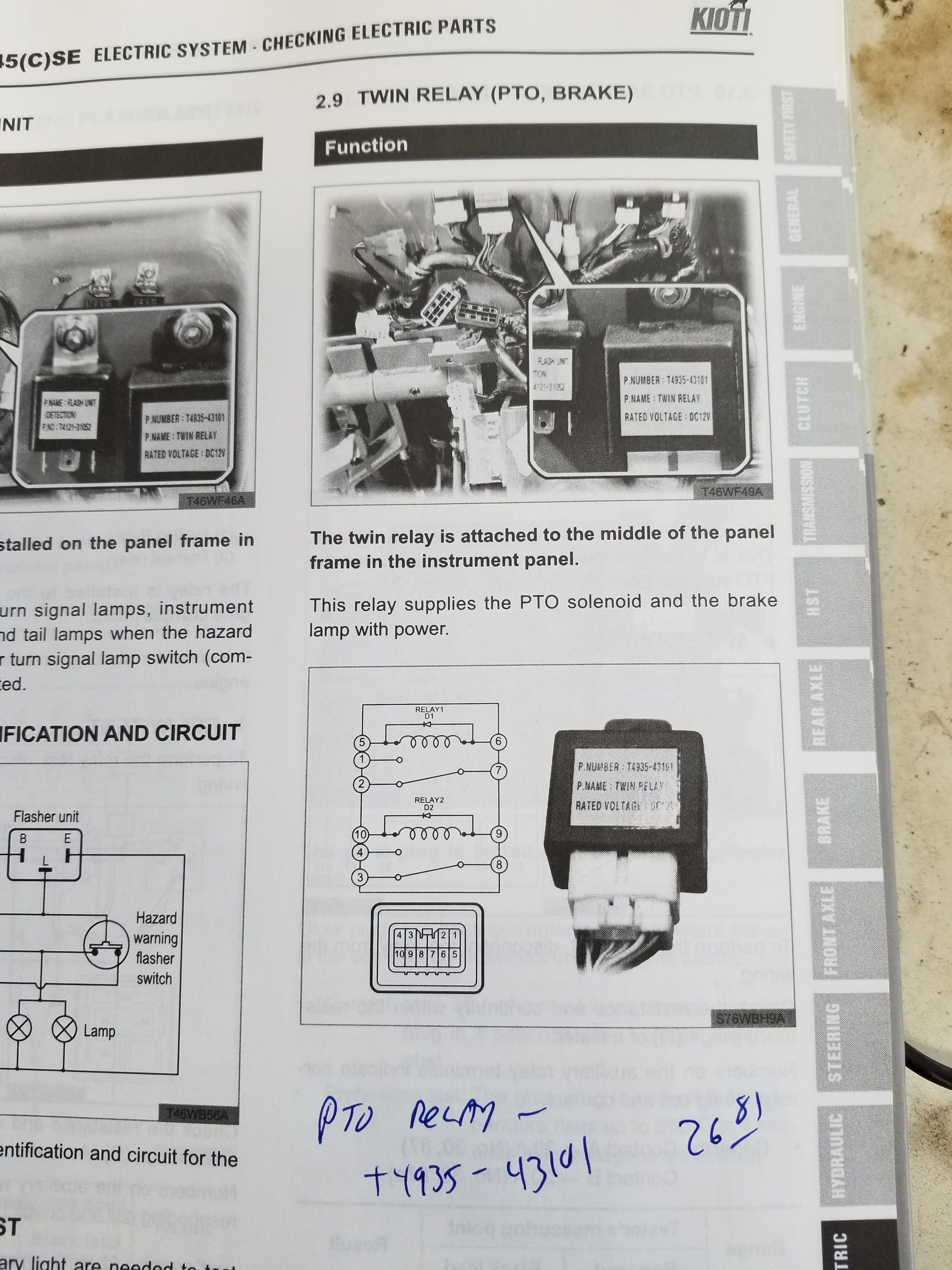

grsthegreat - My tractor has a relay labeled twin relay. What does this relay control, obviously something to do with the PTO?
/ DK35SE PTO not operating #8
Believe it or not, the twin relay located under the steering column cover runs the pto and brake lights... at least on my dk45

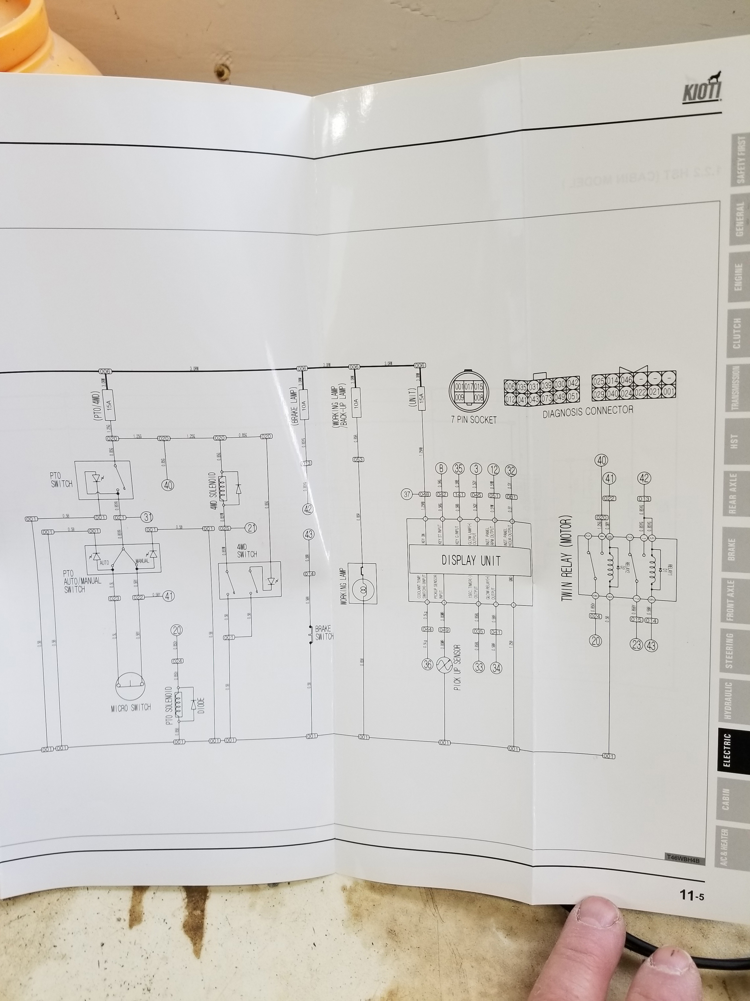

grsthegreat - Do you have the schematic for this? I believe it would be the same for a 35 and 45.
/ DK35SE PTO not operating #10
I have schematic for ex35se. Which is the model number as sold globally. send me an email at my screen name at yahoo.com. Lets see what you can do to help.

you can also go to michiganiron web site. they have full parts breakdowns. i will have to get my service manual from shop and take photo of schematic later today

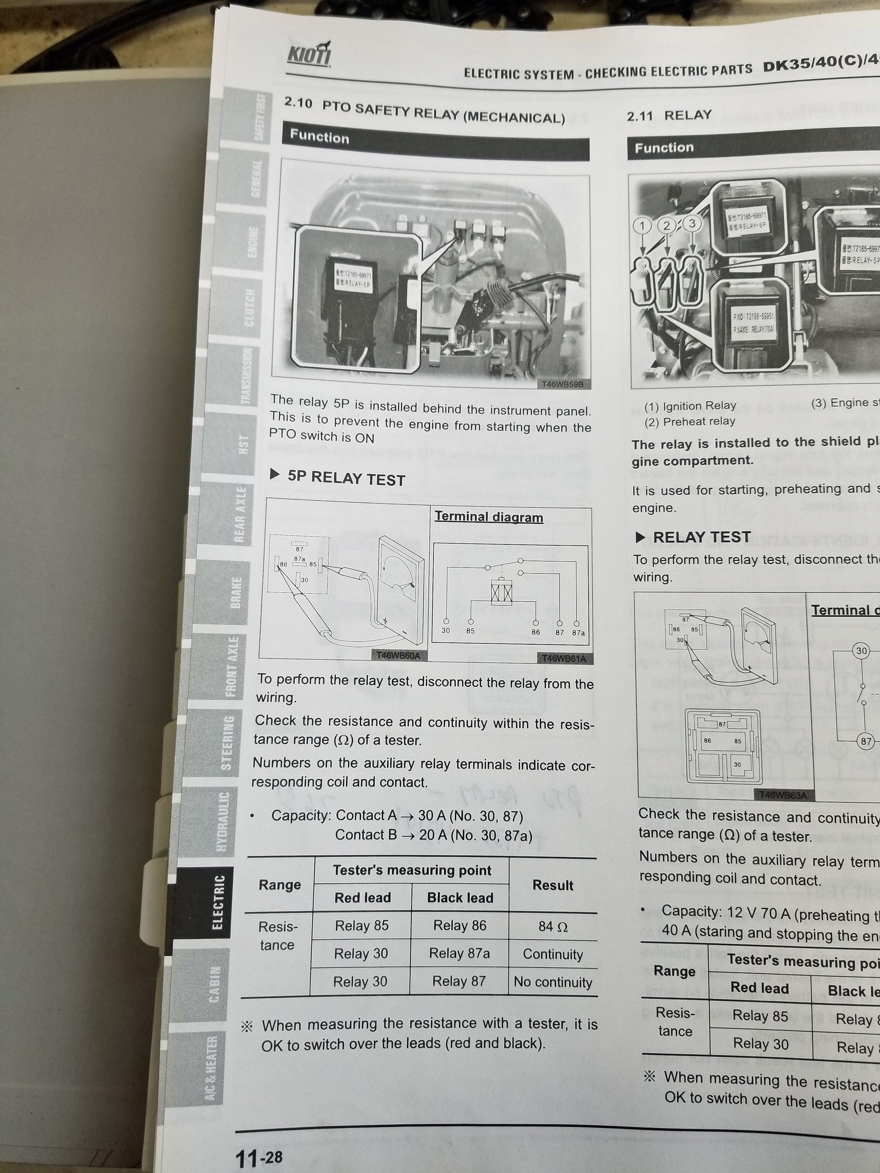

for what it worth...here goes 20200108_122141.jpg 20200108_122522.jpg 20200108_122540.jpg 20200108_122217.jpg 20200108_122229.jpg

Thank you to all who replied. The issue is the twin relay, or at least that half of it, and this item has been ordered. Couldn't have done this without the schematic so thanks again!
