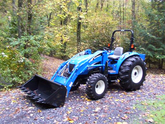

O.K. sorry but this is the last try. I had the tracotr at dealers all winter to get things worked out. Loader specs out with the tracotr hydraulics and pressure. BUT it is so slow !!! Any one have any pearls of wisdom besides selling this rig. It has a Woods 1020 loader . It is trong and the curl angle and power are good but wow baby is it slow to curl and dump ! Please help !!

Gmol, you could also try this for a quick fix.
