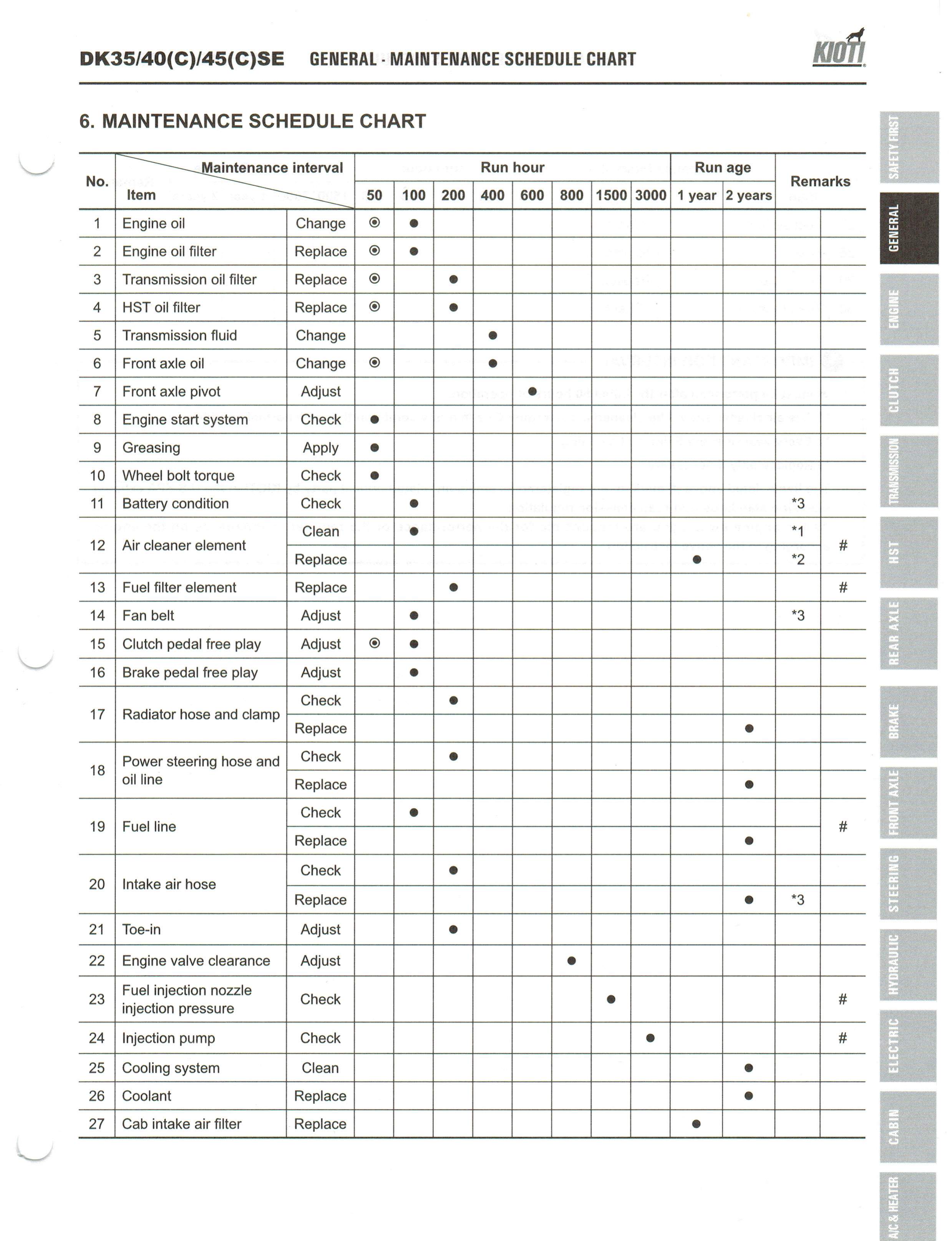

For all that are interested here is my chart..
Thanks. Any chance you could post the remarks and footnotes? (Or just reassure us that they amount to nothing).
How many guys are replacing their radiator hoses, power steering hoses, fuel lines and intake air hoses every 2 years as the chart suggests????? Anyone replacing their coolant every two years???? Not me!:confused2:
I inspect regularly but so far all hoses are without cracks or evident wear and I probably have the oldest new series DK (Sept 2007) here.
I have a 2001 DK. I replaced 1 fuel line that blew, other than that I haven't changed any hoses.
I did change the antifreeze once.

Interesting, my owners manual says to change the transmission fluid at 50 hours. The previous Kubota said filters only at 50 and fluid at 400 hrs.
Island, I did change coolant at 2 years on my B7500, and planned to on the L3400hst, but did not keep the tractor, and plan to on the Kioti, but hoses.. pffft.. if they look good, and squeeze good, go on with them.
James K0UA
James, see page 7-15 in your owners book.

Well, On that page it says The transmission fluid should be changed if it is contaminated or after the transmission is serviced.
When changing the transmission fluid, make sure to change the fluid filter.
However, replace only the filter after intial 50-hour operation.
But on the stupid chart they have it has a dot for 50 hour change.
So I ask you, How often do you change your tranny fluid in your car? Mine has 60,000 miles and has never been touched.
Actually, changing coolant every 3-4 years is a good idea. The anti-corrosion additives oxidize and lose effectiveness. Anyone that's opened up an old car engine that never changed coolant knows this. I don't change hoses unless they leak, bulge/soften, or have overheated.
