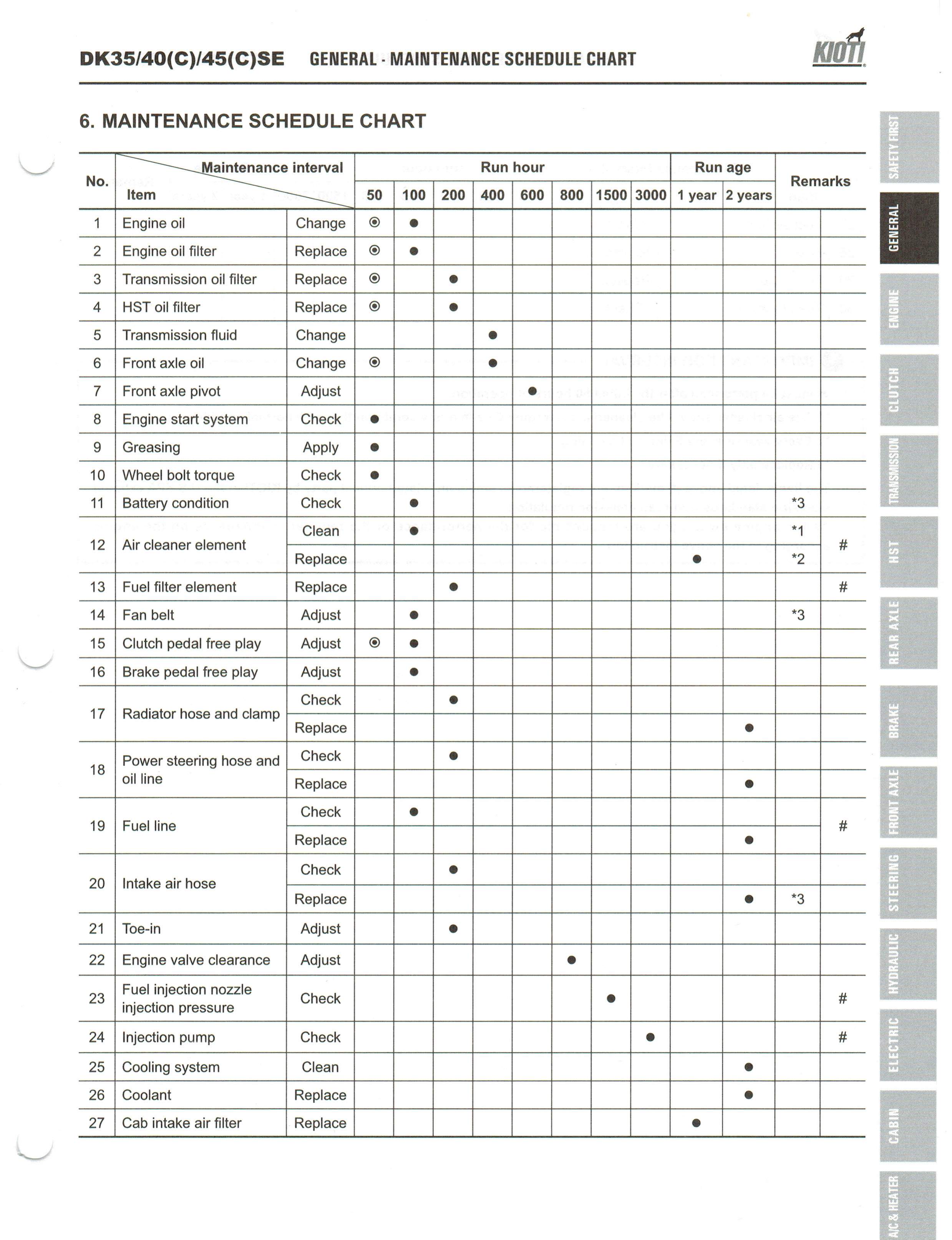

For all that are interested here is my chart..

Thanks. Any chance you could post the remarks and footnotes? (Or just reassure us that they amount to nothing).
How many guys are replacing their radiator hoses, power steering hoses, fuel lines and intake air hoses every 2 years as the chart suggests????? Anyone replacing their coolant every two years???? Not me!:confused2:
I inspect regularly but so far all hoses are without cracks or evident wear and I probably have the oldest new series DK (Sept 2007) here. My tractor does live in a barn and only gets about 75hrs/year put on it so it isn't exactly living a hard life.
/ DK 45 50 hour service #83
I have a 2001 DK. I replaced 1 fuel line that blew, other than that I haven't changed any hoses.
I did change the antifreeze once.

Interesting, my owners manual says to change the transmission fluid at 50 hours. The previous Kubota said filters only at 50 and fluid at 400 hrs.
Island, I did change coolant at 2 years on my B7500, and planned to on the L3400hst, but did not keep the tractor, and plan to on the Kioti, but hoses.. pffft.. if they look good, and squeeze good, go on with them.

James, see page 7-15 in your owners book.

Well, On that page it says The transmission fluid should be changed if it is contaminated or after the transmission is serviced.
When changing the transmission fluid, make sure to change the fluid filter.
However, replace only the filter after intial 50-hour operation.
But on the stupid chart they have it has a dot for 50 hour change.
So I ask you, How often do you change your tranny fluid in your car? Mine has 60,000 miles and has never been touched.

On old cars we used to change every 24000, but new ones I think they are like 100,000 now. I had the tranny fluid changed on a 1972 Olds delta 88 I bought for $500 once, and it had the maint log all filled out by the previous owner a Catholic Priest, And he changed motor oil "religiously" at 3000 miles with Standard LDO all of its 160+thousand miles. The motor ran like a top (350) but the tranny was slipping (turbo 400)..So I had the fluid changed, if you could call it flluid, it was as black as tar, and the little white plastic thingy they put in to seal the transmission in shipment and is knocked down into the pan by the dipstick the first time it is inserted was in the bottom of the pan, along with most of the clutches:eek: Apparently the good father, had never heard of fluid changes on the ole tranny. It did not do any better with the new fluid. Oh well.

My manual indicates in chart on page 7-4 a circled dot in the transmission fluid change at the 50 hour mark, Circled dot means "must be done after 50 hour mark". And again at the 400 hour mark, this time circle no dot. Also the same for front axle fluid.

DK-40 SE/Hst. Dealer said to NOT bother changing transmission hydraulic fluid at 50 hours, just filters. Says he's done it this way for 35 years with no problems. Kioti headquarters tech I spoke to directly about same issue said that is is recommended to change the fluid at 50 hours, and they could void the warranty if they found a problem related to not having done a 50 hour fluid change. I asked them directly because I was trying to make sense of the contradicting requirements between the owners manual and the service book. Interestingly, the Kioti customer service person told me the opposite from the tech and said there was a typo in the service intervals, but there was no need to change the fluid at 50 hours!?:confused2:
I decided to change the filters on my dealer's recommendation and now have over 400 hours and no problems. I will now probably change the fluid, just to have done it once, to see what if any evidence of metal is on the plugs and to know what I have in the transmission as a fluid while still under the warranty period.
Analogies of car transmissions to tractor transmissions don't really fly in my book. When was the last time, or for that matter the first time, ANYone hooked up a remote QD to a car or a 3ph?! Car systems are sealed and can therefore use fluid for huge amounts of miles now, whereas before synthetic fluids they could not do so without filter and fluid changes
On the anti-freeze issue: I would say to change the fluid and do a flush of the cooling system at 2 years or thereabout. Coolant does NOT improve with age and aluminum does get pitted from acids and particulate matter that can form from hard water mixed with the coolant when it is installed. It has a useful life, after which it does not flow as easily due to viscosity changes which can block cooling jackets and ports in the block/head, etc.
It is something I would choose not to ignore; and I speak from years of having serviced very expensive aluminum head and /or block foreign cars.
BTW, clarification of what the warranty means: changing a filter is NOT the same as changing a water pump. I defy Kioti or any other manufacturer to deny or void a warranty on the basis of a customer/owner changing their own fluids/filters and having documentation to prove having done so.

I posted this in another ongoing thread about the same issue but I'm adding it hear for what it's worth;
OK, after dealing with Kioti about my cab, I've made a few contacts there. I sent them an email this morning and recieved the following response. I'm not including any of their full names or email address.
> From: D------@kiotitractor.com
> To: ken.----------@hotmail.com; J-------@kiotitractor.com
> CC: JS-----@kiotitractor.com; B----@kiotitractor.com
> Subject: RE: 50 hr service issue
> Date: Tue, 24 Apr 2012 19:12:12 +0000
> Ken,
> I undeerstand the confusion concerning the fifty hour service. It has been open for discussion before. KIOTI reccommends changing all fluids at a fifty hour initial break-in service. The reasoning for this is too remove any material that may become dislodged or created as gears mesh themselves together. While KIOTI has very close tolerances in machining, the meshing or wearing in of gear sets may produce very fine particles that may or may not be captured by the filter. It is always a good rule to exchange the initial fluid out after the first fifty hours to flush the system thus removing any particulates and replace the filters as well. As the old adage goes, " A ounce of prevention is worth a pound of cure." Protection for your investment! Any further questions, feel free to contact me. Thanks!
> ________________________________
> From: Ken Wilson [ken.-----------@hotmail.com]
> Sent: Tuesday, April 24, 2012 7:58 AM
> To: H---- B------
> Cc: D----- P------; J----- S------; B----- B------
> Subject: 50 hr service issue
> Gentlemen,
> There has been a great deal of debate and confusion recently in the Kioti forum section of TractorbyNet.com amongst Kioti owners regarding the 50 hr service and I'm hoping to get a definitive answer from Kioti on how the service should be completed. Apparently, dealers are not clear on the proper protocol for the 50 hr service either as conflicting messages are being sent.
> The issue is whether there needs to be a full hydraulic oil flush at 50 hrs. The Kioti owners manual for both CK and DK models says it should be done, but the shop manual for the DK models (I'm not sure about the CK line) says not to change until 400 hrs and that only the filters need to be changed at 50hrs.
> Below are links to the ongoing discussion.
> http://www.tractorbynet.com/forums/kioti-owning-operating/240974-dk-45-50-hour-service.html - currently over 1600 views
> http://www.tractorbynet.com/forums/kioti-owning-operating/242171-50-hrs-coming-up-fast.html - currently over 200 views
> I've also seen several other threads discussing this issue in the past. It would be great to finally put this issue to rest, once and for all. I will post your reply for the benifit of a large portion of your client base, ensuring not to post names or email addresses.
> Thanks,
> Ken Wilson

Ken, that seems to be pretty well defined answer, I am changing the fluid at 50 hours.. Now what the heck is with all these conflicting numbers for front and rear wheel bolt/nut torque specs? I have a new owners manual, and I can read pretty well. But it appears different things have been printed about these torque specs.
