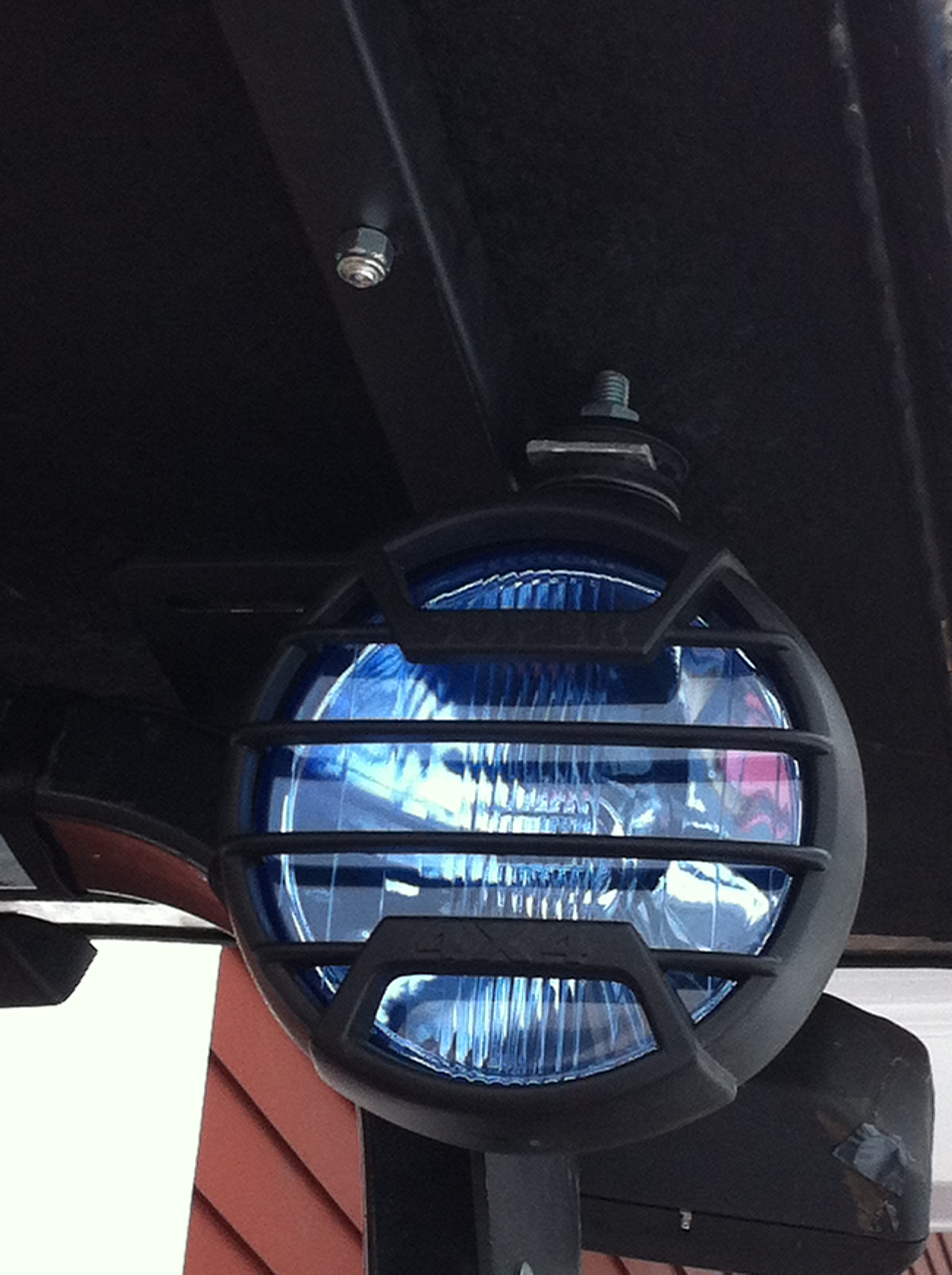

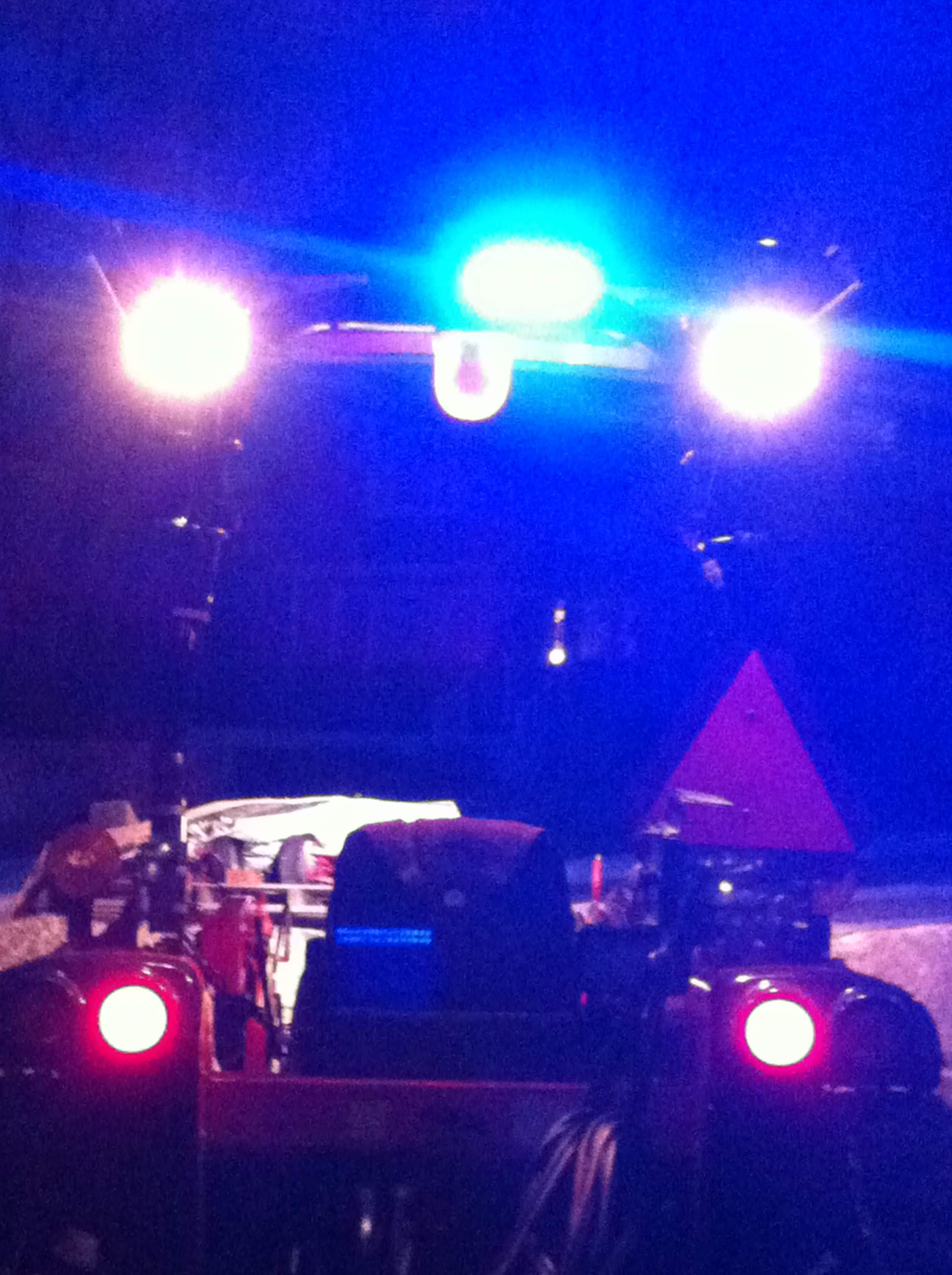

Left front 7" Blazer halogen, 55W, with blue tint lens.

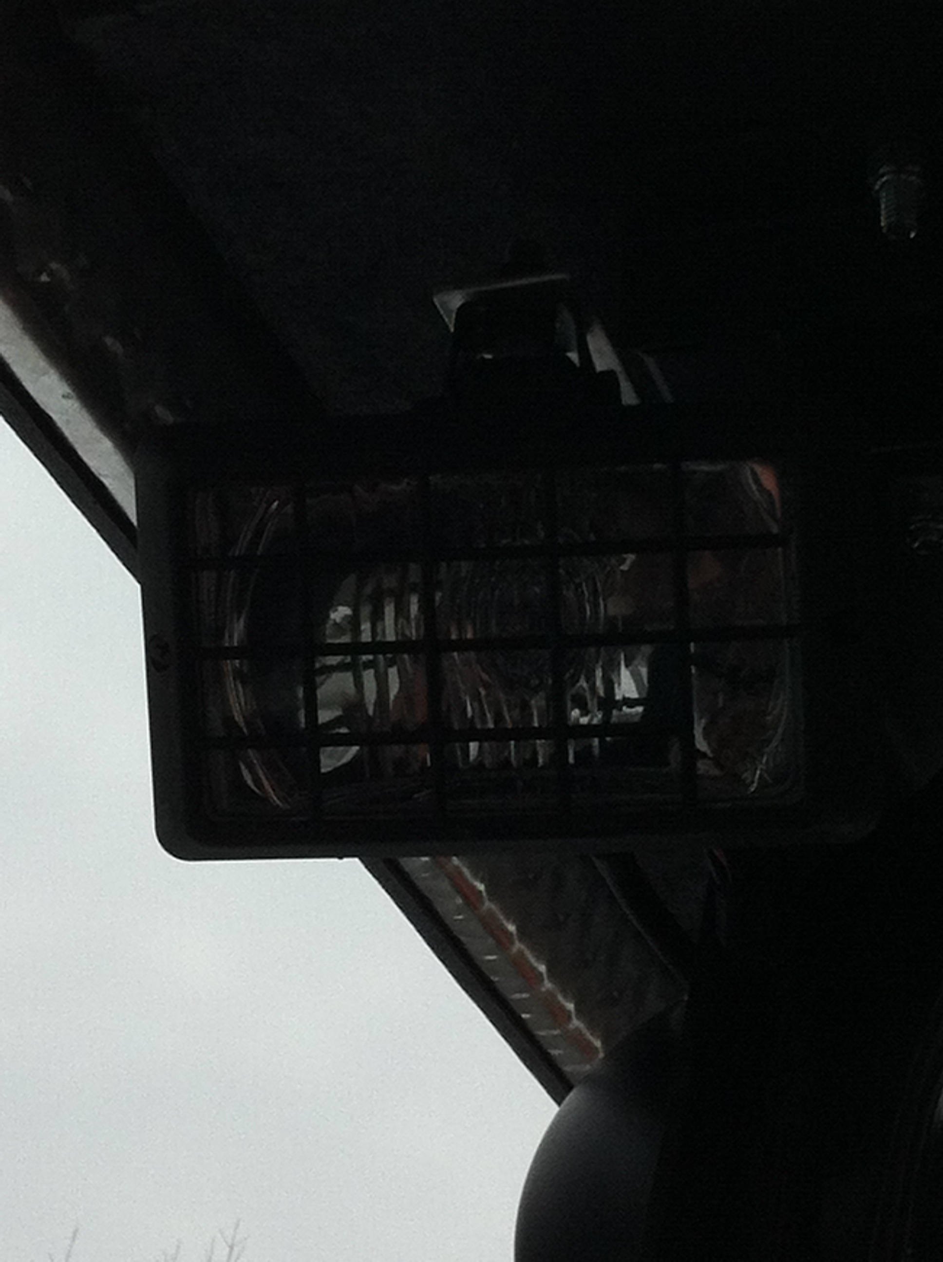

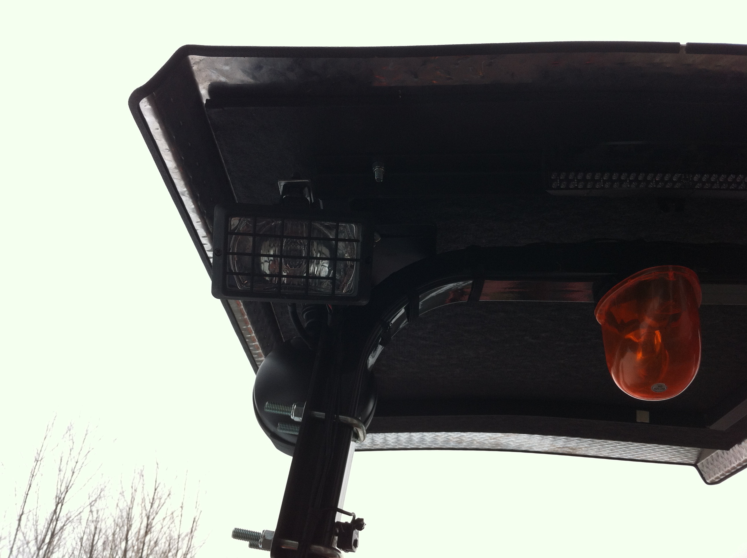

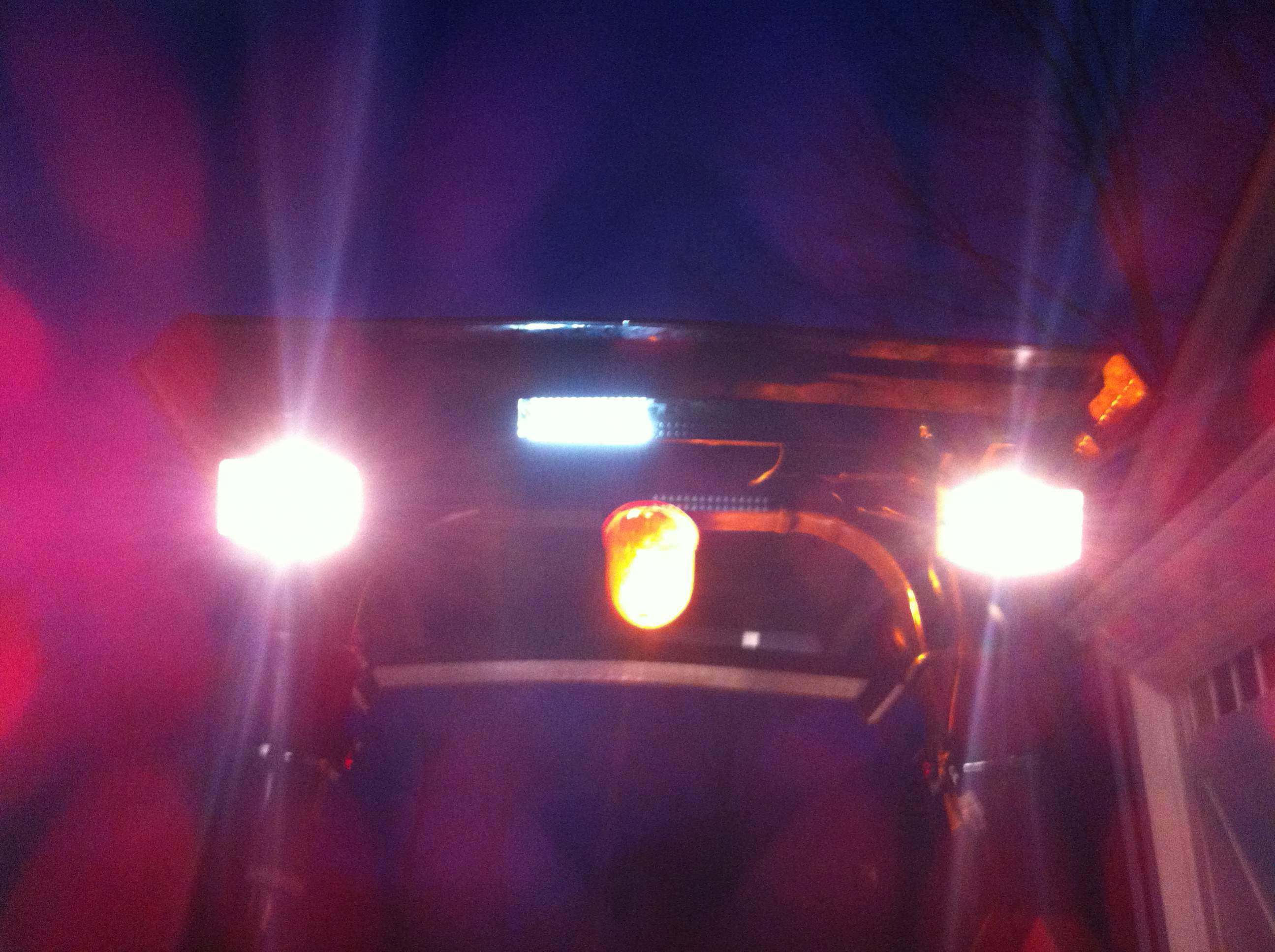

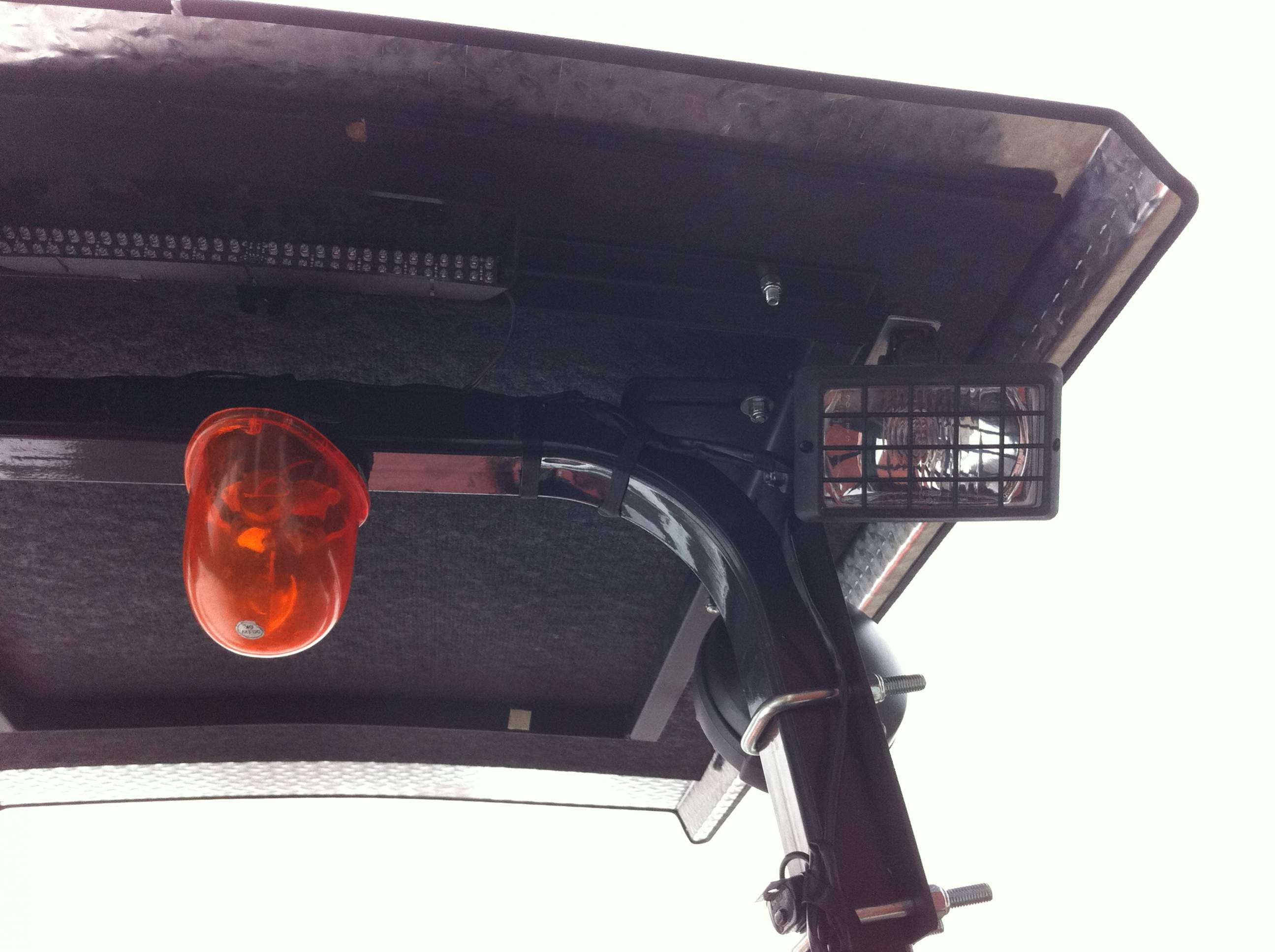

Left rear 3x5" halogen, 55W Baja light, under canopy.

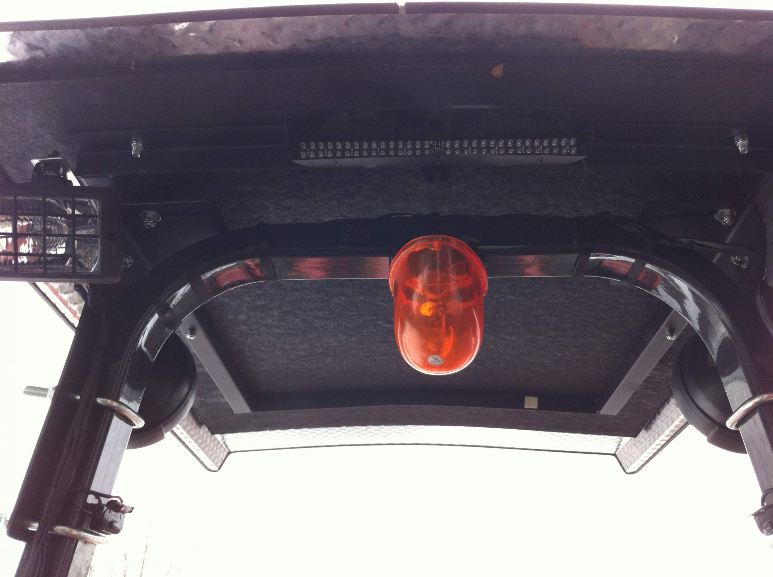

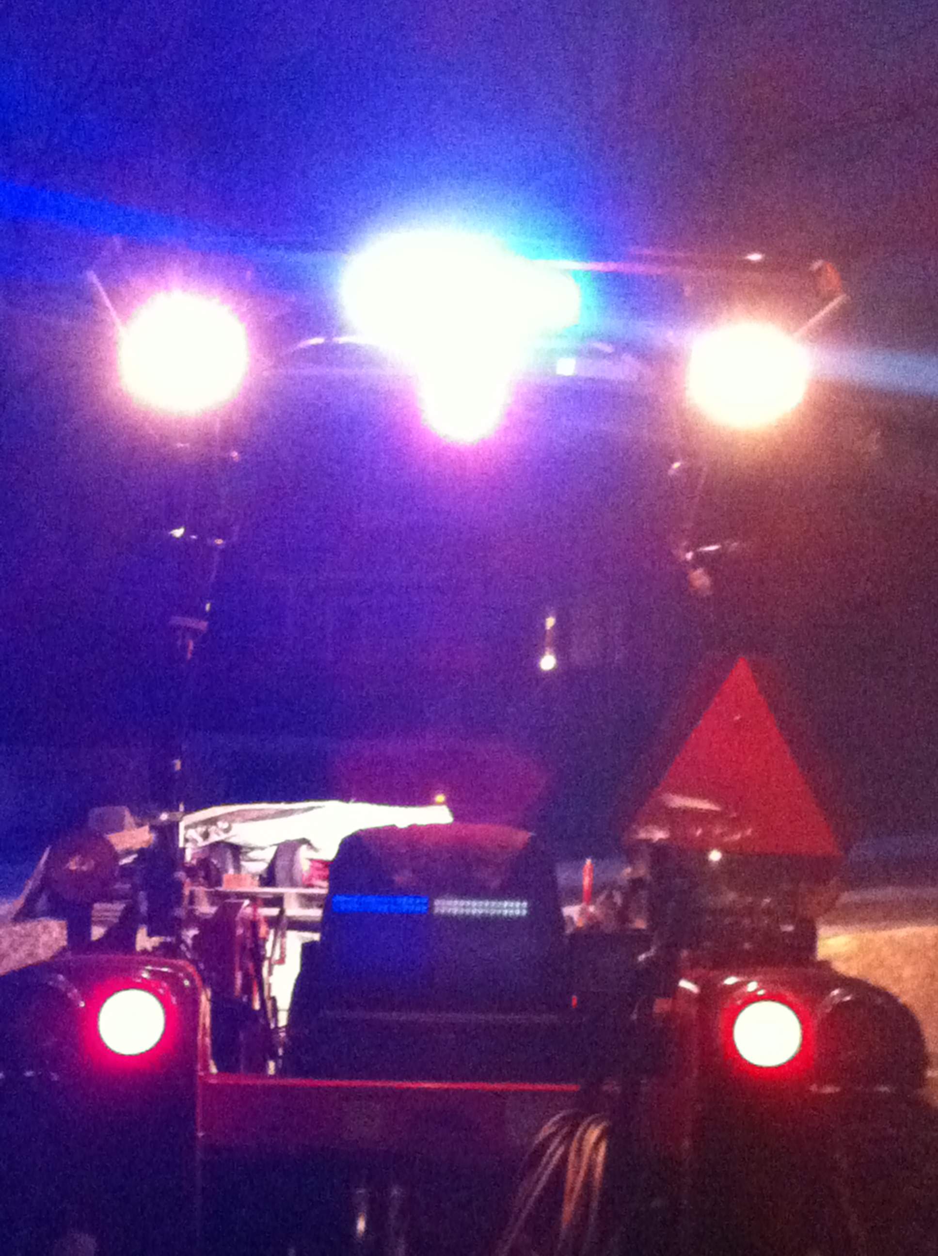

Left rear, orange rotator, and strobe above.
Right rear, orange rotator, and strobe.
Left rear different angle.

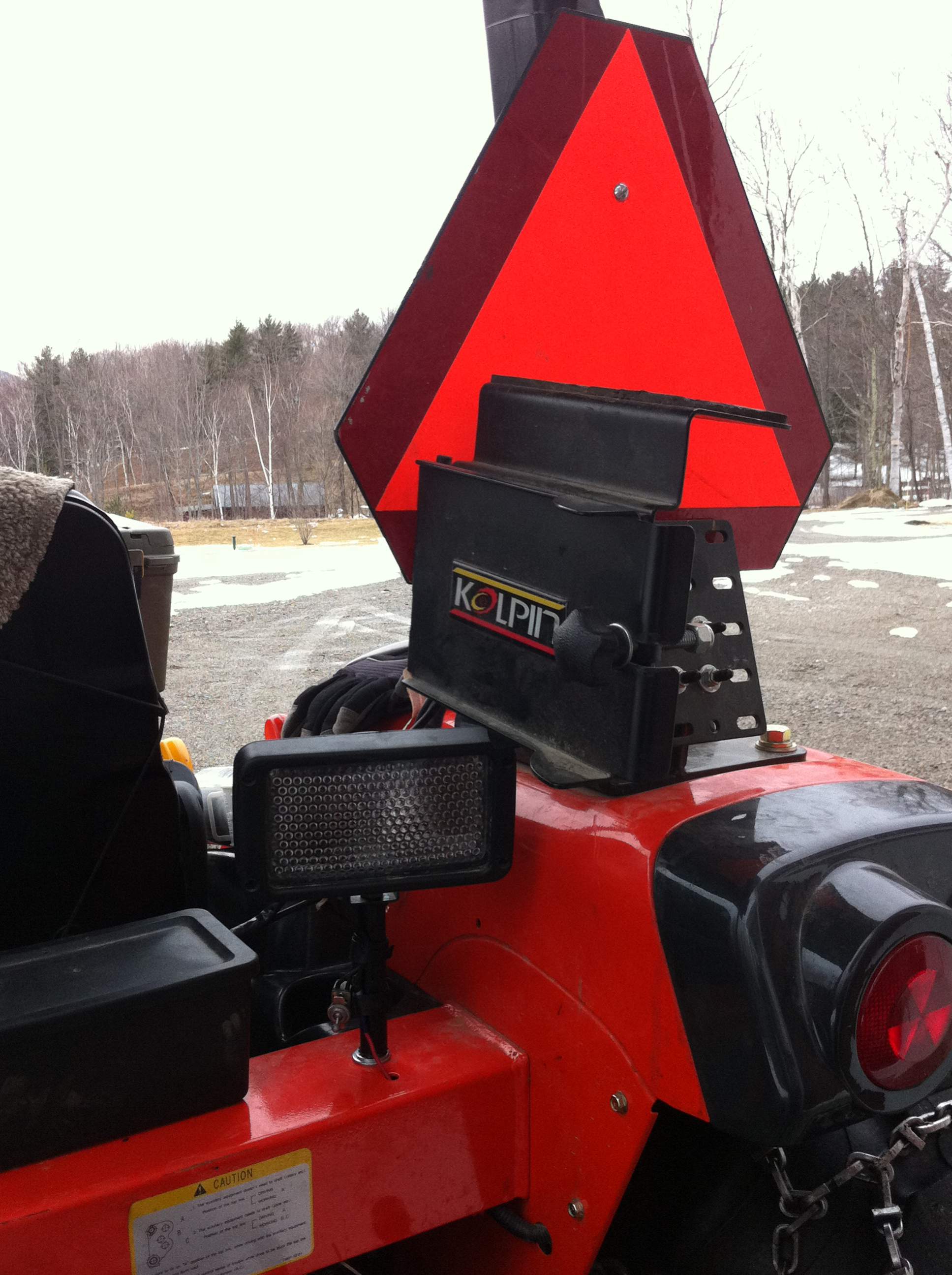

Aux halogen work light, (off factory spare fuse/wire). Also, Kolpin Chainsaw holder, works great! and SMV sign.

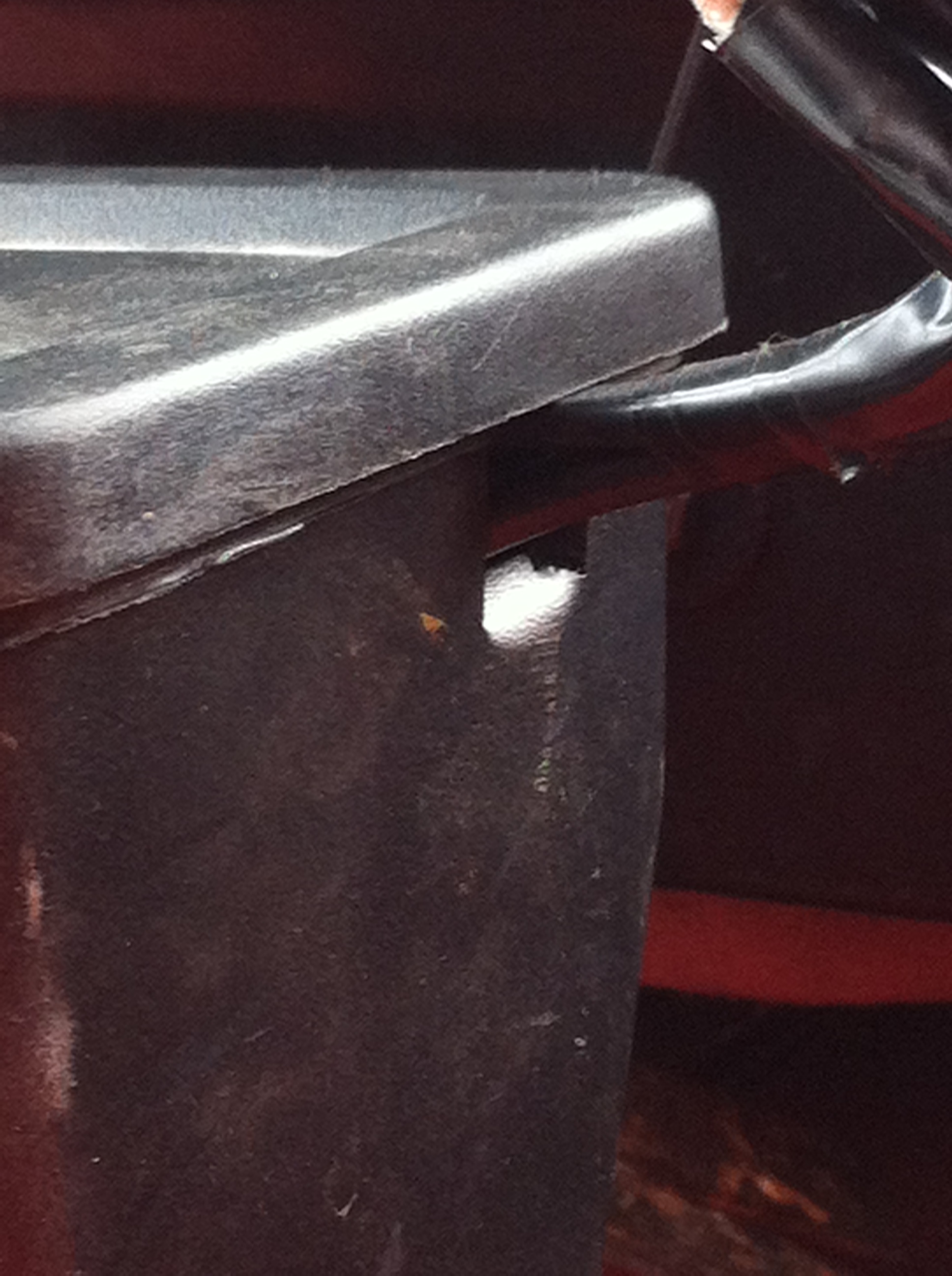

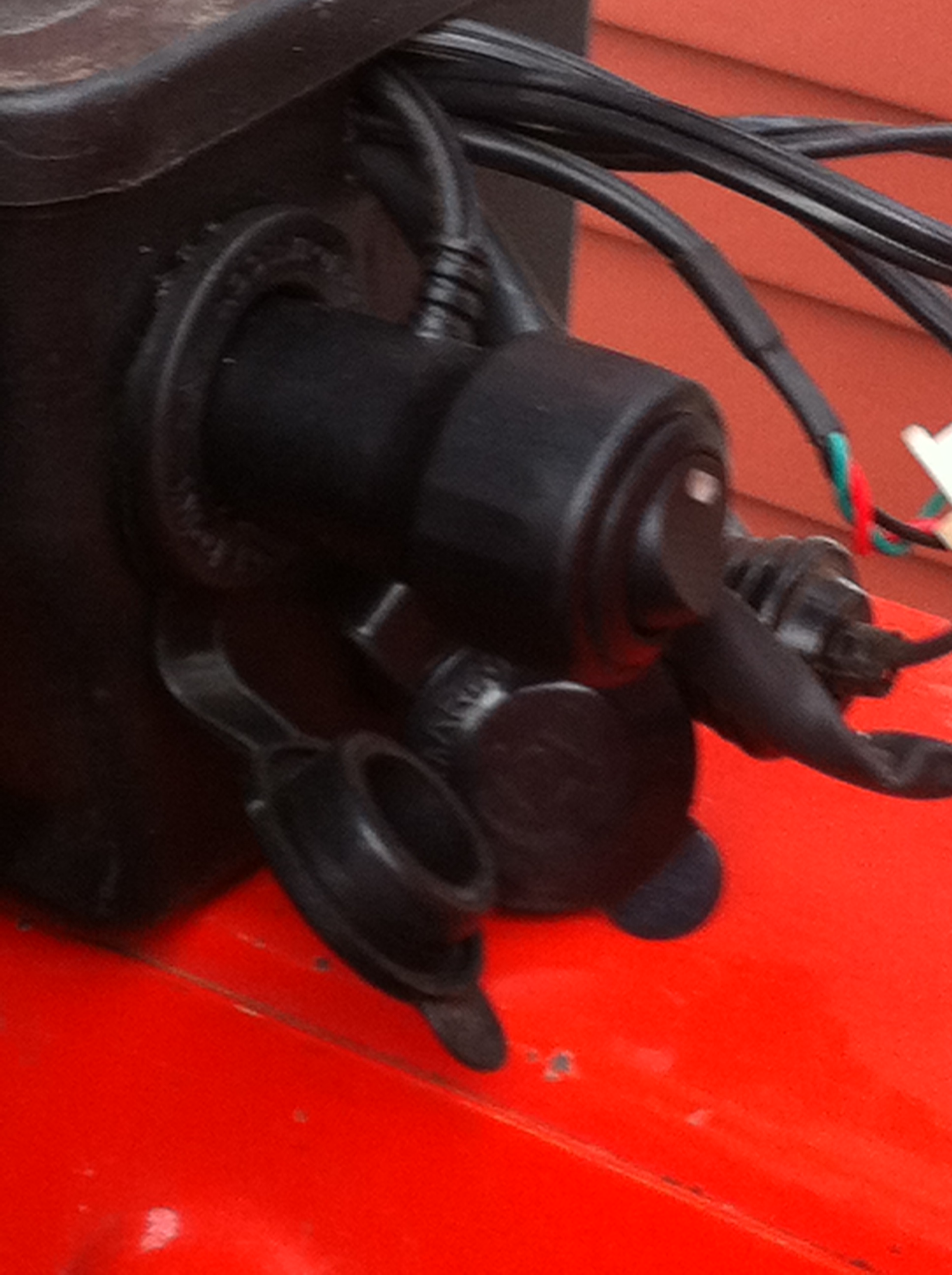

Factory toolbox behind seat, with receptacles cut in for wiring harnesses.
Toobox left rear view.

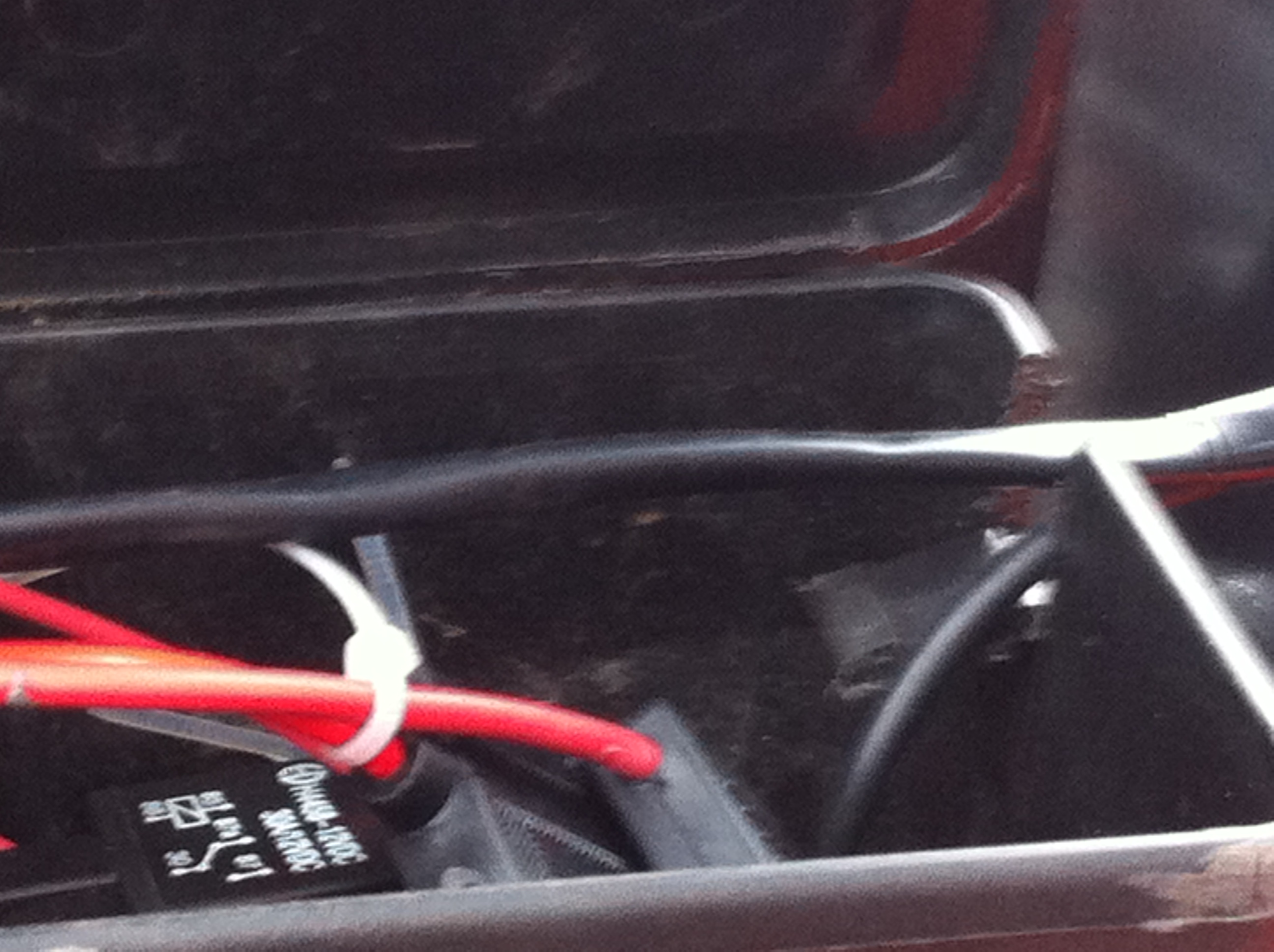

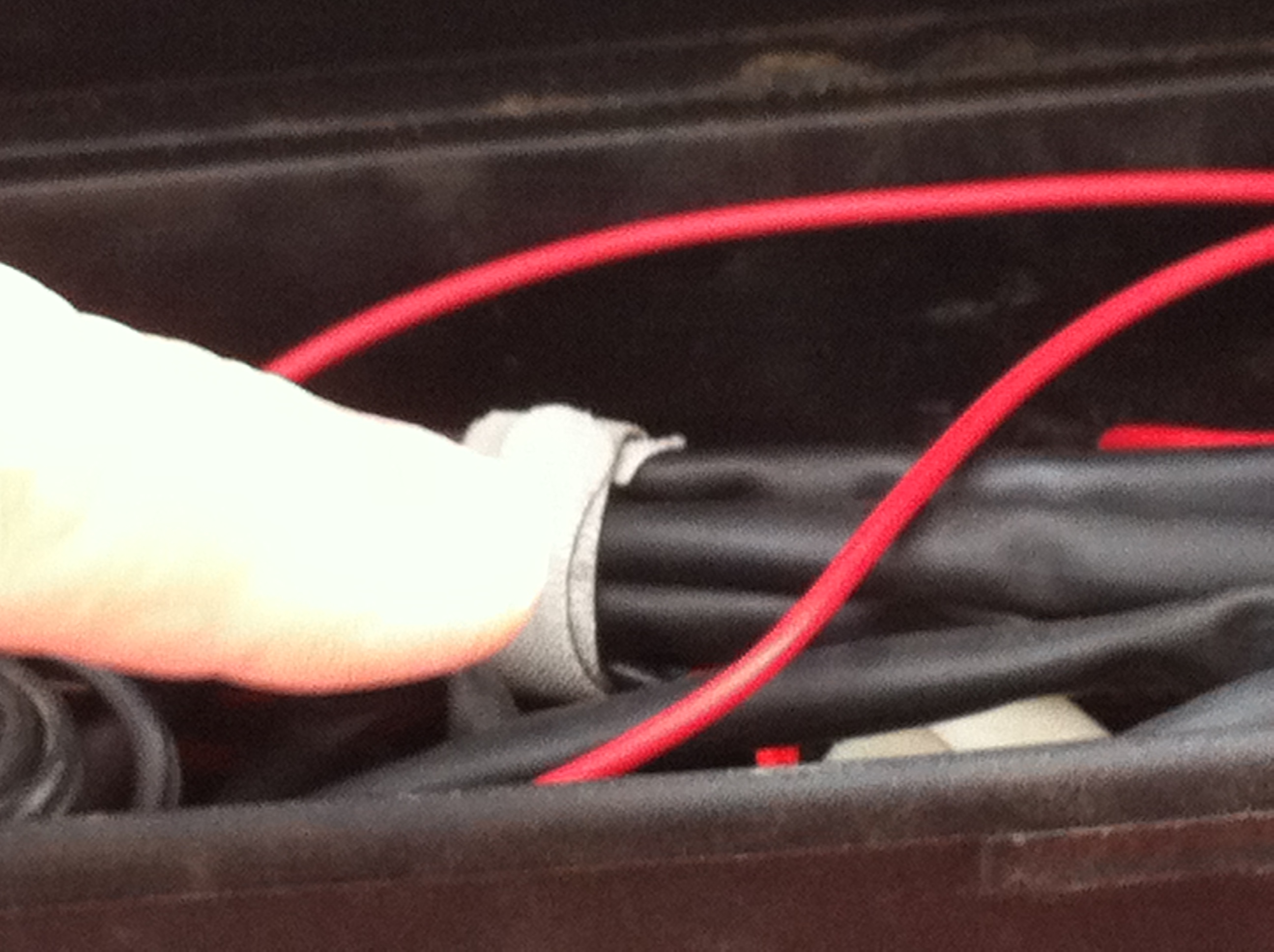

Fuses, 15A, built inline in harnesses, relays for harnesses, (one each pair of lights), and cut in box for wire entry.
Index finger pointing to toolbox harness and velcro wire straps. like using velcro until final version to be able to do up, then undo if needed without wasting numerous cable ties.
Wire harness into right side of box.

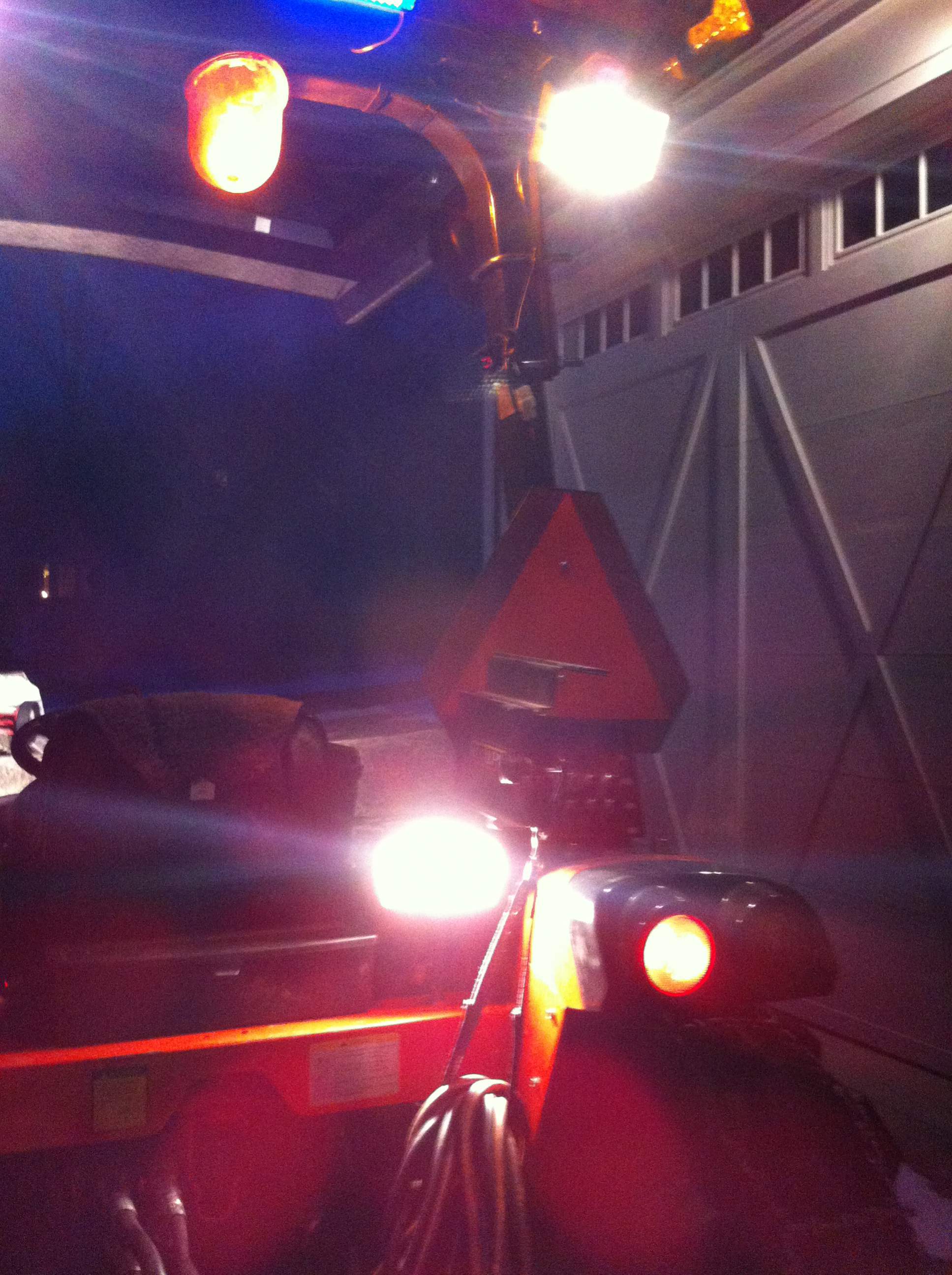

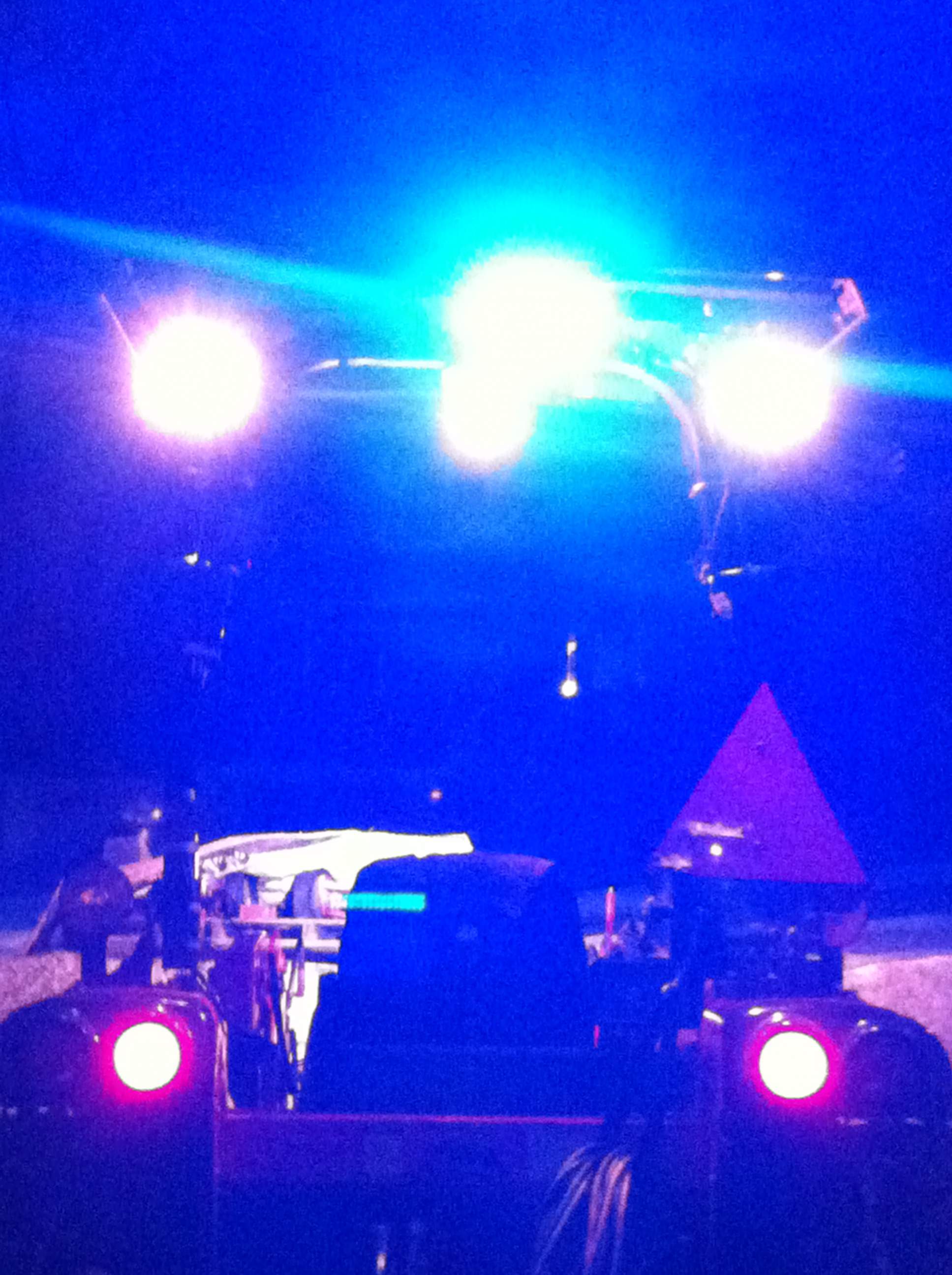

All rear lights ON except aux.
Same as above.
Rears, different view angle.
Rears.
Rears.

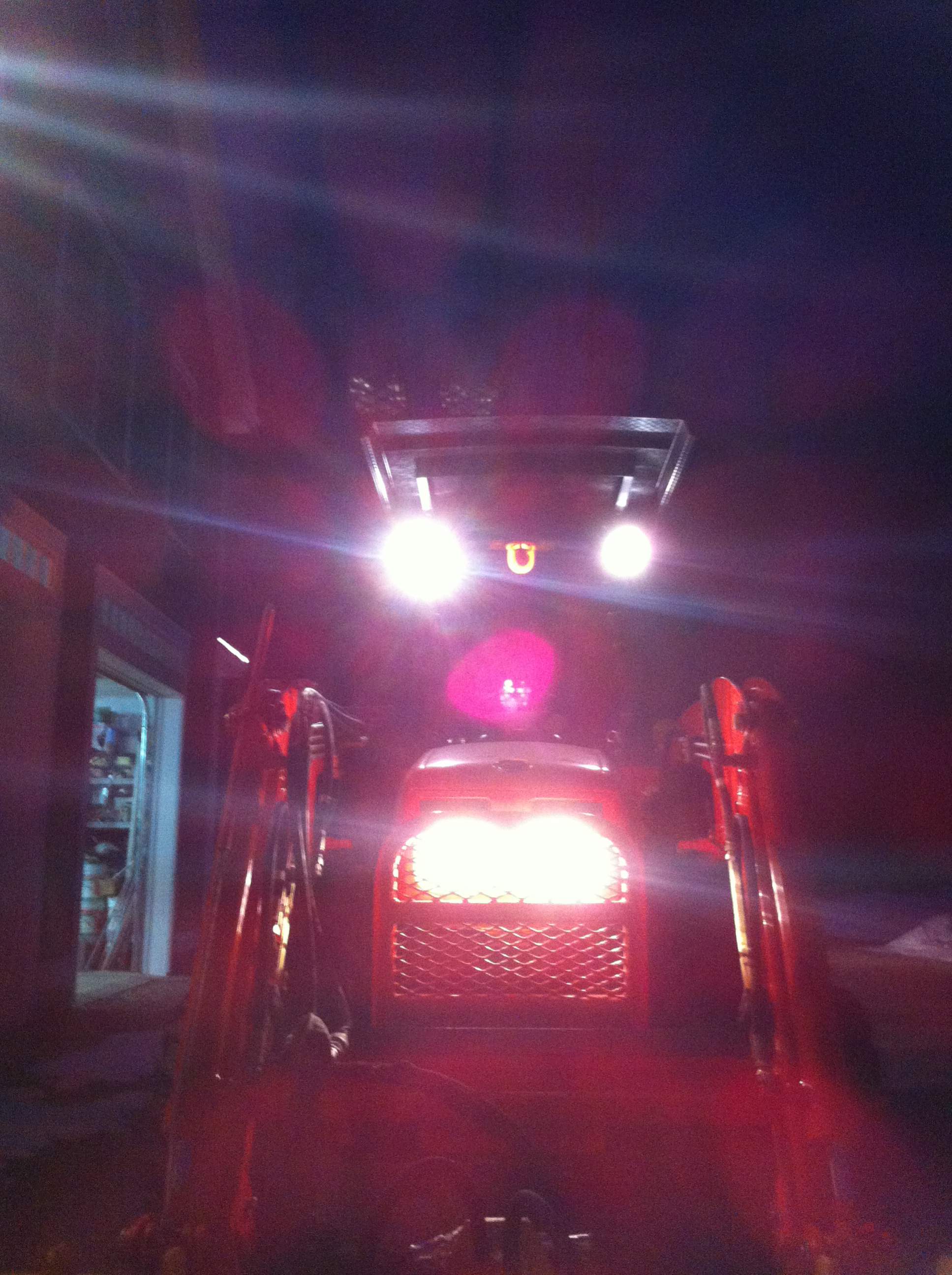

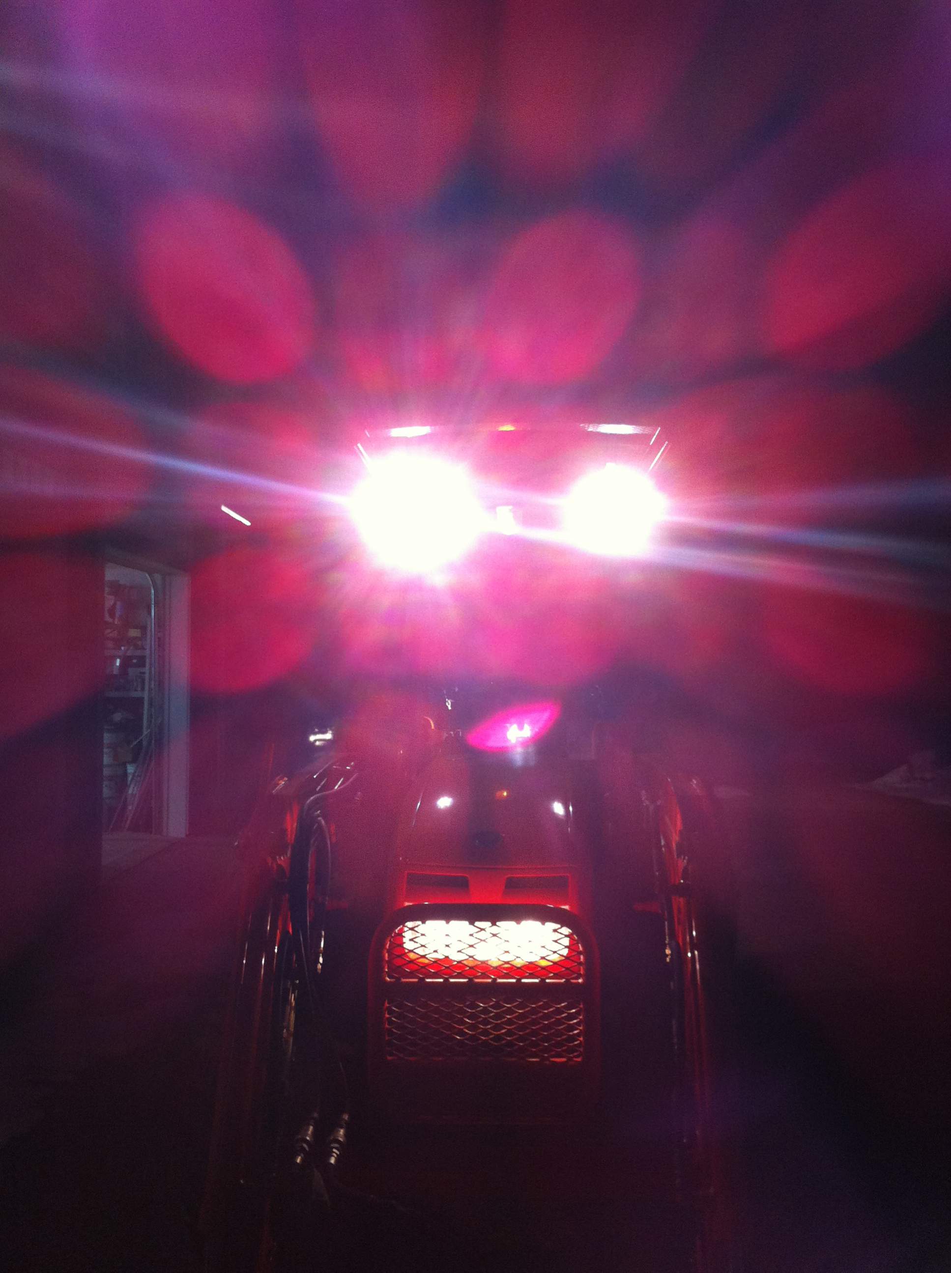

Fronts and headlights- note headlights uselessly dim.
Fronts and headlights different angle- shows contrast to headlights.
The wires are protected by fuses, as mentioned above, and I did add an inline fuse holder at the scotch lock where the factory hot wire feeds the added circuit. The fuse holder holds a 30 amp fuse to protect all downstream wiring and lights. To date I have run everything at once, headlights and all auxillary lights, strobe, rotating orange light, etc. with ZERO problems, no blown fuses, etc.
I use the lights for many things, but especially night time plowing. The work light is obvious for it's use and can be rotated as needed to direct light where I need it and it can be adjusted up or down for similar outcomes. The switch is temporary, I could not locate the switch I planned to use.
