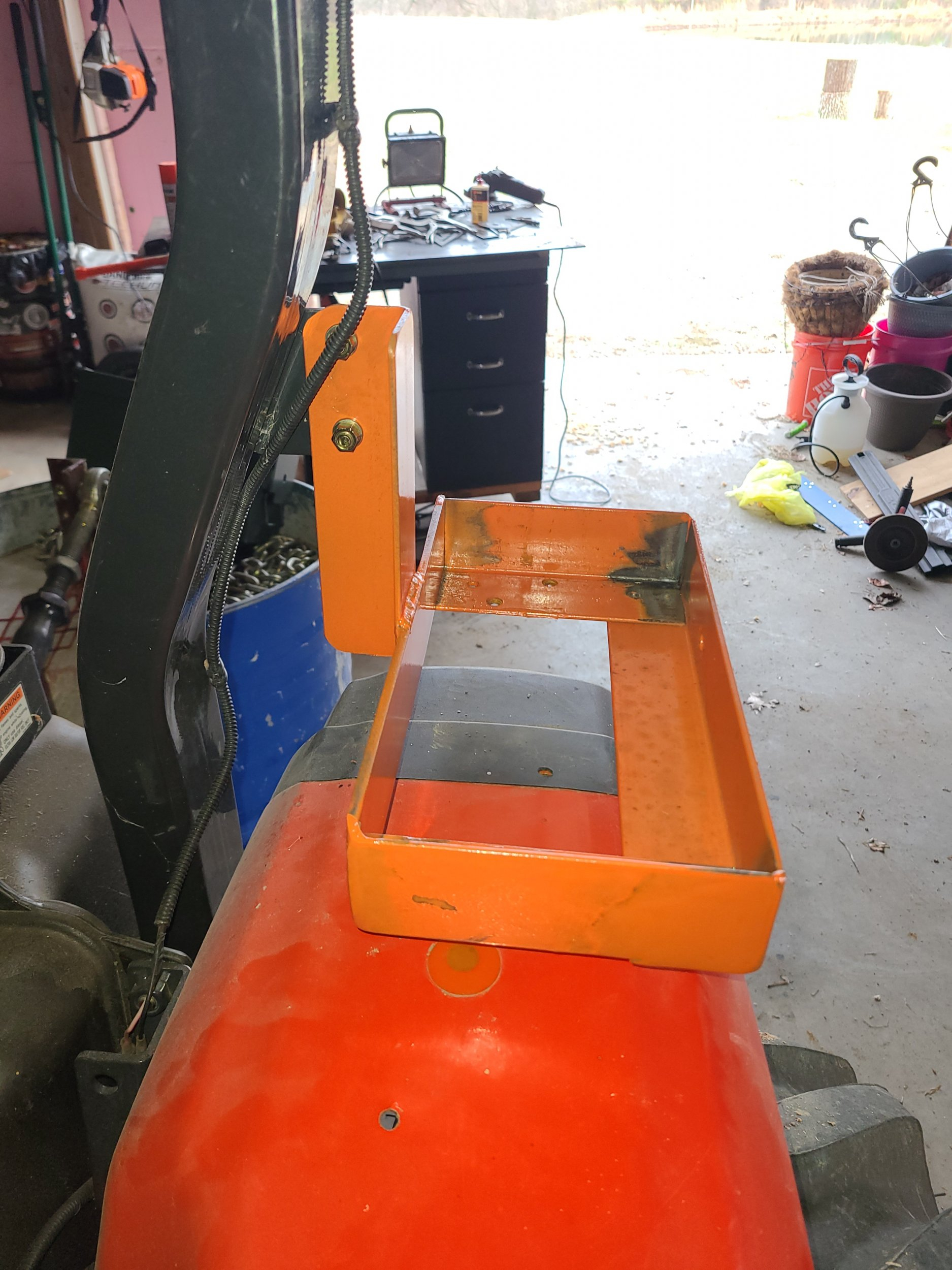

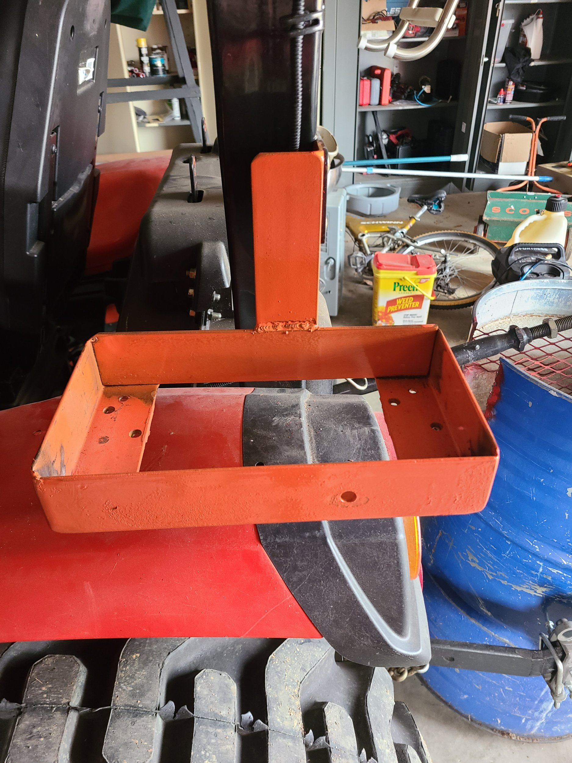

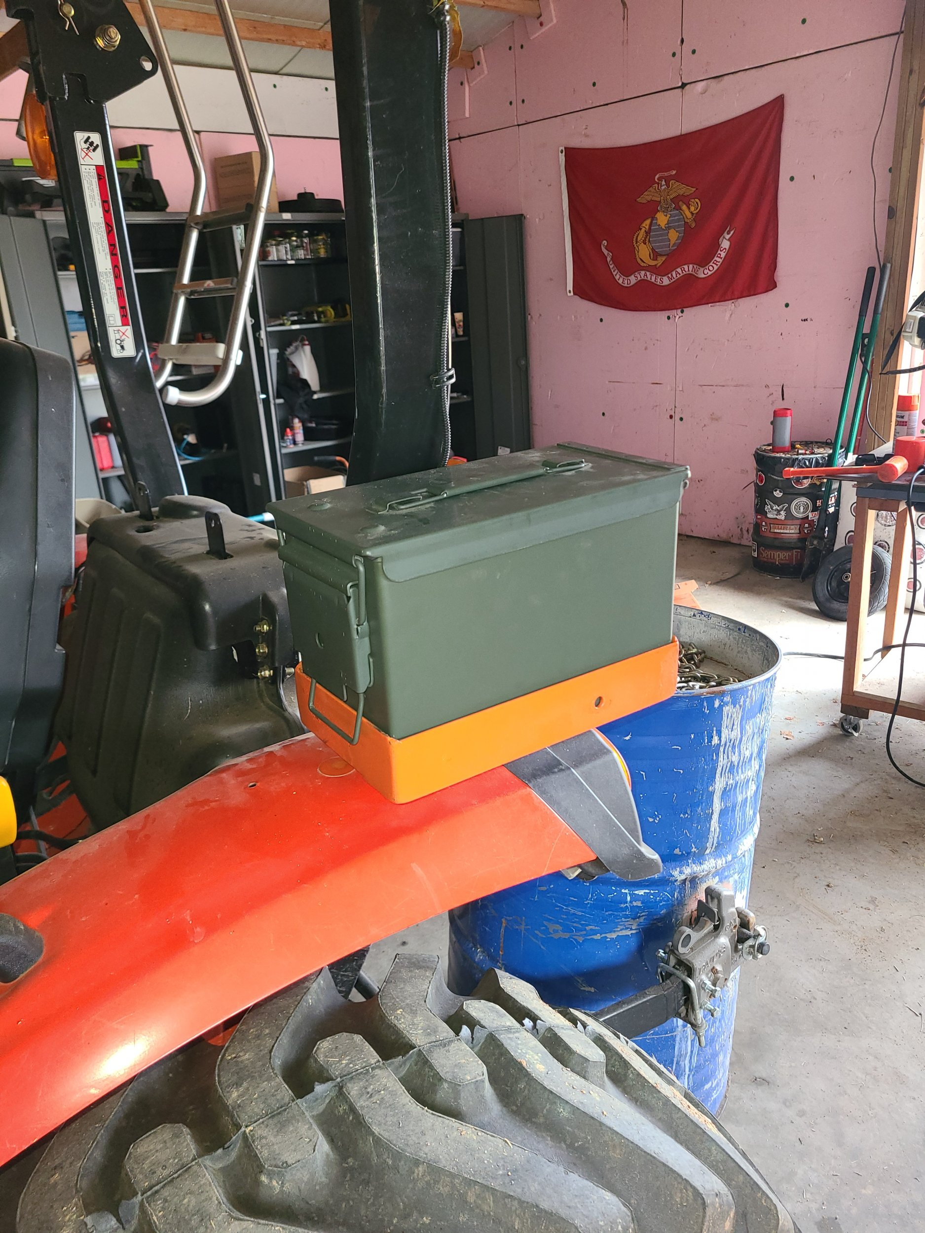

Decided to mount a .50 cal Ammo can to my ROPS to hold tools, chain, clips, etc.
Used some scrap 1/8 angle iron I had laying around and stick welded this up.
Can is a light friction fit so I can remove if needed. Time will tell if I need a standoff down to the fender for support.
   / DIY Tractor toolbox holder
#2
I should add I didn't weld on the ROPS, I bolted it to the tab that had the SMV sign bracket attached.
   / DIY Tractor toolbox holder #3
Thats good otherwise you would have been flogged tarred and feathered.
Like your mount and location. Ive bought ammo cans and toolboxes with plans of mounting to my tractor but so far havent been satisfied with how it would turn out. Maybe Im just too picky.
   / DIY Tractor toolbox holder #4
I fabricated some guards for the tail lights on my L2501. Looks like you could add some expanded metal to the bottom of your tool box holder to protects yours as well if you wanted.
   / DIY Tractor toolbox holder #5
Nice job !!
gg
   / DIY Tractor toolbox holder #6
Nice work. You will find it most helpful.
Good idea using existing ROPS attachment point.
