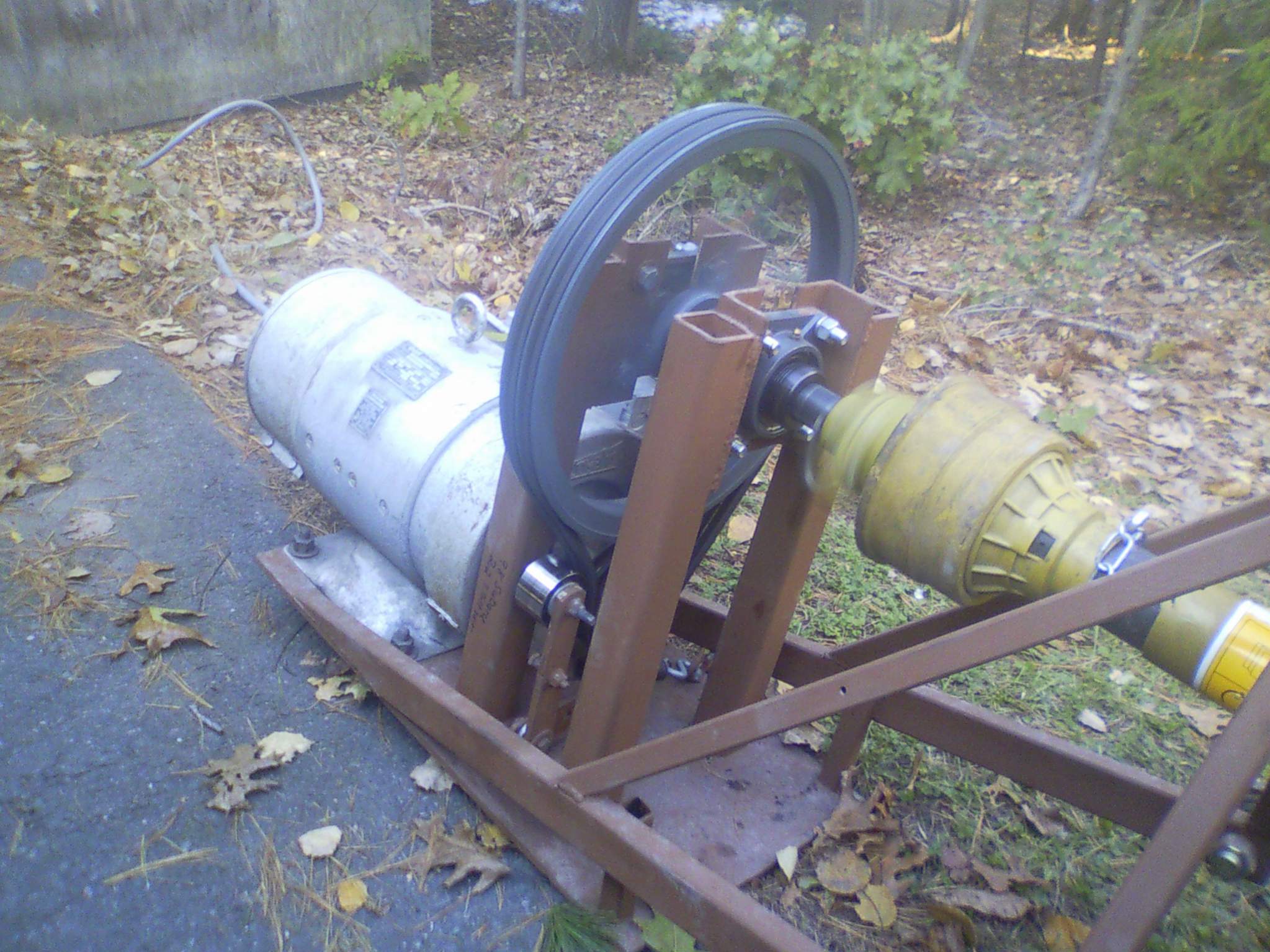

I wasn't going to throw this out there till I was done with it but I found it to interesting that you have the same tractor and Generator. How has it been working out on the 3520?
Just a few more things to work out then I'll tear it down and paint it.
Nice work BTW.

Say what you will but it works like a charm and does exactly what I need. You can throw money around to have all the shinny new stuff you want. When we were with out power for a week. There was no gasoline to be bought only siphoned out of the vehicles. Oh no that's not safe either. I have plenty of home heating oil, and a small tractor that did what I needed. No extra engine to maintain. Why would you really need 14k in an emergency which is what this was built for? Denial hahaha what a trip.
Don't try to deflect the issue by not mentioning the open belts , open pulleys and open drive shaft. Then trying the smoke and mirrors diversion over the lack of concern for safety . With a rant on siphoning fuel etc.
/ DIY PTO Generator #23
Safety is in the eye of the beholder.
Ensure noone except the operator gets any where near the equipment and treat it as a machine with known but avoidable hazards.
It's not like he's selling it on Amazon to the public.

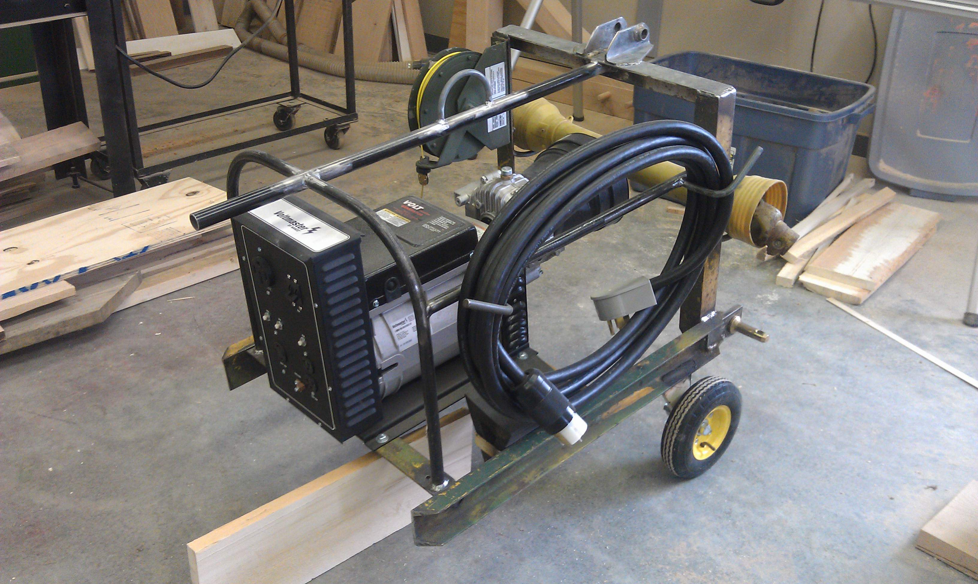

Why but a PTO driven generator when an engine driven portable on is no more expensive ? Thinking 7 or 8 KW range.
i've yet to see a genset that comes with an engine cost as little as the genset and pto setup.
7k and 12k and 24k are common pto denomontions.

Soundguy I am leaning in favor of the PTO generator in that it is one less motor to maintain and with luck maybe a better head. The down side is that everything but my tractor is gas and I will need to keep additional disel fuel on hand for the tractor. But as others stated it keeps better then gas. I should check with the local truck stop to see if they have generator backup to pump fuel when there is a power out. But I would have to use the tractor to get there ;) That is providing they are open. I guess they key here is to ration the use until one can ensure that one can get more fuel as suggested above.
What blows me away is the price of PTO shafts. It looks like another $200 or $300 and one still has to mount the generator.
/ DIY PTO Generator #33
<snip>
WOW! I hadn't priced them in a while. Glad my $600 12K Winco Generator came with it's PTO shaft!
