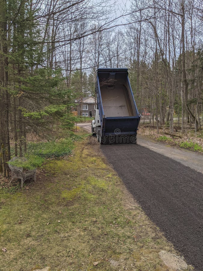

Do you have a coal burning power plant in the area? Typically you can buy a truck load of spent coal cinders to put down. My parents did this with the electric power plant as the material was free.
In some northern states, to avoid using salts on the road, they would mix 50/50 with salt and the cinders. This combo melts snow/ice and offers traction.
Black cinders stay put. They allow the water to pass-thru. They don't generate dust nor blow away. Cinders can hold a great deal of weight as well. In many cases preferred over crush-n-run.
Another option to add to your list.

Do they still sell that? E-Z Base was a big hit for a few years around here (well NE of here), till they found the dust was basically asbestos, and then other problems. Power plant stopped selling it, and now I think its buried in a land fill?
