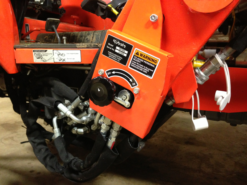

This picture is showing how the Kubota shock less ride system looks once installed. I move a lot of round bales, and our ground can be pretty bumpy. This system allows the loader to "float", absorbing most of the bounce. I can tell you it's amazing! You lose a little speed when raising or lowering the loader. Fortunately turning it on or off is simply done by turning the knob. I highly recommend this option if you want to take the bounce out of your ride. Installation was a little tricky since the instructions were terrible. You add quite a few new hoses and tee fittings. You also end up with a lot of extra parts, which add to the confusion.

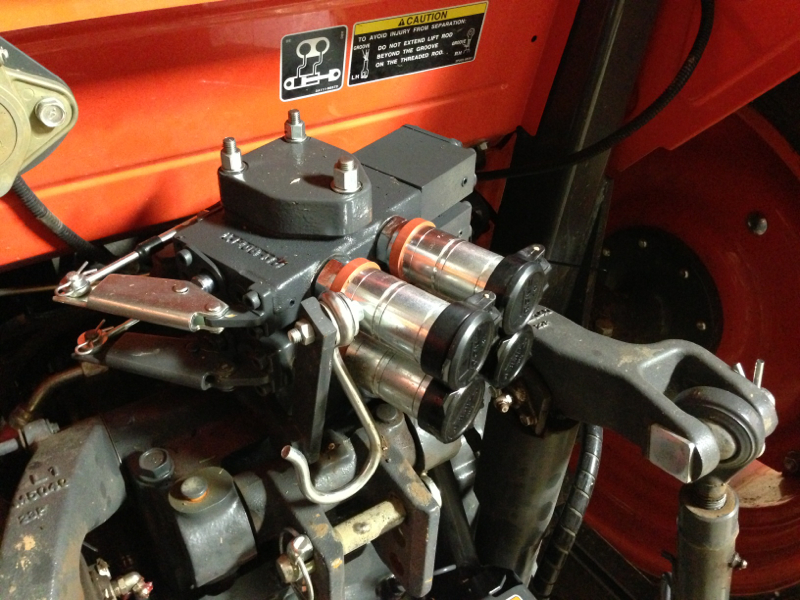

In order to run our NH 216 rake, I need 2 remotes. I had one, but added the second one. Very simple process. Bolt the new remote on top of your current one, hook up a cable, and add the handle. I'm going to get a hydraulic tilt cylinder someday, so a 3rd remote is in my future as well.
Additional remote handle shown. I staggered them to allow for easier operation. Not sure yet if I like it that way. It's simple to adjust if needed.
